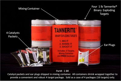

Commercial Tannerite pack, containing the oxidizer and the fuel.
Tannerite is the brand name of a binary explosive, made from ammonium nitrate (oxidizer) and aluminium powder (fuel), that is supplied as two separate powders that are mixed and shaken to produce an explosive.
