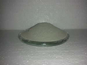

Portland cement is the most common type of cement in general use around the world, used as a basic ingredient of most construction materials, such as concrete or mortar. It can also be used as a desiccant, though its effectiveness varies.

Portland cement is a white-gray to slight bluish-gray solid fine powder. It is insoluble in water and all solvents, but will react with the former to form a very hard solid mass. It has an average density of 1.506 g/cm3[1], with a specific or (relative) density of 3.15[2].
