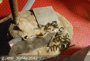

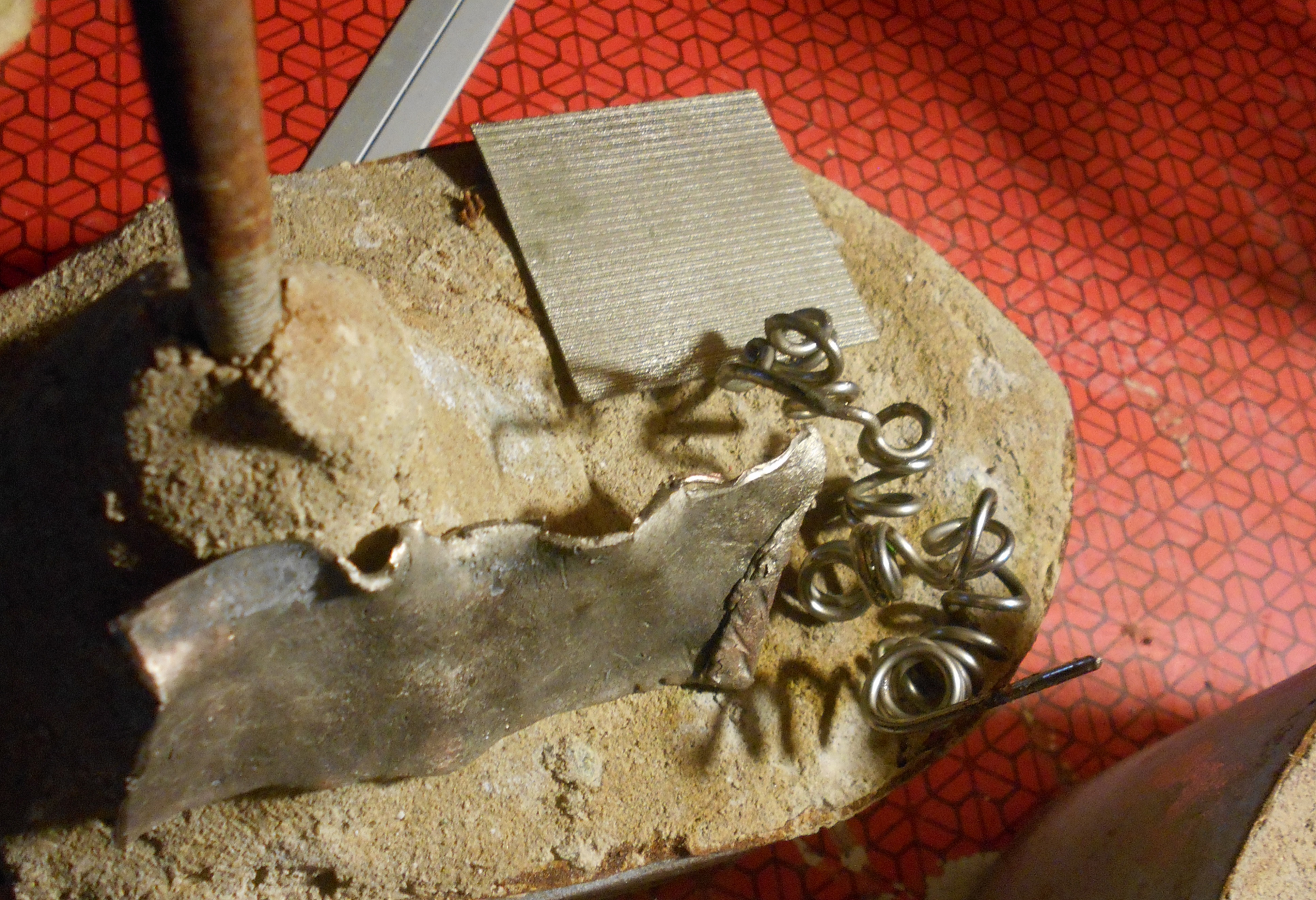

That is what I thought as well. Thanks! However are you sure that the Cl- anion gets oxidized ? Nickel is easier to oxidize ( Cl reduction potential is 1.36 V while Ni's is -0.23V).
I tried with HCL and a nickel anode yesterday, the logic being that the H+ ions would neutralize the cathodic OH-s and they did :). The nickel anode corroded nicely and filled the beaker with nice nickel cations. They plated well on lead, copper and graphite. I used about 6 V and 6 amps. On copper it appears very bright and shiny.
Way faster method to make nickel chloride as well, for comparison I heated some nickel in the same HCL for more than a day and almost no oxidation.
Nickel plating.jpg - 2.4MB
