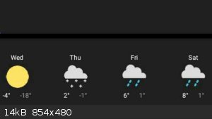

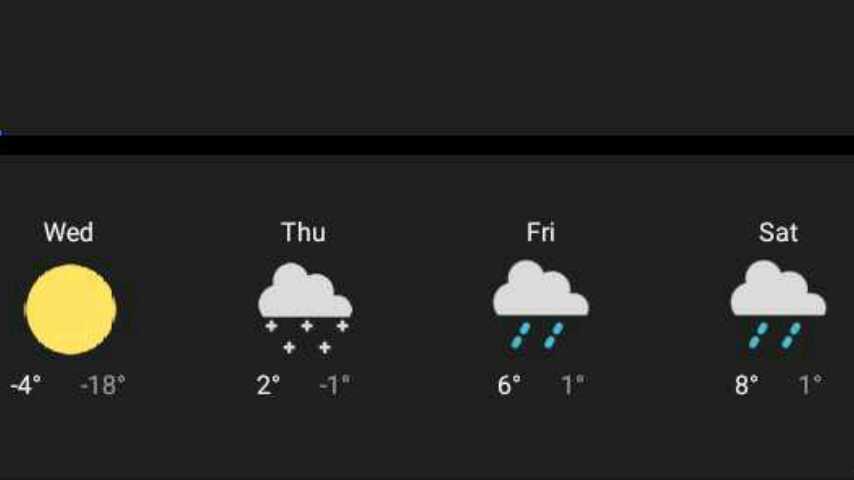

[*] posted on 28-2-2018 at 09:18
They probably relied on fact that dry chemicals don't react. But that's close to dangerous. Somebody may drop a drop of water in container accidentally...boom! But hydrochloric acid is not far from that considering safety. Nor are other acids, peroxide... Temperature here is -20 tonight, worst night in a year. Tommorow and onwards it won't drop below zero even during night. So hopefully I'll live.
weather.jpg - 14kB
[Edited on 28-2-2018 by RawWork]
