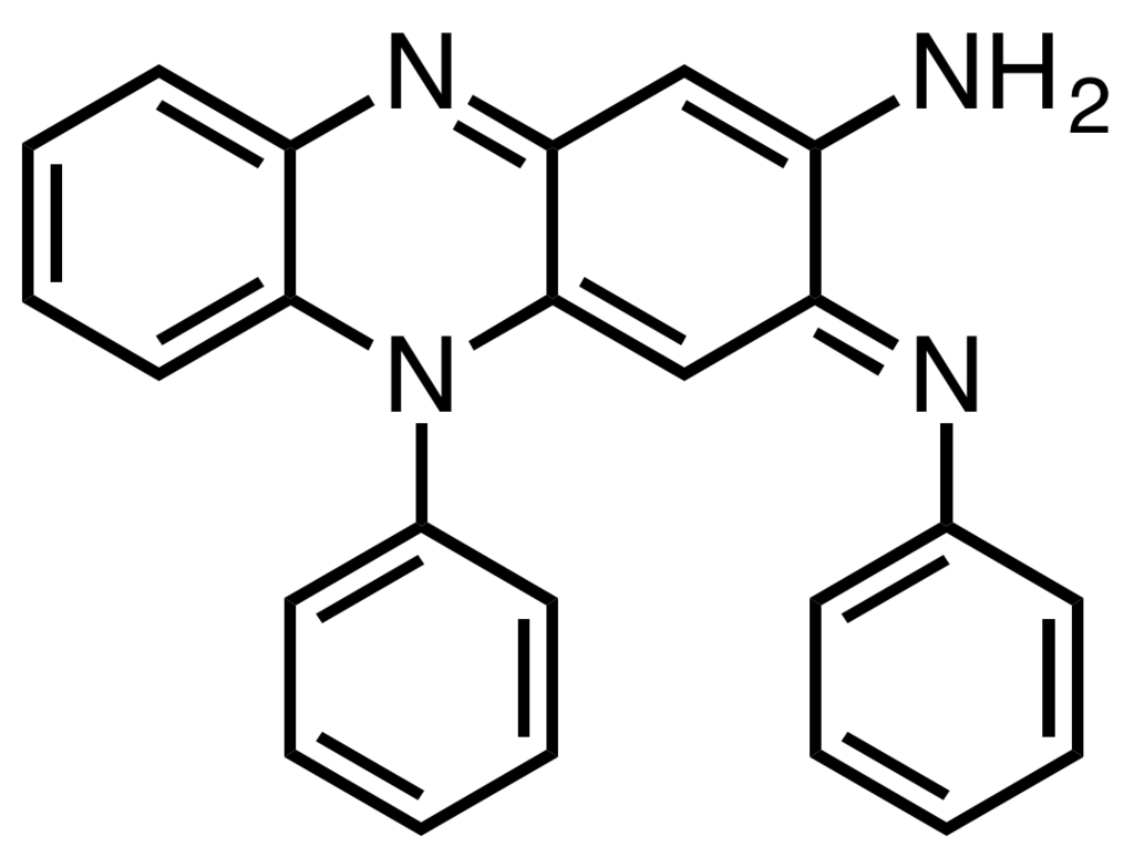

I wish I could say this with more specificity, but I'm pretty sure what happened is you oxidized the aniline to a Dye of the Induline Class. Check out this wiki page https://en.wikipedia.org/wiki/"Induline Induline is a dye of blue, bluish-red or black shades.[1] Induline consists of a mixture of several intensely colored species, so the name is often indulines"
The Indulines are usually hard to seperate from each other, and don't make the greatest dyes, therefore were never of commercial importance, like Rosaniline, Muave, etc. There's also alot of indulines so its hard to pinpoint the ones you likely made.
I believe you made aniline nitrate with the 50% HNO3, but when you added the WFNA, it oxidized the aniline instead to an induline. (See the attached picture of induline.. its basically a ton of anilines attached). Also in my experience indulines often start blue but then turn red.
Rhod love ur vidoes brotha!
-Nick
