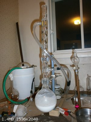

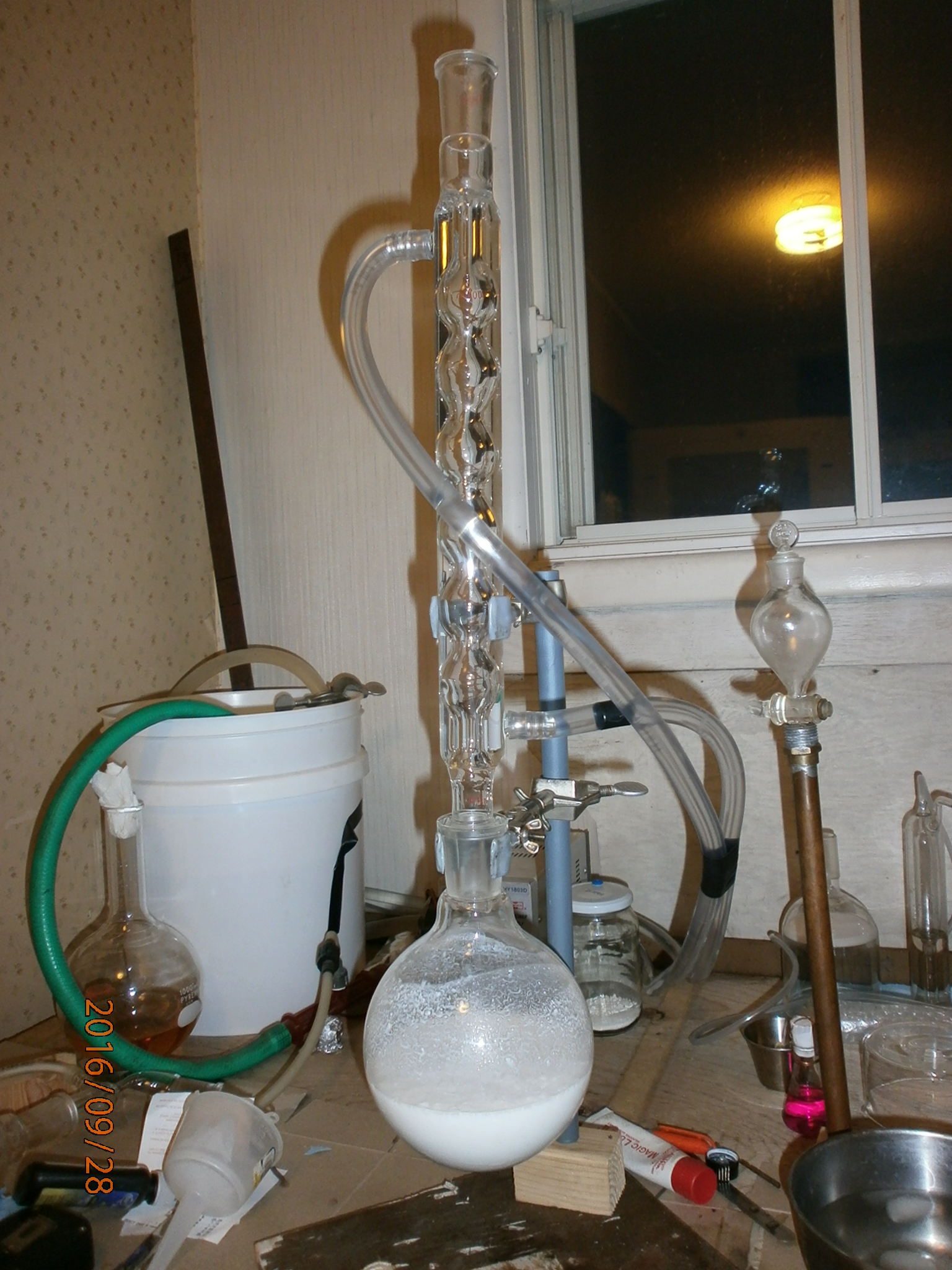

Yes, it will boil the Chloroform off, quickly.
Actually, I have a video in which I do exactly that, here: https://www.youtube.com/watch?v=fFUzmINeZ0U
