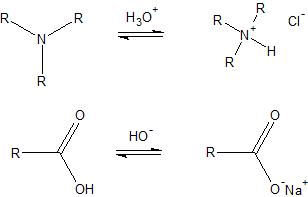

Organic amines will react with acids to form salts. Salts have quite different properties such as largely increased melting and boiling points, and
good solubility in water. These behaviors are both due to the structure of salts, shown below. Salts are ionic compounds due to the ionic bond
formed between the nitrogen and the counterion, hence the ionic behavior of salts such as high melting point etc.
