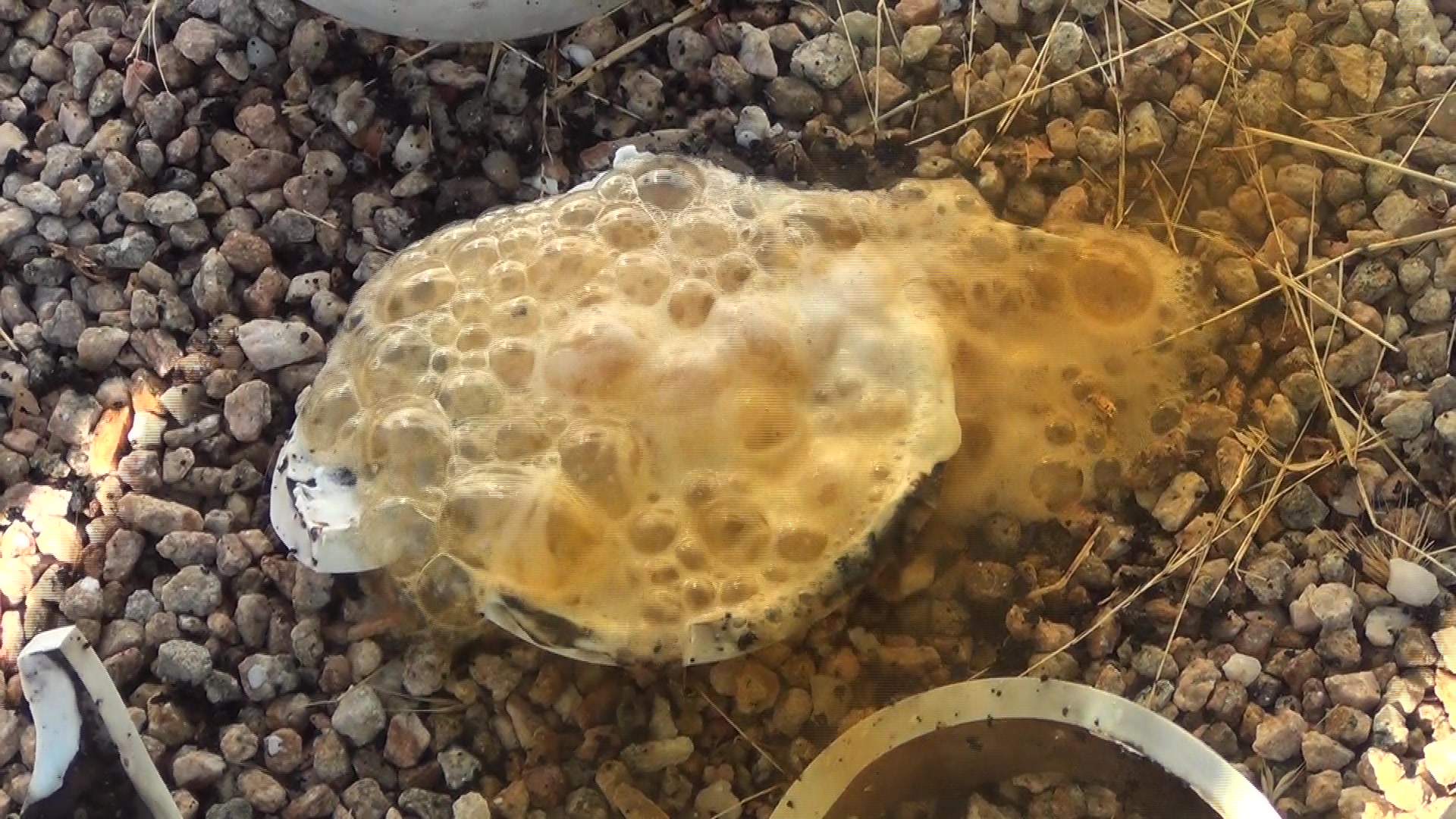

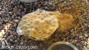

I had recently performed the "smoke bomb" reaction between Potassium Nitrate, and sugar. After the reaction had completed, a thick paste of
yellowish/white material covered the reaction vessel. I had read this was Potassium Carbonate, so I decided to try to neutralize it simply using
Hydrochloric Acid. Well, much to my surprise, lots of brown looking gas was evolved, and frankly, moved my butt away from that thing as quickly as I
could. Could anybody out there provide an explanation to what happened? ![:)](./images/smilies/smile.gif)
(Nitrogen Dioxide Perhaps?)

Here's a video, since I have the opportunity to provide you with one ![:)](./images/smilies/smile.gif)
http://tinypic.com/r/55p9js/8
Thanks for the replys!

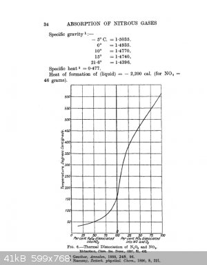

Most certainly NO2. However, it is a mixture of colorless dinitrogen tetroxide and nitrogen dioxide, which imparts the brownish color.
Zyklon-A
Posts: 1547
Registered: 26-11-2013
Mood: Fluorine radical
Are you sure N2O4 is colorless?

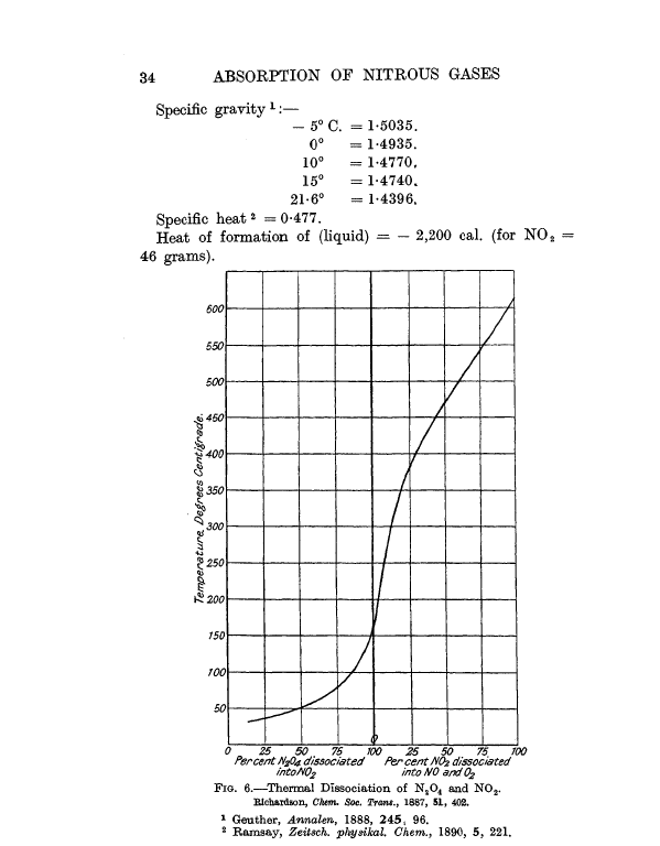

Per Absorption of Nitrous Gases:
![Capture.PNG - 41kB](http://www.sciencemadness.org/talk/files.php?pid=339109&aid=32635)
Which states that at 30°, only ~ 12% N2O4 dissociates into NO2. So, perhaps N2O4 exhibits
color as well?
I guess you're probably right, ~12% is likely enough to produce the color, we see at STP.
[Edited on 21-7-2014 by Zyklon-A]
