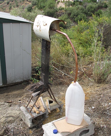

Spurred on by Oxirane's attempt, i had a go at PVC pyrolysis today, using a 1L paint thinners tin, a rocket stove, and some copper pipe.
37.8g of PVC-B was cut from a PVC drainpipe coupler and put in the tin.
The outlet of the tin was taken via about 1m of 15mm dia copper pipe into exactly 1L of distilled water. The end of the pipe was underwater.
After 20mins, bubbles were seen leaving the pipe.
It was allowed to run for 1hr 30 mins.
The water is now rather acidic, turning UI paper red instantly.
A quick distillation of 200ml of the water gave a distillate at 95.5 C for 10 minutes.
The liquid left in the pot is still acidic, the distillate is neutral.
The distillate smells slightly sweet, but does not burn.
I was expecting gaseous HCl to be present, so had some damp UI paper in front of the vac adapter, but it remained neutral.
Allowing +/- 1 C around 95.5, that gives two azeotropes most likely:-
anisole / water (95.5 C) however insoluble in water ...
chloral / water (95.0 C)
Mightliy confusled.
[Edited on 29-9-2014 by aga]
The Acidity is around 0.08 [M] after a rough titration, and an even rougher Mohr's shows chlorides present.
Aga:
Careful about suck back with that set up: water sucked back into the pyrolyser retort (the paint can, LOL) could be nasty (steam explosion). At a very
minimum always get the tube out of the water before switching off the heat!
Assuming the 0.08 M to be correct, calculate how much of the PVC's chlorine ended up in the water as HCl. Did the water smell of anything?
If the pyrolyser is hot enough, organics should also come over and form a two layer system (but some will be gaseous). But if temperature is too low
you might not be depolymerising the PVC just yet. The higher the temperature the jollier, within reason.
What does the PVC look like now?
Any idea of temperature inside the pyrolyser pot?
'Cracking' the backbone of this polymer requires fairly high temperatures, if you want it to proceed reasonably fast. The backbone is after all
-C-C-C-C-C-C-, so highly stable. All these stable C-C covalent bonds...
[Edited on 29-9-2014 by blogfast25]
