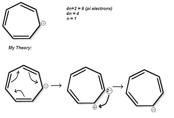

My doubt is something simple I guess, about the aromatic compounds. We learned the Huckel rule (4n + 2), and that there should be space for the
electrons to move (i.e. sp3 and sp1 carbons are "blockers"). But what about extra electrons in the cyclic structure?
One example on the attachment (If someone knows this ion name please tell me, I've no clue about organic ions nomenclature).
I think its an aromatic compound, but I'm not sure if those electrons can move the way I described in the sketch.
Thanks guys

the carbocation would be tropylium. about its aromaticity: the frost circle

That structure would not be aromatic, as it would have 8 pi electrons if the negatively charged carbon was sp2 hybridized. If planar, it would be
antiaromatic. I'd call this structure a cycloheptatrienyl anion.
Meanwhile, the cationic form is aromatic. The carbocation assumes sp2 hybridization, the ring has 6 pi electrons, and it has 7 resononance structures.

Just traveled here.. So when the pi bond came to the negative carbon, both the free electrons would be pi electrons?
That means it would be aromatic if I had a 9 carbons cyclic anion
with 4 pi bonds, right?
