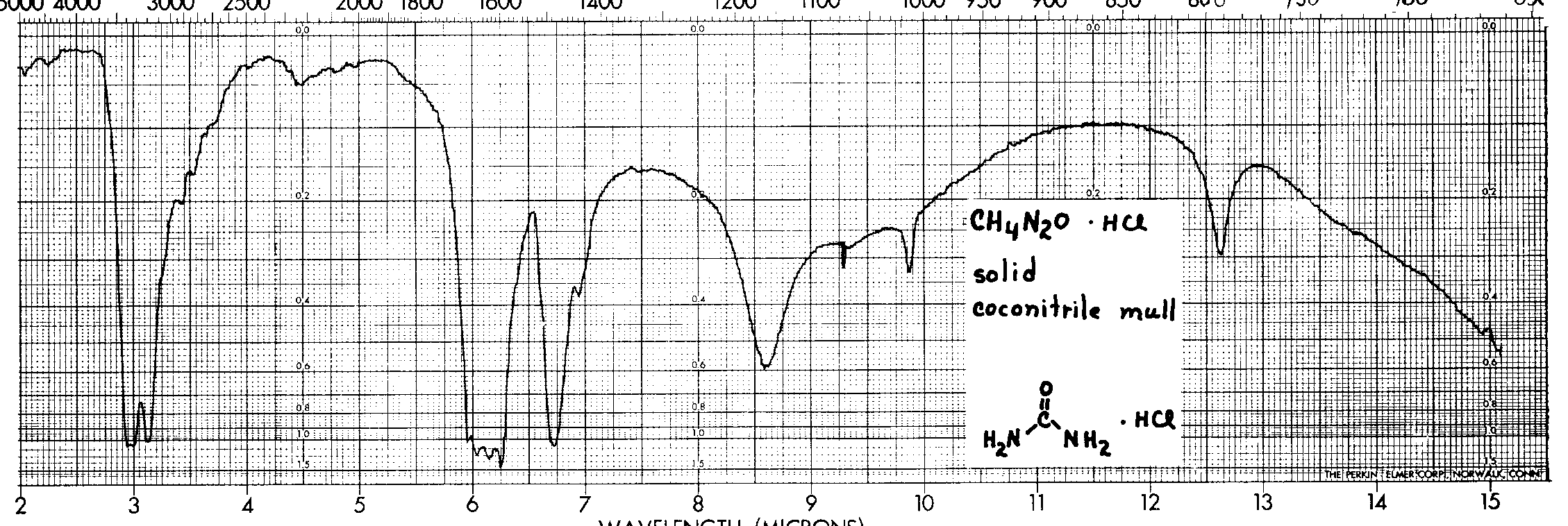

IR spectrum of urea hydrochloride as measured by Coblentz Society, Inc.
