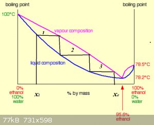

I did not calculate / determine that, but it is done by distilling a mixture of 2 solvents and determine the concentration of both in condensate:
http://www.phywe-es.com/index.php/fuseaction/download/lrn_fi...
Attachment: P3031501.pdf (531kB)
This file has been downloaded 282 times

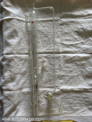

From my experience, 1 m long Hempel column with internal 30 mm diameter packed with glass Raschig rings and variable ratio reflux distillation head with ratio 10:1 produced very pure ethanol with only traces of methanol and ethylacetate. Starting material was crushed apples + water + cane sugar, first 2 simple distillations from bigger still (after 1st distillation 40 vol%, after 2nd 80 vol%) and final column distillation from 80 vol% ethanol to azeotrope. My friend Bedlasky performed gas chromatography, here for more:
Thank you. That is exactly what I have been searching for.

A meter of Raschig rings is some pretty serious gear. I'm not surprised you're getting such impressive results with that and a 10:1 reflux ratio.
Is that a jacketed column?
Posts: 1015
[*] posted on 19-5-2022 at 20:40
Hi SWIM, the column is not jacketed. Its price was something like 20 EUR, jacketed are much more expensive (more than 5 times). I insulated it by myself, although certainly not so good as vacuum jacket.

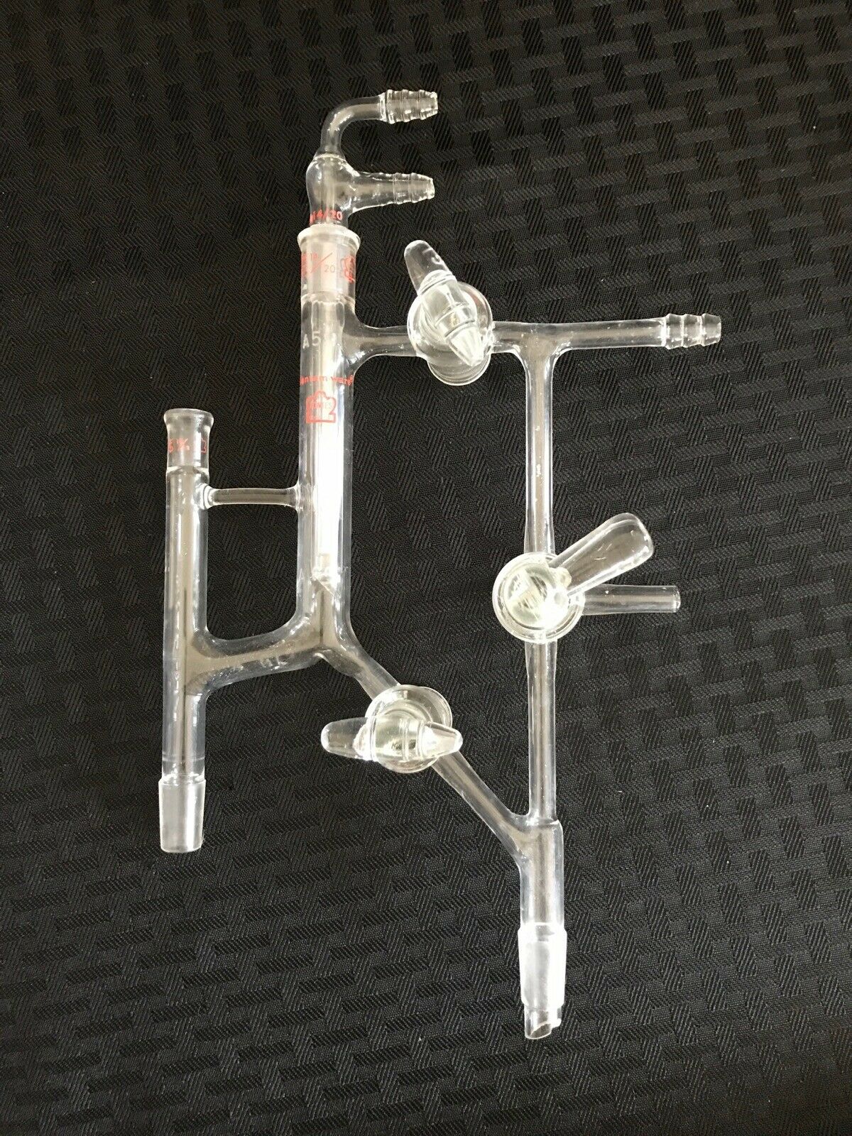

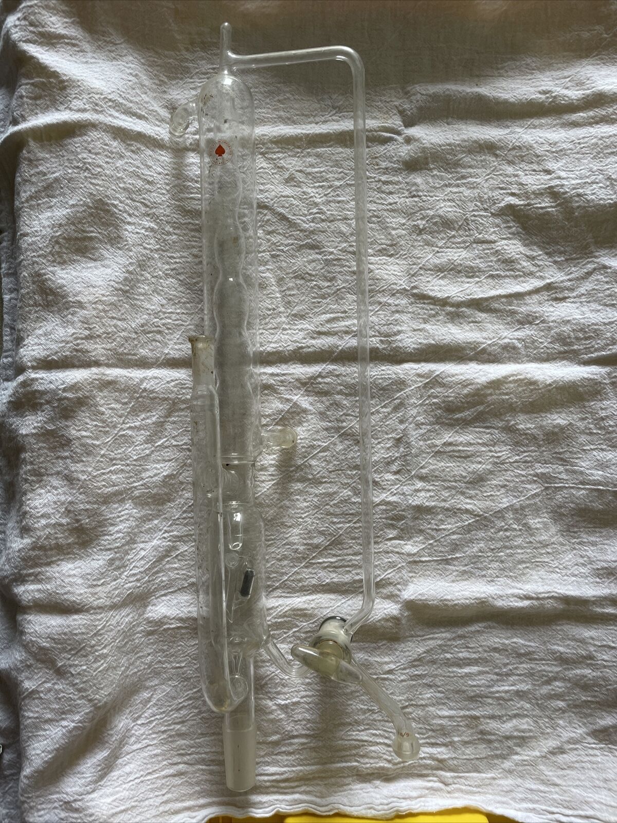

The thing about cooling the column is (partly) that it means there will be more condensate running down the lower half than the upper half and that means the top part of the column will have less reflux.
You cool just above the column and the whole column can be run at maximum reflux.
These partial takeoff heads cool the distillate and return to the column from the top. They can be set for total reflux while you get the power output right and then you open the collection valve to set the reflux ratio. They do a great job for almost any distillation except the really high-powered hard to do stuff.
They're also not too expensive used if you shop around for a while or go through Dr Bob, who usually has one or two up his sleeve.

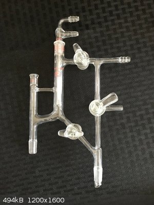

PTOhead.jpg - 494kB

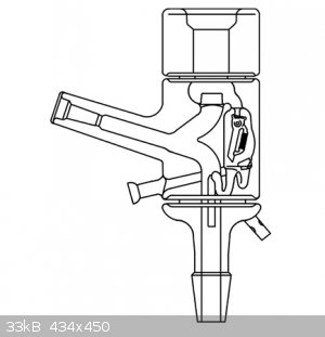

These Electromagnetic heads are for really high reflux ratios, and give a constant ratio regardless of vapor throughput rate.
They'll do ridiculous things like 60:1 reflux ratios, but there aren't too many things you'd need one of these for.
Maybe separating xylene isomers, or separating the constituents of (edit: add complex, difficult to separate) essential oils.
If you don't have dozens of theoretical plates you probably don't need one.
At least this is what I hear. Haven't had much experience with high-powered distillations yet.
Oh yeah, these need an electromagnet and timer to work.
emhead.jpg - 484kB

Very nice.
So the bottom valve is the reflux control
The top is a vacuum port
Not sure about the middle one. Looks like another gas port with a 3way directional valve.
Hopefully soon, I will be able to set up everything and post some data. Would like to compare notes and see if this idea can compete with professional apparatus.
Posts: 1015
[*] posted on 21-5-2022 at 02:46
middle valve is used to detach receiving flask during distillation and replace the flask with new one (without interrupting the distillation either the vacuum in the distillation part)
Yes, that's it.
They do make ones without the extra valves for vacuum work, but the price is similar used so it's probably best to get one with the extra valves. They are much more common and really save trouble taking fractions under vacuum.

[*] posted on 10-12-2022 at 18:42

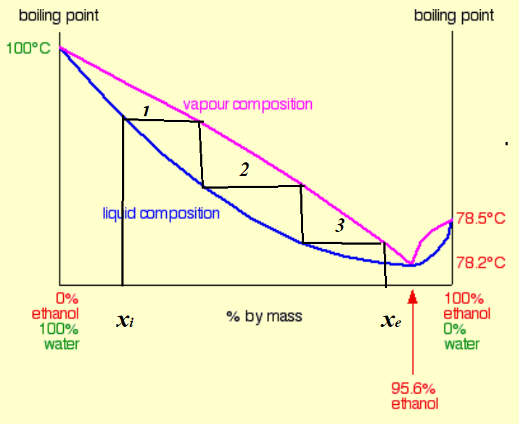

@RW:
You familiar with the concept of Number of Theoretical Plates?
Very nice study, BTW! Mi gusto mucho...
theor plates.png - 77kB
Distillation from xi (pot) to xe (distillate) in 3 theoretical plates (TP).
Obviously the higher the number of TP, the higher the separation power of a column/system.
[Edited on 11-12-2022 by blogfast25]
