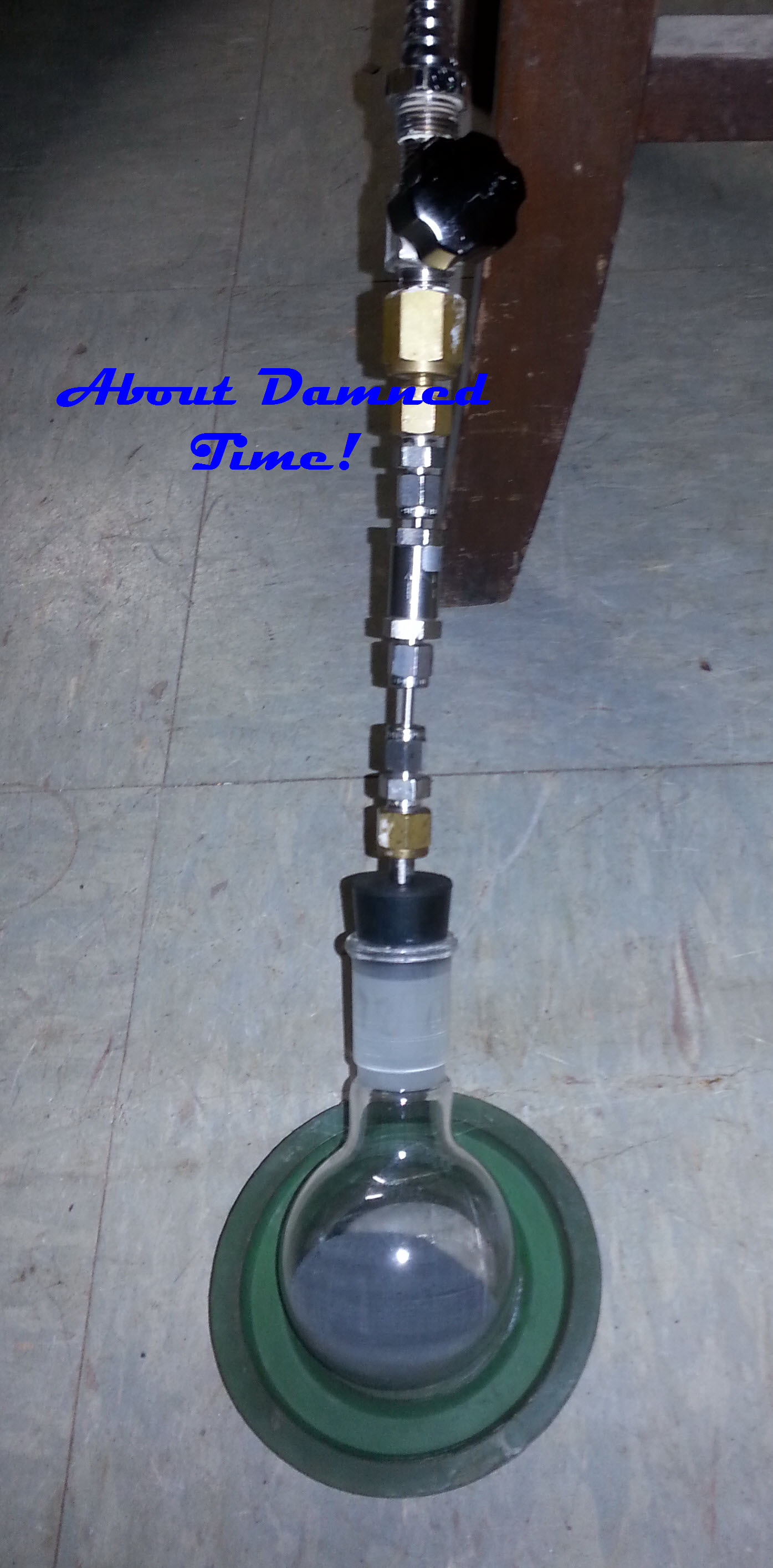

Congratulations Dan. This has been a monumental effort and your results have been hard-won.
Is it my imagination or is your holding of that jar a posture of triumph?

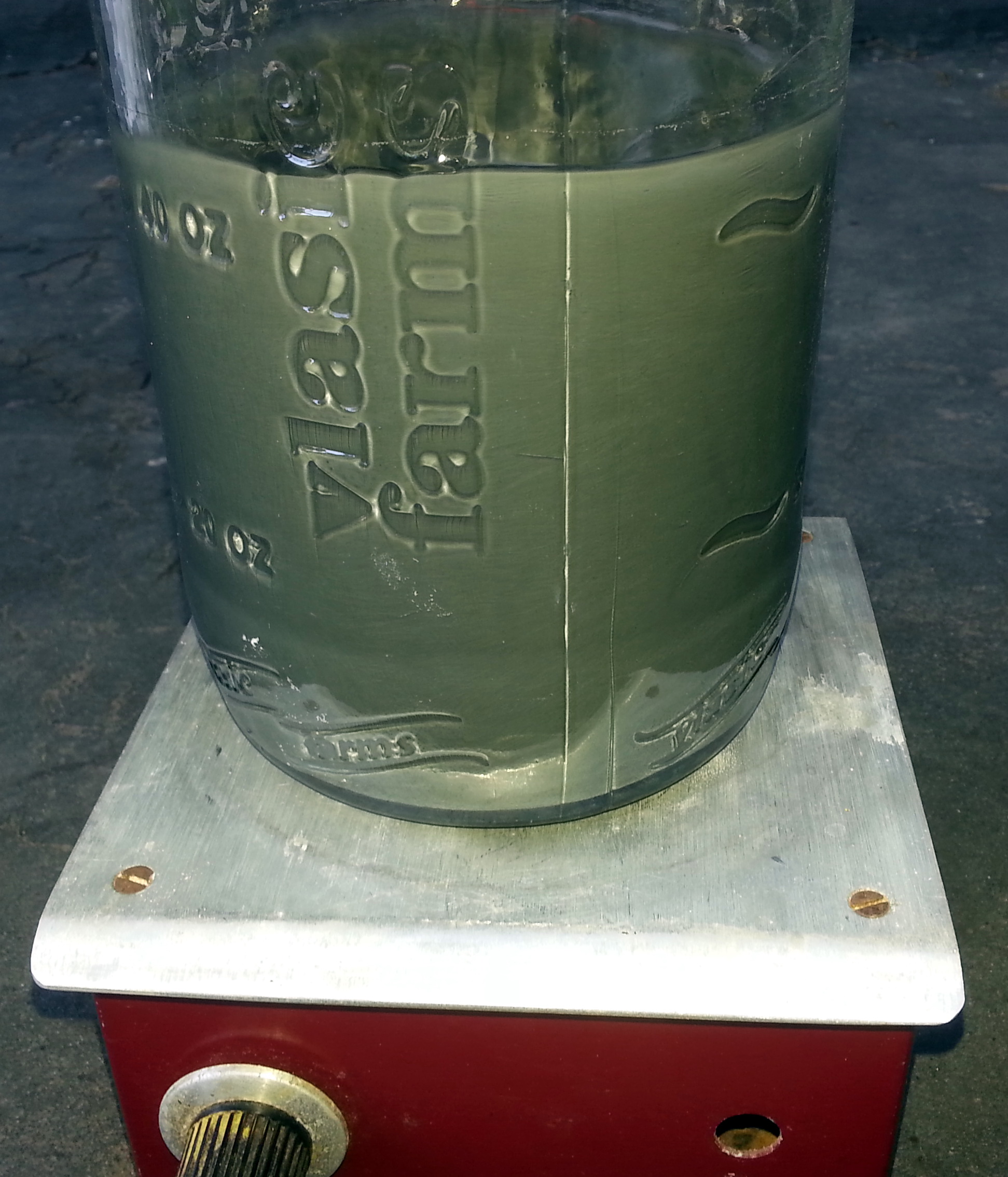

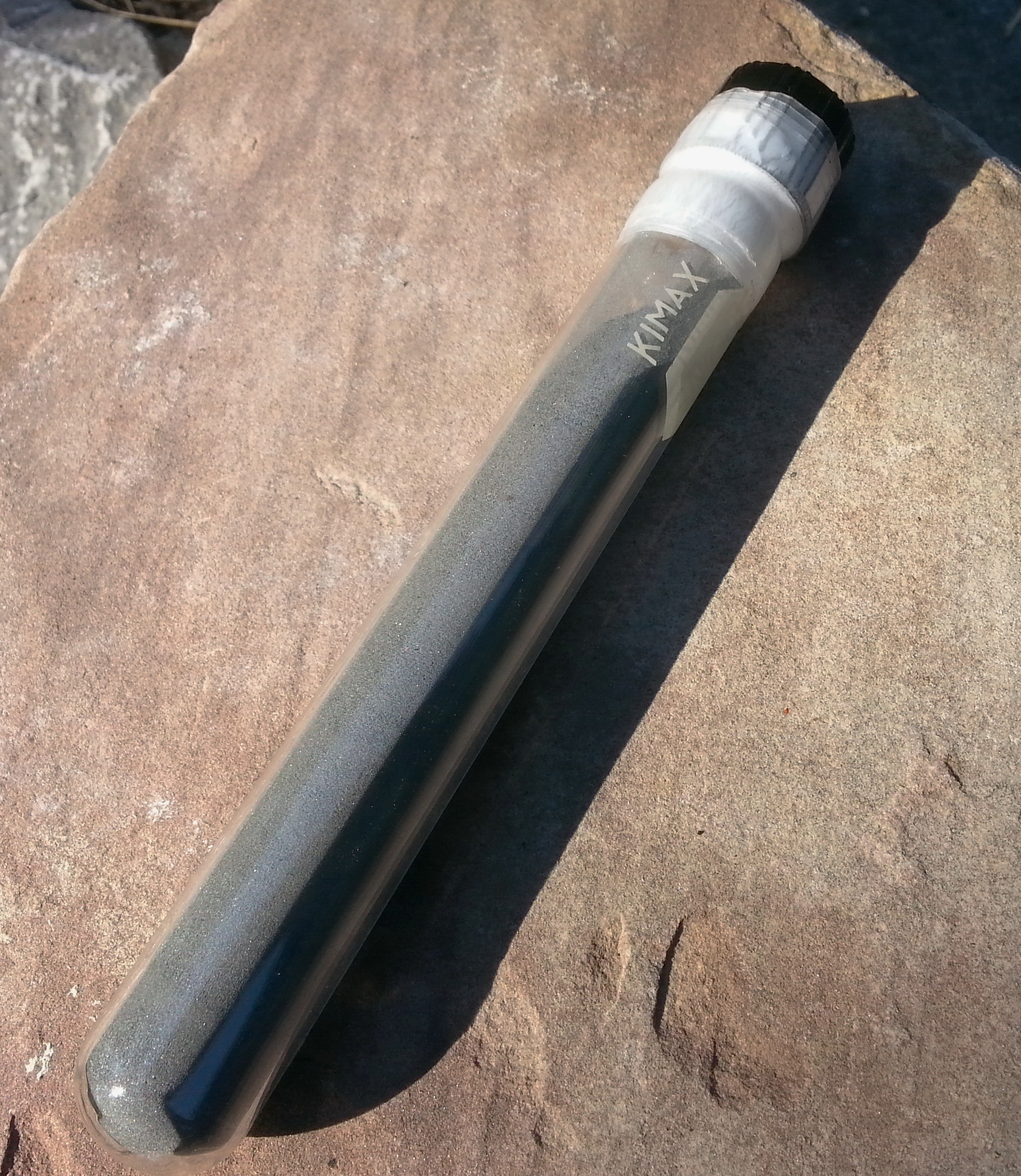

[*] posted on 1-8-2016 at 18:28
After 3 re-suspensions in 1.5 L distilled water (fines decanted off include calcium hydroxide and very fine thorium particles)....
On to dilute nitric acid washes.

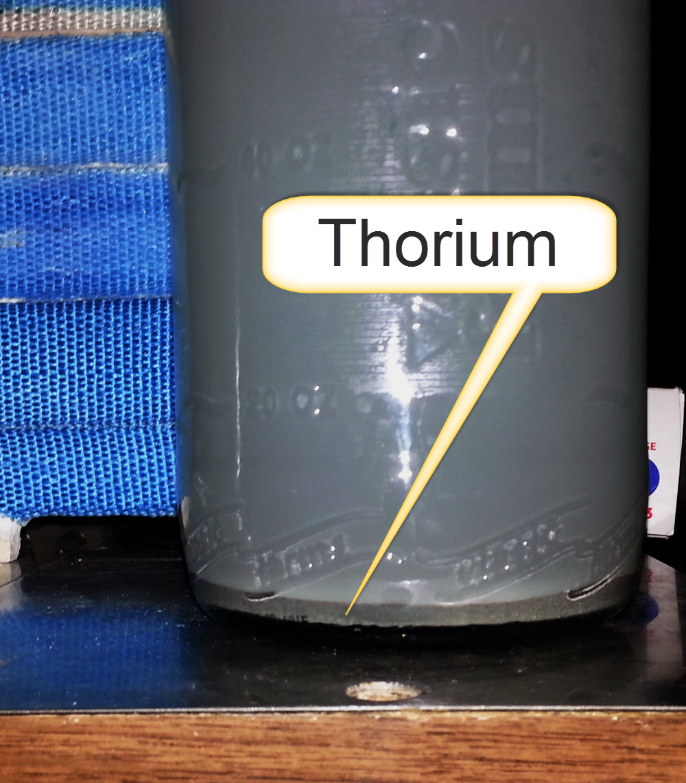

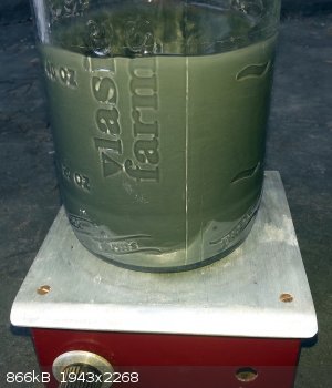

[*] posted on 2-8-2016 at 15:46
First wash with 1 L (Distilled H2O - HNO3) (8:1) shows a distinct darkening as residual Ca impurities are dissolved.

[*] posted on 3-8-2016 at 15:54
Subsequent washes, washing time, settling time before decantation
1.0 L DI H20 3 hours 10 min.
1.0 L (DI H2O - HNO3) (8:1) 8 hours 10 min.
6 x 1.0 L DI H2O 1 hour 5 minutes
Settling: https://www.dropbox.com/s/4khwojlye381a80/2016-08-03%2019.34...
Attached pics show final supernatant H2O and comparison of pH of this liquid and the virgin DI H2O. I can't see a difference. Final washes and drying tomorrow.

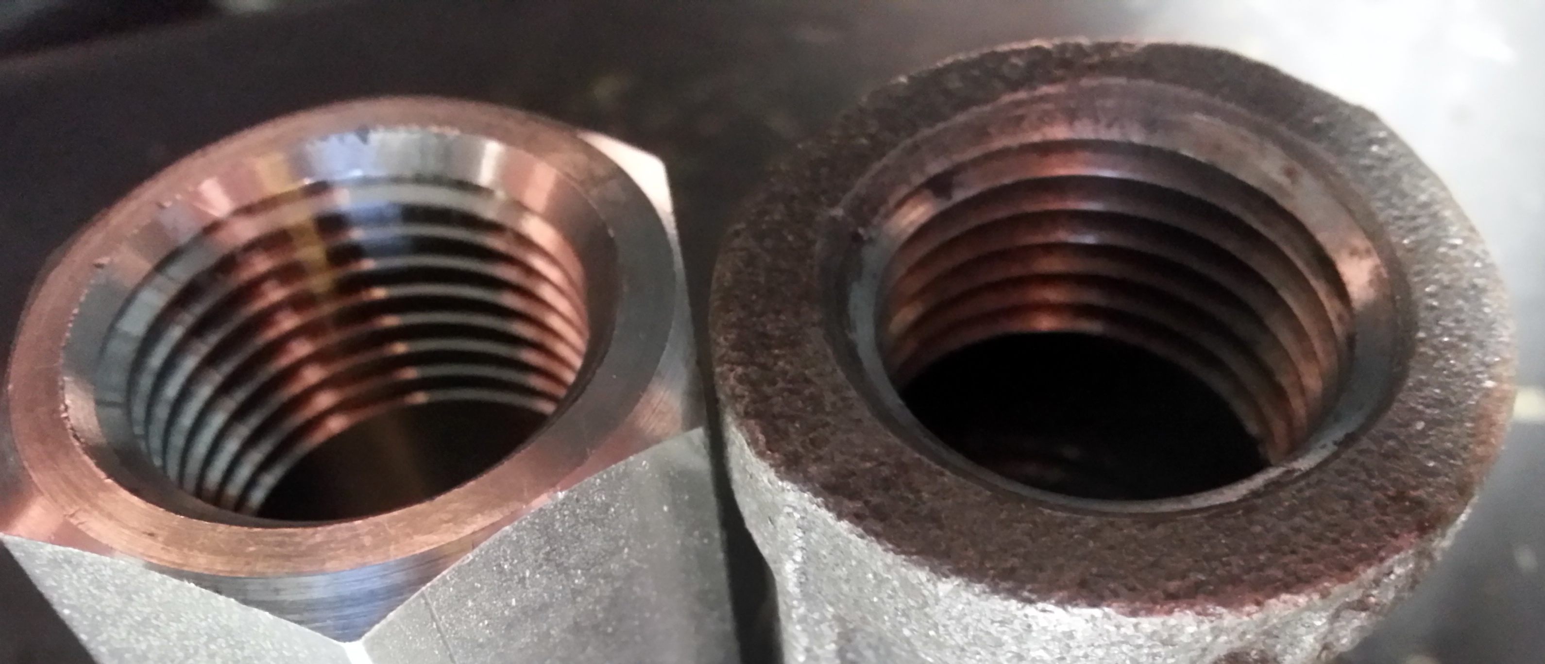

Very nice work on such a challenging project.
1. What are machine cut NPT threads? Is this something you did or did you hire this out? In my experience it is next to impossible to get NPT threads gas tight. Why did you choose NPT? Wouldn't some type of fine thread be easier to seal. But since your reactor is vented anyway maybe this makes no difference?
2. What has been your experience with pin-hole leaks in stainless steel? Is this a common experience with 0.125" wall steel? Especially under low pressure (5" Hg).
Threads can be rolled between flat dies (exterior ones, anyway) or cut by taps and dies. For example, nearly all machine bolts are rolled, not cut. Threads show so much variation. The ones I used were visually perfect, smooth, deep and sharp. NPT was designed to be gas or water tight when used with a thread sealant. The main valve of gas cylinders are always NPT, connections to regulators are 1/4" NPT, etc. The trick is holding integrity at temperatures that decompose these sealants.
A fine NPT thread designed for 6000 PSI service is made but they weren't pursued on availability grounds. I wanted absolutely no leaks, that's why I hired a professional welder. The vessel was leak tested at 100 PSI under water and showed no leaks. But this reactor was being used at its limit and molten Ca/CaCl2 is aggressive. The 2.5 PSI pressure probably pushed the molten material along a weak spot, grain boundary, partial pinhole or whatever. As it emerged it hardened as CaO limiting further leakage. Maybe. Or maybe it had just started as the reaction finished. Hard to say. The nickel/graphite sealant performed well. Notice how clean the end of the threads are, the atmosphere was argon with little or no oxygen.
I consider myself a moderately skilled welder. But, I COULD NOT weld a leak-free SS vessel. Despite grinding out bad spots and re-welding 4 or 5 times, leaks always persisted. When I told this to the professional welder he said that is not surprising at all. He said it is generally impossible to do with an AC stick welder.
Sometimes the leaks in my welds didn't appear until the interior pressure reached a couple atmospheres, but they ultimately always did.

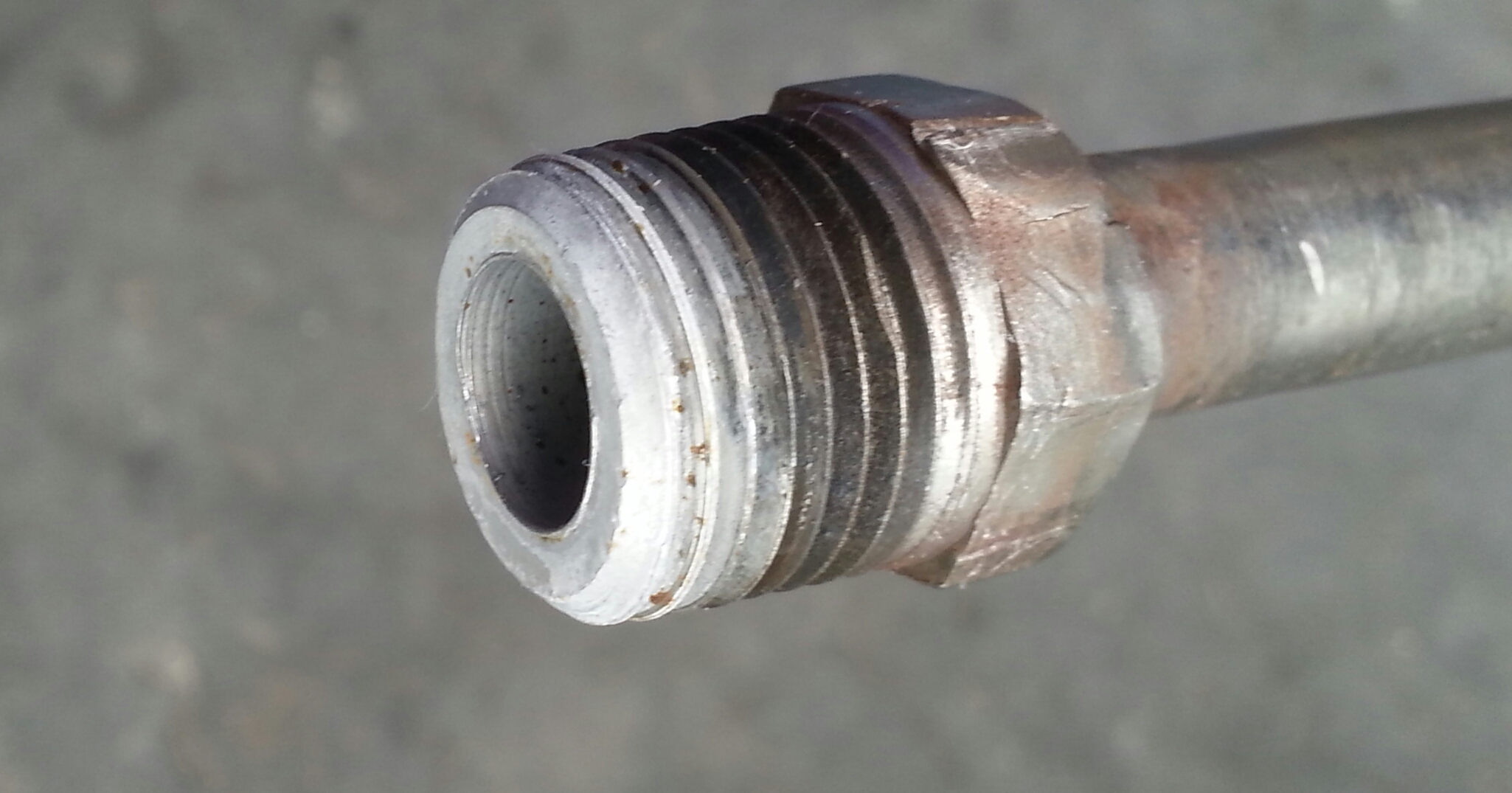

Congratulations, Dan! Great work in the engineering part in particular.
Do you plan to continue on a follow-up project of melting your Th into a single lump? (MP = 2023 K ​(1750 °C))
I supposed Machine Cut as opposed to Die Cut. However, on pg. 7 Dan mentions Precision Cut as opposed to Rolled. Wouldn't even consider using a rolled thread for a purpose like this, so yes. Rolled threads are good when it comes to mechanical strength, but not when it comes to precision fitting, as required in this case.
One thing I wonder about is why no copper flange gasket has been used instead of a precision thread, but probably the operating temperature is too close to the melting point of copper (1084.62 °C per Wiki).

[*] posted on 6-8-2016 at 18:56
Thanks Bezaleel.
Yes, you're right, Die-cut may be what the lower quality NPT threads are. I'm really no expert, but the threads on the LHS are visibly superior to those on the RHS.
The reason for not using flanges is as simple as cost. Precise flanges would require welds but then machining to eliminate warping caused by welding. Copper could have been usable at 950 C if thin stock was used.
There are so many things that COULD be done....
An inert-atmosphere furnace
Induction heating
Specialty crucibles like Mo (in inert atmospheres)
In any case, I think one metric by which we could say this was sufficiently protected is that the Th doesn't blacken in air readily. This usually signifies a purity in excess of 99%.
I cannot find an arc-furnace operator interested in contaminating his chamber with thorium. I obviously can melt it here, but not without destroying it in the process. That only leaves pressing as an option. That's a poor option with this powder, without real precision tooling, which I don't possess. Thus, the contamination possibility is unacceptable.
Threads.jpg - 787kB

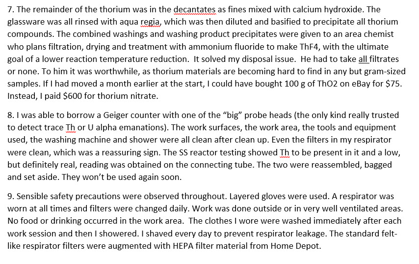

Interestingly, although Marie Curie witnessed the premature deaths of several workers in the nascent field of radioactivity, she never admitted that there was a direct connection. She never even acknowledged that there was a relationship between her work and her ultimately radiation-related (my words) death.

Thanks a lot for sharing the inspiring and captivating story of making this! I can't tell you how much I enjoyed reading about your meticulous planning, problems, solutions and final success with us. Looking at the history of the element, it appears likely that you are the very first -amateur- scientist in the world to isolate this metal in the last century (if not ever, depending on whether you count well-to-do victorians). There ought to be an olympic medal or noble price for amateur chemistry, but alas.
Is the cleaning effort purely precautionary or have you actually detected some contamination?
From the perspective of an interested element collector: are you planning to recover some of the cost by selling some of the metal? (or make a well-deserved profit, I don't care about the financial details, just if you are planning to sell samples of it)

[*] posted on 23-8-2016 at 20:11
No, I didn't. I kept 5 grams. Nobody will bother you for that. They just don't want private individuals selling it, I think most probably because it will be shipped improperly. But other factors come into play. Owners of "source material" may not abandon it. Ever. They must technically ship it in accordance with law to one of four long-term nuclear repositories and pay for disposal. This is the lowest level waste so all four sites accept it.
This law is obviously violated frequently. Dozens of us here have DU. A friend who was selling DU on eBay sent me this message:
I'd be very careful with selling this material on ebay. I'm not sure if I ever told you what happened to me when I was selling DU samples on ebay. A few years ago I was contacted through ebay from someone claiming to be from the MA department of public health radiation control program. They told me to cease all sales of DU. It was very unprofessional and I shrugged it off as someone harassing me on ebay. A few weeks later I got letter in the mail from the same place. It was a cease and desist letter stating that I had to delist all my DU samples. Apparently the NRC had saw them and tipped off the MA DPH radiation control. MA is an NRC agreement state which means they relinquish all regulatory requirements to the state. I took down my listings but they sent me another letter asking for the specs on my storage facility, leak testing, calibration data for my detection equipment, etc. I explained to them that I was just a private citizen at a residence and not a big company. They sent another letter saying that the matter was closed. It didn't end there though. About two months later I was paid a visit from two FBI agents! They started by saying that DU was some pretty serious stuff and asked what I was doing with it. I told them no, it's depleted you can't do much with it at all and I explained how I was selling small samples on ebay to collectors for educational purposes. They started asking me crazy questions like did I support terror, was I a member of isis, did I want to hurt US citizens. I swear it was like something from a movie! Long story short is that the MA DPH said that by selling DU on an online auction site, I can't guarantee that it will end up with someone properly licensed or properly stored. I never heard back from the FBI. They said they were just "checking up" on me because MA DPH was worried. I know ebay seller Hudaho was selling Th foil samples and he was harassed by ebay into taking them down as well. Anyway, just thought I'd warn you, I don't know what the laws are like in your state regarding stuff like that but I don't want anyone to have to go through what I went through. It was just so ridiculous and unbelievable! All over some tiny DU samples.
So, this arrived after the Th was done. I decided to try to do the most cooperative thing and that was get it out of my possession and keep everything within the legal boundaries.
Concerning an earlier question of thorough clean-up, here is part of the complete write-up. Since you can never say nothing is there (thickness of detector window deflects some alphas), it seemed prudent to re-paint the garage floor. What if a drop splashed that I didn't notice? I wet-mopped. The thing about alpha particles, you just need to immobilize trace amounts to make them safe. I didn't find floor areas above background levels but I'm not trained on the instrument. I used the most careful techniques that I could. I'm comfortable with it.
I can't see myself ever repeating this experiment because of the potential for official intervention. If they want to be unsympathetic, it can be a nasty gray area.
__6.jpg - 163kB
