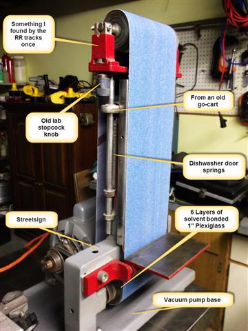

A former obsession supports the current. At one point I used to enjoy building machines from parts. I needed to cast metal parts, so I built an 1100 C
metal melting furnace out of some FeCrAl wire from two discarded space heaters and ceramic fiber board, etc. A cheap PID controller from eBay, a high
current SSR and a heatsink teamed with a K thermocouple completed the set-up.
I may make a hole through the furnace top to allqw the reactor to be connected to an external rod agitated by hand or an old air powered windshield
wiper motor from a truck. Like on a Kugelrohr.
The reactor is SS304, about 10% Ni. People often think that stainless steels, especially austenitic ones, are good choices for high-temperature work
and metal melting. Like the austenitic SS RA330, which resists scaling to 2100 C. RA330 has high Ni, like 35 to almost 40%, I think.. But the higher
the Ni, the worse the resistance to liquid metals. Molten calcium cracks RA330, but I believe I'm fine with SS304. So, I'll accept the exterior
scaling that occurs.
The belt sander, btw, will be used to powder Ca if it does so without grit contamination. That may be optimistic, so I may need to use a file.
Microscopic examination should tell.
All final chemicals were purchased last night, HNO3, Aq. NH3 and CaCl2 dihydrate USP grade.
![6 Inch belt sander (Small).JPG - 36kB](http://www.sciencemadness.org/talk/files.php?pid=326001&aid=30812)

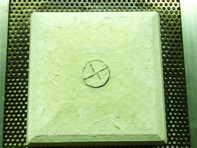

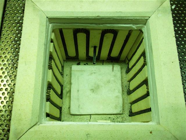

The other pics:
![Top of Furnace (Small).JPG - 91kB](http://www.sciencemadness.org/talk/files.php?pid=326002&aid=30814)
![75mL 304 SS (Small).JPG - 114kB](http://www.sciencemadness.org/talk/files.php?pid=326002&aid=30816)
The reactor has a 75 cc capacity. I'll put a hole in the furnace roof.
[Edited on 6-4-2014 by Dan Vizine]
