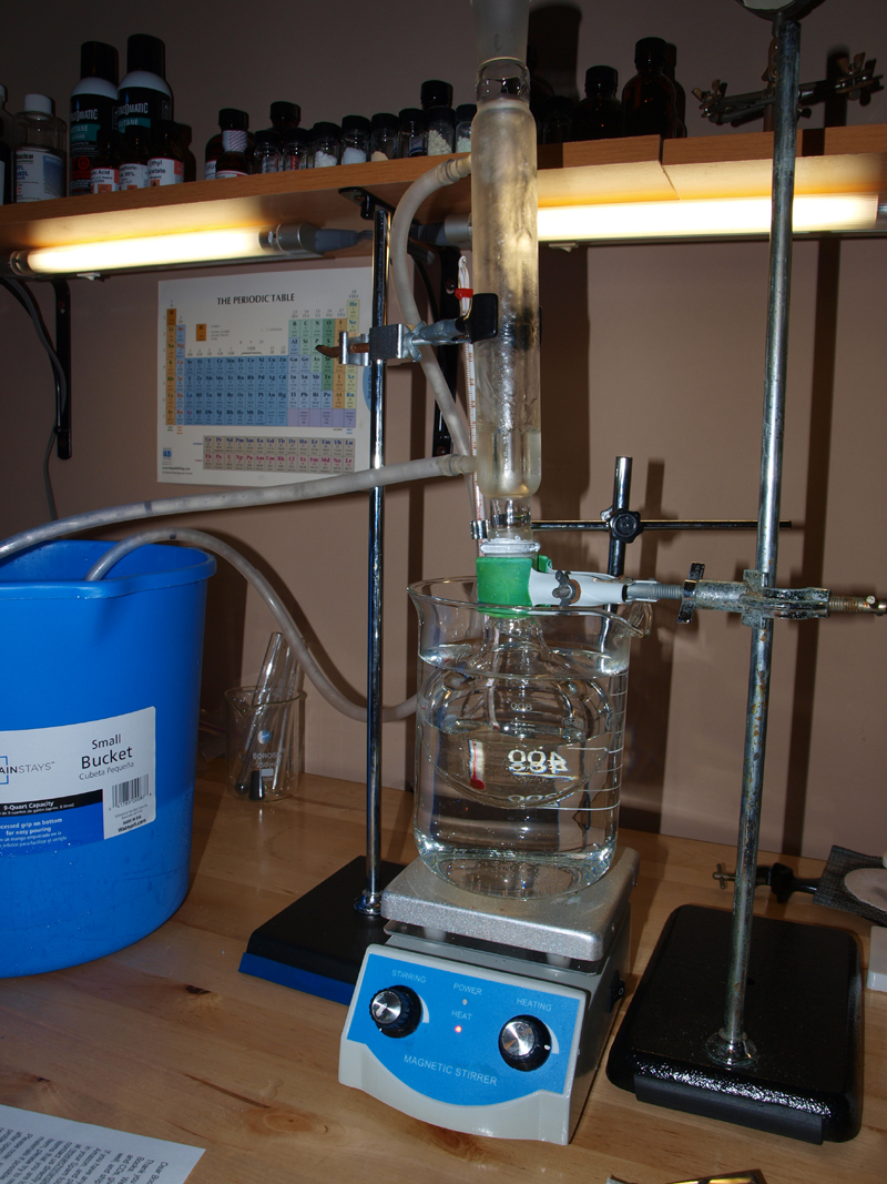

I set this one up with my new ground glass setup - a 250mL RBF in a hot water bath and a Liebig condenser connected to some cold water for the jacket.
Apparatus.jpg - 662kB

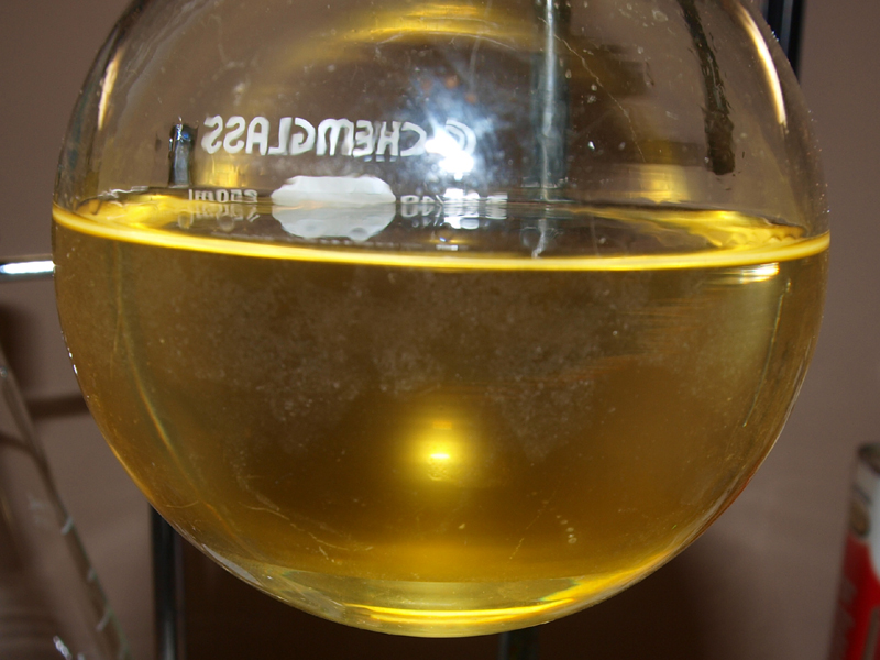

I ran this for 3 hours with the standard color change to yellow. The volume didn't change at all, so my condenser setup is working beautifully. However, when I stopped the reaction and took everything apart, the product only had one layer!
Product before Neutralization.jpg - 343kB
This was before neutralizing. Even after neutralizing there didn't appear to be any change. Actually I added the stoichiometric amount of base to neutralize it, but it was still acidic. I decided to leave it to see if it does anything overnight. Blogfast, have you ever seen anything like this in your trials? It seems my oil layer has disappeared, even though volume has not decreased. Maybe the large amounts I'm using require a longer time to settle into layers? I'll check again tomorrow.

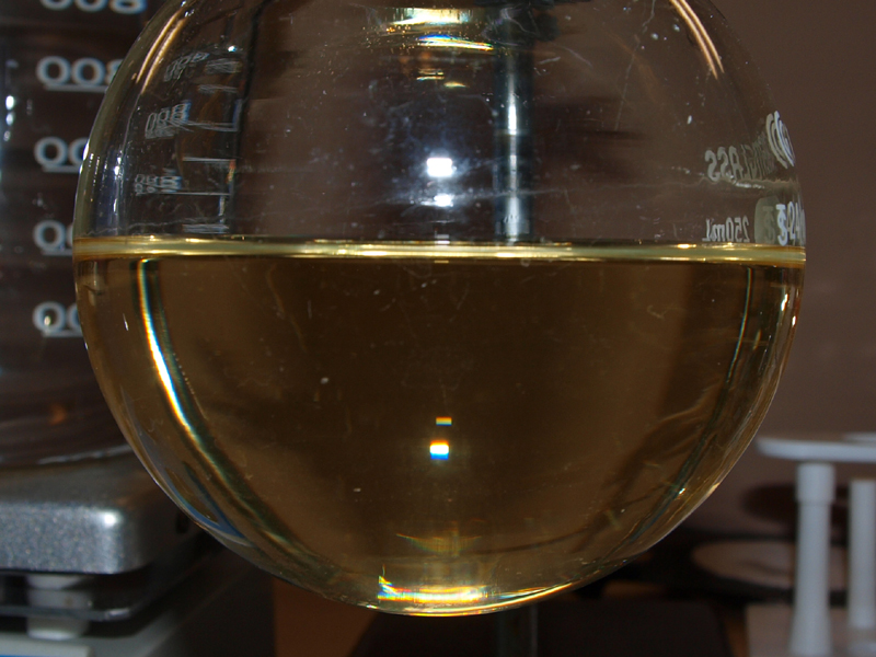

I neutralized my products tonight, and ended up having to use almost twice as much NaOH as I stoichiometrically should have. Ah well. The color changed a bit, becoming more of a cloudy yellow. A new phase has appeared at the bottom, which is the water from my NaOH solution. You can sort of see it in this picture.
Product After Neutralization.jpg - 329kB

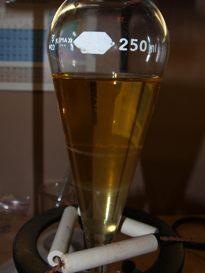

I decanted it off into a sep funnel (another of my new glassware pieces I was excited to use), and you can see the aqueous layer clearly on the bottom. The line in the middle isn't another layer, just some crap on the inside of the funnel that I can't get off until I get a proper bottle brush.
Layer Separation.jpg - 512kB

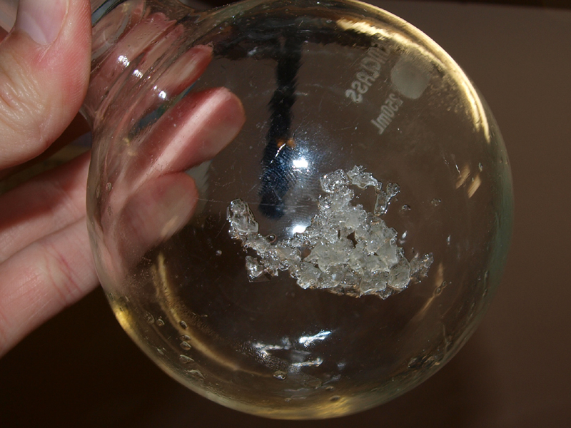

Today I replicated the observation, first with a glass test tube but that didn’t work too well because the turps don’t cling to glass much (surface tension). But using a small PP MC, I got the same phenomenon alright. And adding some water to the emptied MC, the red colour disappeared and a strong milkyness appeared, I’m sure it’s a suspension and not an emulsion. It’s been transferred to a test tube for possible decantation later on and maybe checking alcohol solubility or repeating the ‘Petenkoefer test’ (with fructose).
