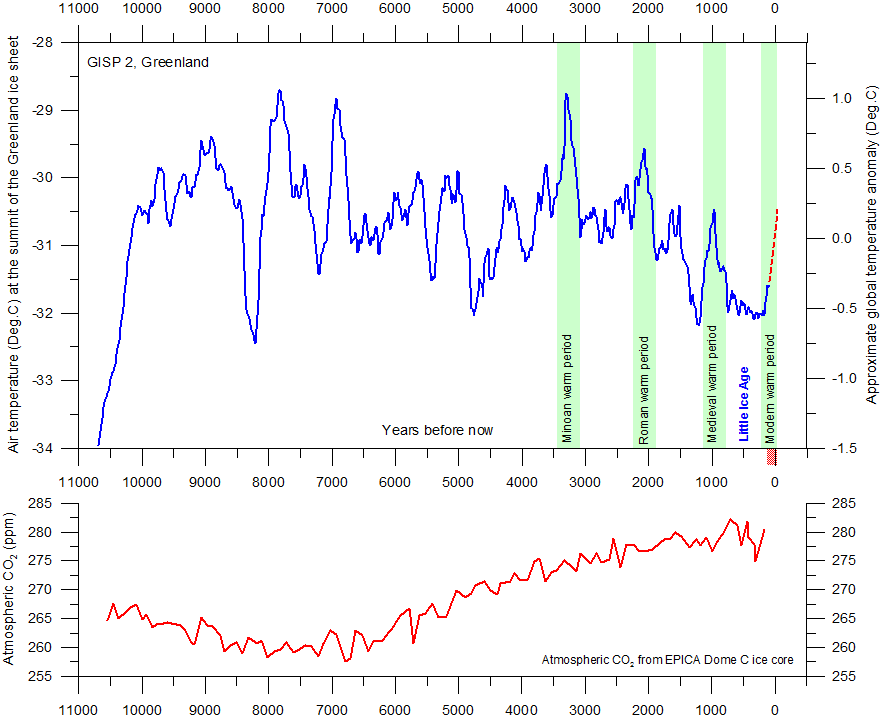

gisp220temperaturesince1070020bp20with20co220from20epica20domec1.gif - 45kB

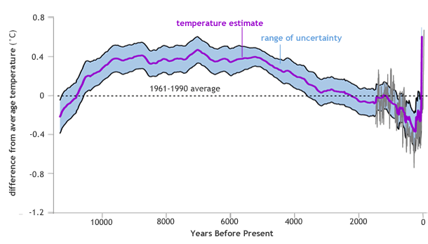

Official conclusion was made by cherry picking from available data, mostly based on medium-scale correlation, because large scale graph shows no correlation
https://medium.com/@ghornerhb/heres-a-better-graph-of-co2-an...
0 3Vm0copgT8K-pcRm.gif - 28kB
and the thousand years lag of CO2 level is barely visible on medium scale:
400000yearslarge1.gif - 45kB
Anthropogenic global warming due to increased greenhouse effect was predicted in the late 19th century on the basis of uncontroversial thermodynamics and radiation physics, long before there was any data to cherrypick.
That large scale graph also doesn't account for many other confounding factors that change over geologic time, but aren't responsible for current observations. Examples include changes in solar intensity or continental arrangement.

I'm talking not only about cherrypicking in long and medium range, but also in short range, once again the picture:
gisp220temperaturesince1070020bp20with20co220from20epica20domec1.gif - 29kB
shows no correlation, but if you pick the last 100 years only, you might find the correlation out of nothing. You can also pick another 100 years from the graph and find correlation there too, although it does not exists on the larger picture.

Dig further, using one of your own sources, and you find a great deal of other shenanigans lurking in this particular graph:
https://skepticalscience.com/crux-of-a-core3.html
Also, it uses temperature anomalies. Dang!

Okay, you got me, indeed, the temperature on that graph is a local Greenland temperature. Let's look at global graphs then:
marcott2-13_11k-graph-610.gif - 26kB
( data from http://dx.doi.org/10.1126/science.1228026 )
co2_10000_years.gif - 8kB
Are you happy with this correlation now?
That's only one of the problems mentioned, but yeah, it's a little better :)
