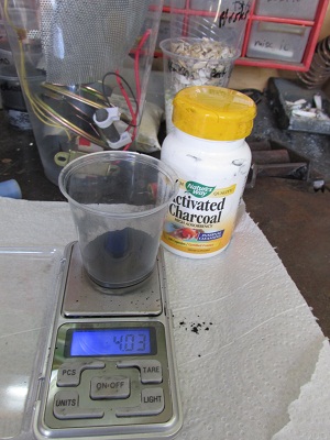

Today the recipe above was followed as closely as possible.
Measuring 0.3ml of PVA glue is pretty much impossible by volume (weight would be better). No PEG was available, so some car screenwash was added (it says -5 C n the bottle so there's some kind of antifreeze in it).
ac.JPG - 76kB

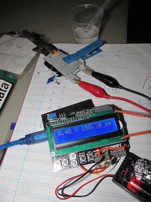

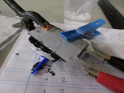

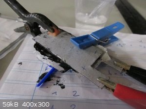

Two pieces of 1mm Al plate were cut to size/shape, some paste smeared on, then squashed/scraped with another piece of Al to get the layer as thin as possible.
A piece of paper from my notebook was put on top, wetted with a few drops of saturated NaCl solution, then the other Al plate put on top of that. The whole thing held together with clothes pegs.
cell.JPG - 59kB
The excess paper separator was left on so that more NaCl electrolyte could be added easily.
A few manual cycles of 30 secs charge, then discharge to tau took absolutely ages, so i altered the arduino program to make it automatically run the charge/discharge cycle and just print the result each time.

Been running for almost 2 hours to complete just 6 measurements !
testing.JPG - 82kB

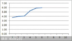

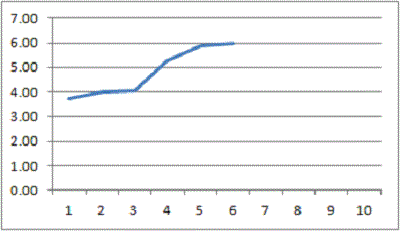

The graph shows the Farads (yes, Farad measurement) of the cell on the Y axis versus the 30-second charge-then-discharge cycle number on the X axis.
You read it right : 6 Farads so far, and climbing with each cycle.

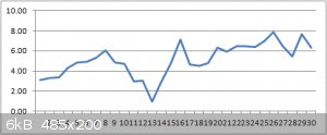

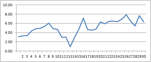

[*] posted on 31-12-2016 at 15:40

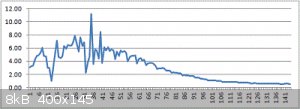

Over 30 charge/discharge cycles the graph looks like this :-
FvCycle30sec3.gif - 6kB
More electrolyte and an extra clothes peg added at cycle #13 (the bit where it dips a lot).

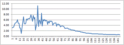

144 charge/discharge cycles.
Max: 11.2 Farad
Average : 3 Farad
FvCycle30sec4.gif - 8kB
Seems to be 'losing' electrolyte.
Might be the water evaporating, but where is the Salt going ?
