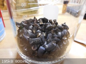

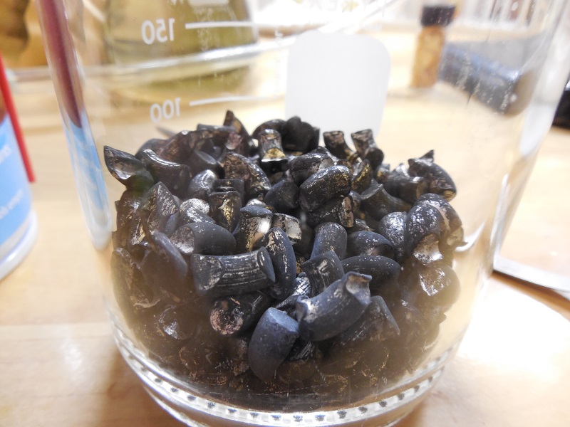

Here is my Li metal, stored under argon:
Li_under_Ar.jpg - 195kB
Small slugs, around 3/8" long. The plan will be to add NdF3 powder to the crucible first then a few of these on top. The Li will melt and cover the fluoride before reaction starts. I think my biggest concern at this point is the hot, molten lithium reacting with whatever crucible material I use. I currently have fused silica (no good), graphite (questionable), and stainless steel (slightly less questionable). I think it would also be a good idea to have a cover for whatever material I end up using, to help exclude air.

Nice metal (you couldn't teleport some over here, could you?)
But I was thinking of doing it the other way around: load lithium first, then fluoride, so the latter protects the metal somewhat, at least at first. Then when it melts reaction will start at some point. Argon blanket would of course be better. I'm thinking of a fairly simple design: crucible within a crucible for instance. A wide copper tube (shut off at one end), pump argon into it, load crucible into it and then load reagents into inner crucible. Lower assembly into furnace, maintaining low Ar flux into outer crucible...
