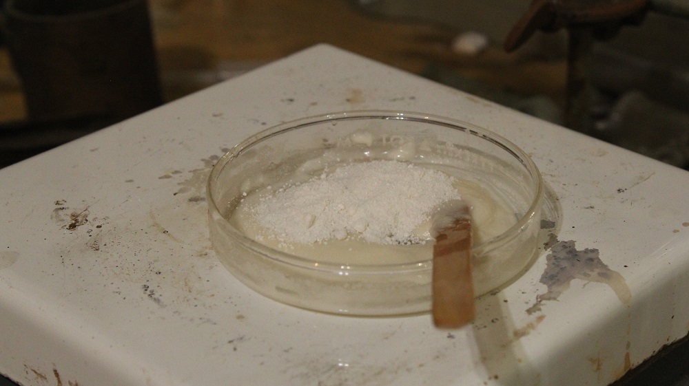

43.4 g (29 ml) HNO3 (75%-99%)
70.6 g L-Aspartic Acid (.53 mol @ 133.103 g/mol)
60 ml dH2O
60 ml dH2O was added to a beaker (@ rt ~30 C), water was stirred as 70.6 g Aspartic Acid was added.
Asp conglomerates in a somewhat insoluble, self-clinging, white mass at the bottom of beaker. It can be stirred into the slurry but it quickly settles
back to the bottom as a thick mass.
Nitric was added slowly. At 10ml addition of HNO3, the temperature of reaction increased 7 C and the mass concentration of aspartic acid changed as it
was converted to nitrate, dissolving into solution.
*60 ml H2O was probably too much H2O. two-thirds or even half is probably suitable, despite the insolubility of aspartic acid at first addition.
On complete addition of HNO3, temperature was 40 C. The reaction changed from thick and opaque to thin and clear like water within around 10 minutes.
The reaction was stirred ~15 minutes after complete addition of HNO3.
The viscosity of the finished nitrate product in this volume of water is a syrup, similar to mineral oil.
The finished product was poured out onto a pyrex pan and dried at 75 C.
I plan to test mp, castability, hygroscopicity, and perhaps some blasting in 1x1.5" pex as standalone and perhaps with some PETN and NQ. It is drying
now.
Please let me know if there is something youd be interested in testing in this material, and I will accomodate if in my ability. I originally planned
to compare to TNT, but I have run out and found I also have no toluene so if the material is good, I will direct compare to TNT and TNP later. This is
a small validation batch, so its limited to however much nitrate is made from 70 g Aspartic.

I've been playing with AspNO3 for the past day. Here are some findings...
Regarding AspNO3 itself:
This material is hygroscopic and water soluble. When dried, it is a semi-solid similar to a glassed soft-polymer like melted sucrose. It melts below
100 C as referenced in paper. In melt phase, it is thicker towards 100 C, perhaps like a melted sugar. It becomes thinner at higher temperatures like
melted butter.
I mistakenly used too much nitric acid because the concentration was unknown. During melt phase, a lot of what (I'm assuming) was excess HNO3/H2O was
vaporized into the air.
AspNO3 casts as a clear semi hard flat cast, similar to a soft epoxy. It is hygroscopic on the surface.
It is soluble in acetone, MeOH and IPA
Insoluble in nitromethane
It forms a milky solution and in acetone, falls out of solvent as a powder and when removed, quickly returns to goo. It possibly reacts with the
solvents changing its properties, like melting point and opacity.
Now the interesting part:
Melted AspNO3 plasticizes nitroguanidine. I cant tell you what the rate is, because I learned this in haphazard experimentation, not expecting it to
melt NQ. Not only does it melt NQ, it does so with impressive proportions of NQ. It seems endless. I stopped adding NQ because I simply didn't want to
use that much nitroguanidine stock.
The NQ is dissolving in AspNO3 presumably at or near max density. It is certainly the easiest way to achieve max density of NQ. Plasticized NQ is very
sticky while hot but cools in a few minutes to consistency remarkably similar to comp C4. It shapes and forms practically identically to C4 warmed to
body temperature. It has greater adhesive properties than C4, and easily bonds its surface to concrete, wood, metal and plastic. It can be molded into
shapes and can mold into thin sheets.
The NQ plastique has two components, the AspNO3 and the NQ plastique itself. The AspNO3 component appears to retain hygroscopicity at surface of
material and cast shape but the inner volume of material is unaffected. The NQ plastique can be exposed to water where the ASPNO3 in exposure to water
is dissolved, leaving the NQ at ultra high density which cures to a hard plastic like PVC. The plasticity of the NQ plastique (without additional
hydrophobic plasticizer) is moldable on exposure to atmospheric air for around 6 Hours. At 6 hours the plastic begins to set hard. I haven't tested if
it can be remelted yet.
FYI: Nitroguanidine has been underutilized due t its low density crystal form which really cant be overcome easily. High bulk density techniques are
used but are under performing. propyl nitroguanidine is another way to melt NQ but its not really feasible and I believe it loses some of the benefit
of NQ. The performance of NQ at high density is reported to be 8344 m/s Vd, 29GPa pressure @ 1.759 g/cc according to Koch.
![IMG_9744.JPG - 138kB](http://www.sciencemadness.org/talk/files.php?pid=685230&aid=98690)
[Edited on 27-6-2023 by Hey Buddy]
It's now been 9 hours since experimenting with the NQ plastique. It remelts after being rock hard like PVC. I would consider this material to be a
reversible thermo-curing NQ plastic. A sample was left in water over night. At first, the sample cured solid like a marble. Overnight the sample broke
apart and left presumably NQ at high density in the water. This may be a low-effort method of achieving high density NQ.
