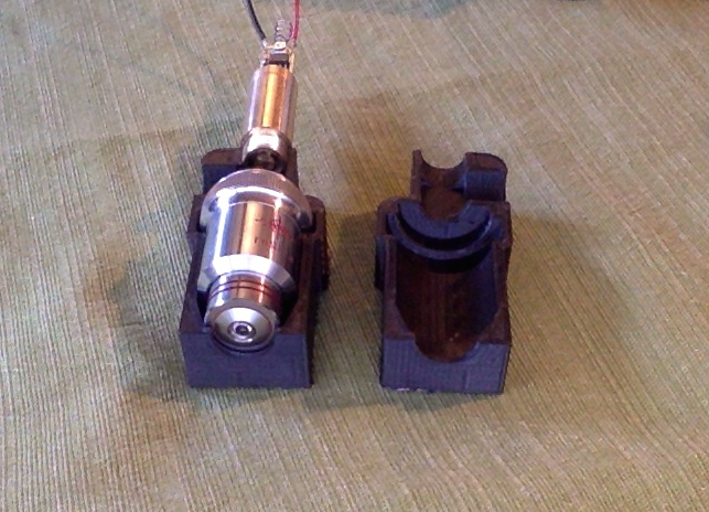

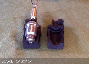

This part holds the laser, the 40x objective lens (cannibalized from a microscope), and the beamsplitter (which hasn't arrived yet).
