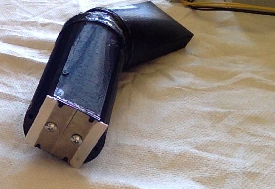

Update

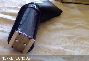

Work has been going slowly, but steadily (my time is split between this and the TEMPO project). After a bit of trouble with the 3D printer, I managed
to print all the parts for the spectroscope portion (I'll build this section before the Raman scattering one).
On another note, I learned not to trust sketchy $4.95 ATX power supplies from the surplus store. Of two I bought, one did nothing, and one made a
small explosion (a bad capacitor, I think).
![spectroscope.png - 407kB](http://www.sciencemadness.org/talk/files.php?pid=402891&aid=39423)

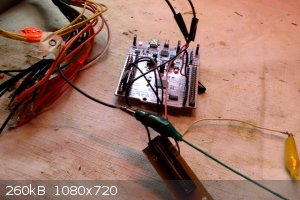

Metacelsus
Posts: 2537
Registered: 26-12-2012
Location: Boston, MA

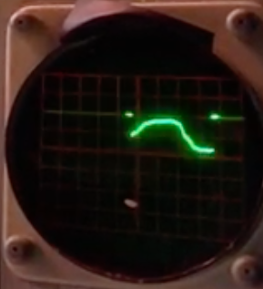

I got my CCD working with the Nucleo, finally! Spectra (and more details) are soon to come.
The oscilloscope picture is the CCD partially blocked with a finger.
(Pictures of oscilloscopes, or at least 1950-s era ones, apparently don't show up very well: an interesting effect of the speed of the eye being
slower than the speed of the camera.)
![ccd test readout.png - 101kB ccd test readout.png - 101kB](http://www.sciencemadness.org/talk/files.php?pid=405288&aid=40007)

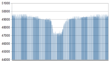

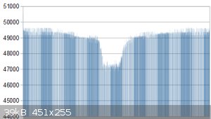

I've set up a program to save the CCD data on my computer; here is a preliminary example of the CCD being physically blocked.

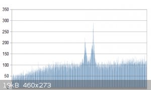

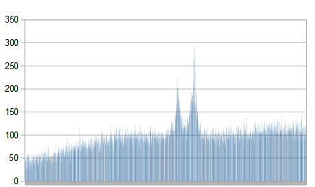

First Spectrum (not Raman, though)
This is of a red-orange laser diode:
Average of 8 scans, integration time 10 ms each. (I've found that more scans are better than longer integration times.)
I still need to calibrate the spectroscope to convert pixel number into wavelength, not to mention building the Raman scattering portion.
![spectrum.PNG - 19kB](http://www.sciencemadness.org/talk/files.php?pid=405914&aid=40216)
