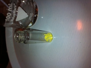

I made a very small quantity of Iodoform this evening following Woelens suggested steps.
1g KI dissolved in 5 ml of 10% HCL
added 7ml of 3% H2O2 (probably could have stopped after 5ml) the typical precipitate of iodine crystals formed, allowed these to settle 5 mins and
decanted. rinsed with water.
Added 8ml water followed by 8ml Acetone, and agitated test tube 1 minute.
Added NaOH dropwise (exact quantity not measured but solution used was 1M) until the solution turned bright yellow with quickly precipitating
iodoform.
Allowed to settle, decanted. rinsed with DI water and filtered
In the vial shown, is the final product, havent weighed it yet as it is not completely dry.
***I took step by step pictures of my synth however they are too large to attach to the message board will convert at some point although they are pretty typical images***
[Edited on 27-5-2011 by Mailinmypocket]
Posts: 7982
This indeed is the right color of the product. Next time you can decrese the amount of acetone. Instead of 8 ml it is OK to use 2 ml. But using more
does not harm, it just uses up more acetone than is necessary.

Lastly, I might have gotten a small amount of iodoform on my skin (impure iodoform, made the bleach way). The rest of the day I felt a little dizzy.
an MSDS sheet said that it can be easily absorbed through the skin, is it possible that was the reason I was dizzy?

I doubt it was from Iodoform on your skin. Iodoform was used as an antispetic applied to open wounds.
It was probably CH2ClI or some other compound like that. These compounds are likely to be very toxic and probably is able to be absorbed through skin

Thank you for your time woelen, I appreciate it. Me and mewrox99 both felt a dizzy and anesthesiated feeling on exposure to the impure iodoform. Do
you think this is likely from the CHI2Cl and CHICl2 impurities we produced?

Posts: 7982
I know that CHI3 itself does not induce a strong reaction, unless a lot of this is inhaled. In the past it was used as antiseptic and the people
treated with this almost certainly did not have such strong adverse effects.
So, I think that indeed the other mixed halogen compounds cause the dizziness.
