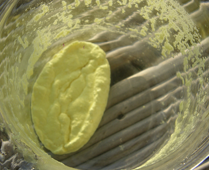

[*] posted on 21-5-2011 at 21:47
Just tried the synth.
Worked great, will upload a yt video later
Here is my product:
CHI3.png - 1.3MB
Has a real strong nasty mothball sorta odour and gave me a slight headache
Disposed of it by heat to decomposition, small batches at a time
[Edited on 22-5-2011 by mewrox99]

Posts: 7987
[*] posted on 23-5-2011 at 04:35
What you made almost certainly is not pure iodoform. I now clicked the image to see more detail in it, but normally iodoform does not appear in this form. It appears in the form of many beautifully glittering yellow crystals and the type of yellow color also is more intense.
The headache you had might be due to the iodoform, but I suspect that it at least partly is due to breathing of chloroform.
You added bleach to a solution of KI + acetone and you had quite some excess acetone. Now think of what happened. Part of the bleach indeed oxidizes iodide, forming iodine and/or hypoiodite. The alkaline properties of the bleach then allow further reaction and the iodoform is formed. BUT... there is a side reaction. At least part of the bleach will react directly with acetone, giving another haloform reaction. Chloroform is formed as well. And I can imagine that also mixed products are formed being CHClI2 and CHCl2I. The chloroform is a liquid and when mixed with the iodoform it makes a clump which contracts and becomes sticky. The mixed products also could add to this clump-formation and also might make the material look somewhat lighter.
You could try to repeat the experiment as follows:
Dissolve the KI in water
Add some dilute acid (assure there is excess acid, either H2SO4 or HCl or HNO3, does not matter)
Add just enough bleach for complete oxidation of all iodide to iodine. Do not add too much bleach, because that will result in further oxidation of the iodine to iodate. It is better to have a slight excess of KI than an excess of bleach.
Add acetone to the still acidic solution.
Slowly pour solution of NaOH into the solution and stir and keep on adding NaOH until the liquid becomes slightly alkaline.
Now you will see precipitation of the CHI3, it will be more golden yellow and it will form a fine powder or even nice glittering crystals.
The smell will be different, it does not smell like mothball, but it has the typical hospital smell.
Just try it on a small scale.
Why do you use such large quantities of chemicals? I think 12 grams of KI is quite a lot. An amount of 1.2 grams also does the job, especially if you do not intend to keep the result of your synthesis but instead destroy it. Using smaller quantities results in less cost, less waste and less risk in destroying stuff after the experiment.
I would feel quite uncomfortable if 5 to 10 grams of some (for me) uncommon compound starts decomposing exothermically and gets out of control. If only appr. 0.5 grams do the same, then I just would put the test tube in a sink and allow it to roar at me for a few seconds until it dies ;-)
