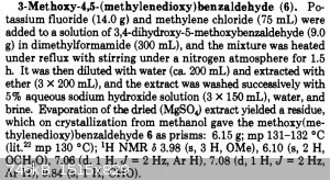

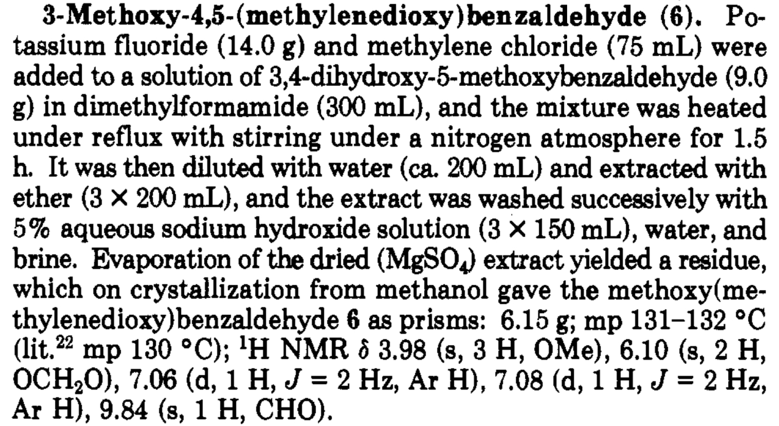

Haven‘t yet had the time to continue with figuring out this synthesis, but while browsing Lamdasyn I came across a mention of a procedure making myristic aldehyde from 5-hydroxyvanillin by the reaction with DCM in DMF with simple KF catalysis in a reasonably impressive 63,4% considering it used neither nucleophilic nor phase-transfer catalysis.
IMG_8859.jpeg - 746kB
So I guess KF may be a lot more suitable than K2CO3 for the Williamson ether synthesis using bad electrophiles like DCM.
Attachment: Structure and Synthesis of (+-)-Wuweizisu C - J. Org. Chem.; 1981; 46(14); 2969-2971.pdf (135kB)
