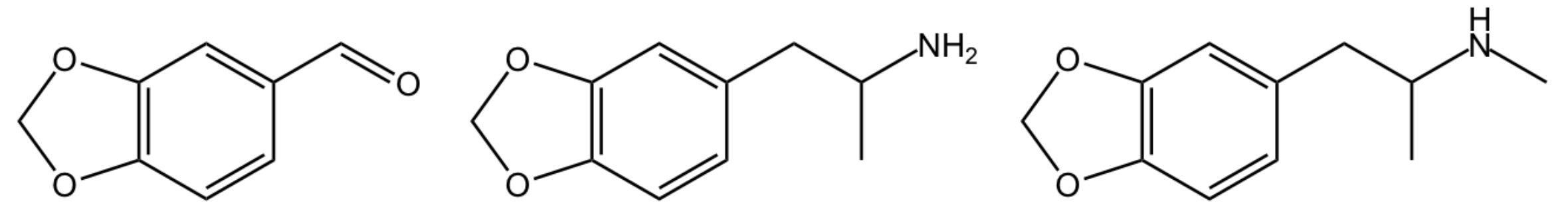

I reckon piperonal (also commonly referred to as heliotropine) is a compound most of you will probably be familiar with. It is most commonly known for
being the precursor to MDA-class drugs, particularly the N-methyl analogue MDMA, on the more legal side it and its derivatives also find lots of use
as flavoring ingredients and perfumes though.
Fig.1: Structures of piperonal (left), MDA (middle) and MDMA (right)

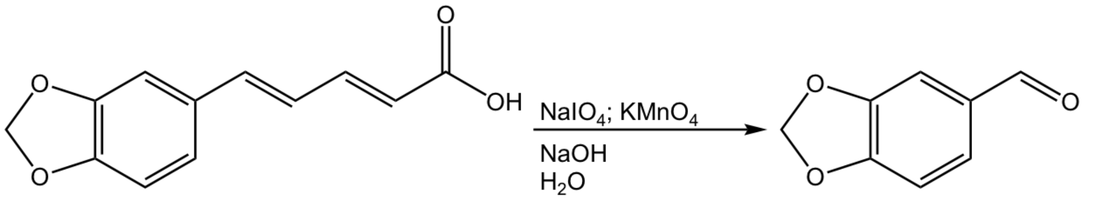

There are multiple feasible approaches of making it as the amateur, with ozonolysis (or the Lemieux von-Rufloff reaction) of either piperic acid or
isosafrol being most commonly employed from what I can see.
Fig.2: Oxidative cleavage of piperic acid to piperonal by Lemieux von-Rudloff conditions

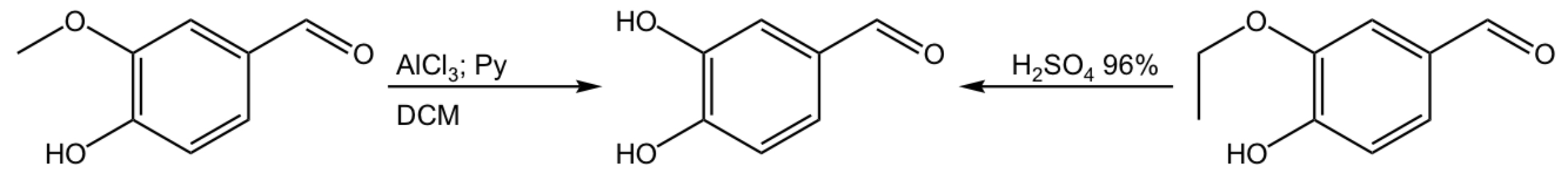

An alternative approach would be the methenylation of protocatechulic aldehyde by the Williamson Ether synthesis, which itself can be made from either
vanillin by the action of aluminium chloride and pyridine [3] or from bourbonal by the action of concentrated sulfuric acid, second of those methods
generally seeming the most accessible, being previously documented in another thread [4].
Fig.3: Synthesis of protocatechulic aldehyde by demethylation of vanillin (left) or deethylation of bourbonal (right)

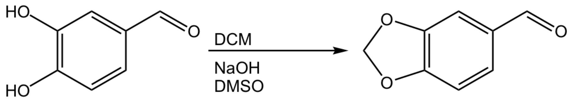

For the methenylation itself the use of diiodomethane would be ideal, but because of its significantly higher accessibility and lower molecular weight
DCM shall be employed. Following [5] on the example of unsubstituted methylenedioxybenzene the use of sodium hydroxide as the base and DMSO as the
solvent may be reasonably successful.
Fig.4: Proposed synthesis of piperonal by methenylation of protocatechulic aldehyde

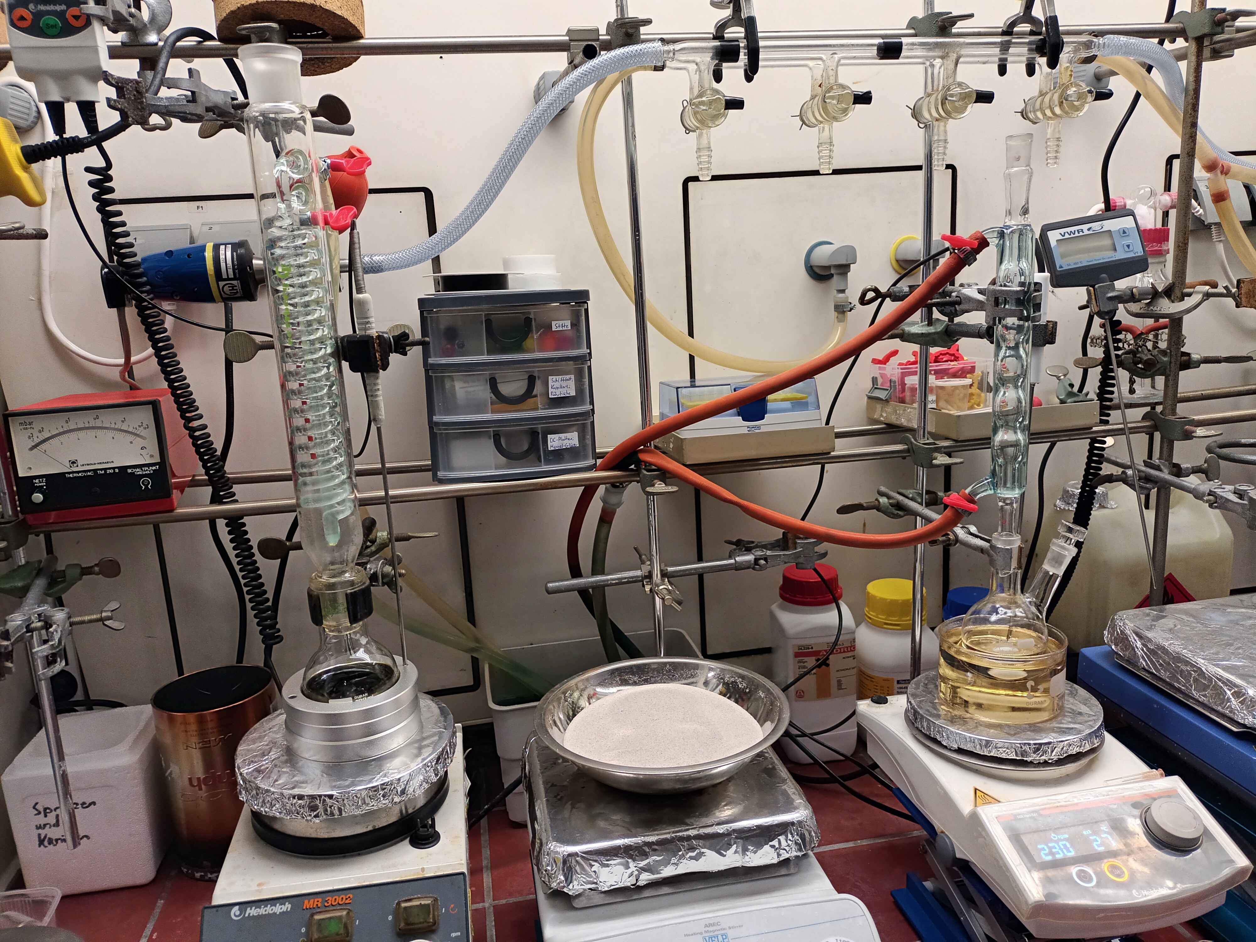

To get things started, inside an 100 ml RBF, 9,12 g of sodium hydroxide (0,23 mol) were dissolved in 10 ml of dest. water and cooled back down to room
temperature. This was followed by 20 ml of DMSO and left to stirr for a couple of minutes, during which time things turned a uniform slushy
consistency (probably due to NaDMSYL precipitating). A Dimroth-condenser was attached and the flask was warmed to 95-100°C with the help of a heating
block, resulting in a clear colorless solution.
Fig.5/6: Slushy of presumably NaDMSYL (left) and eventual clear solution of the base (right)

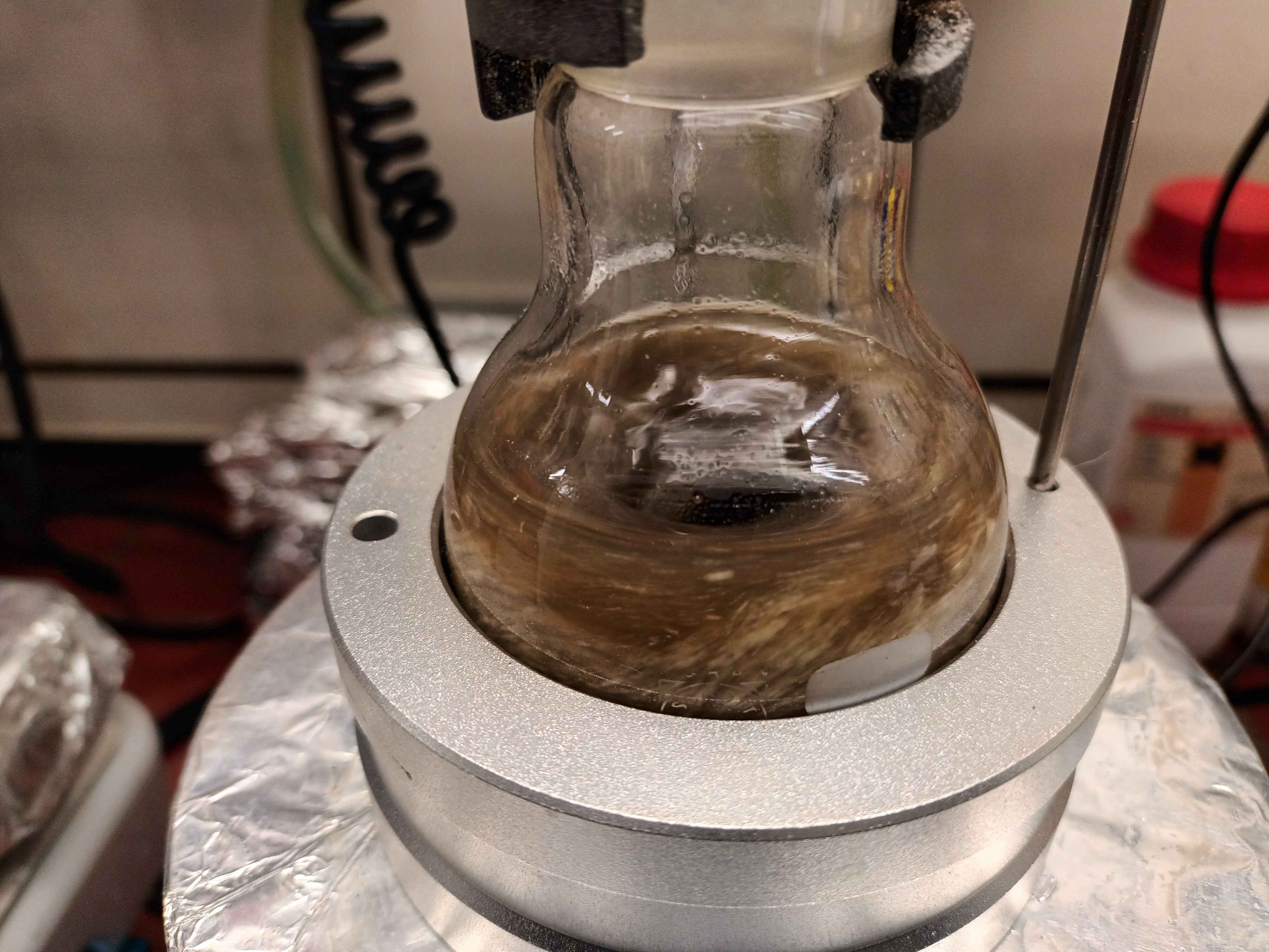

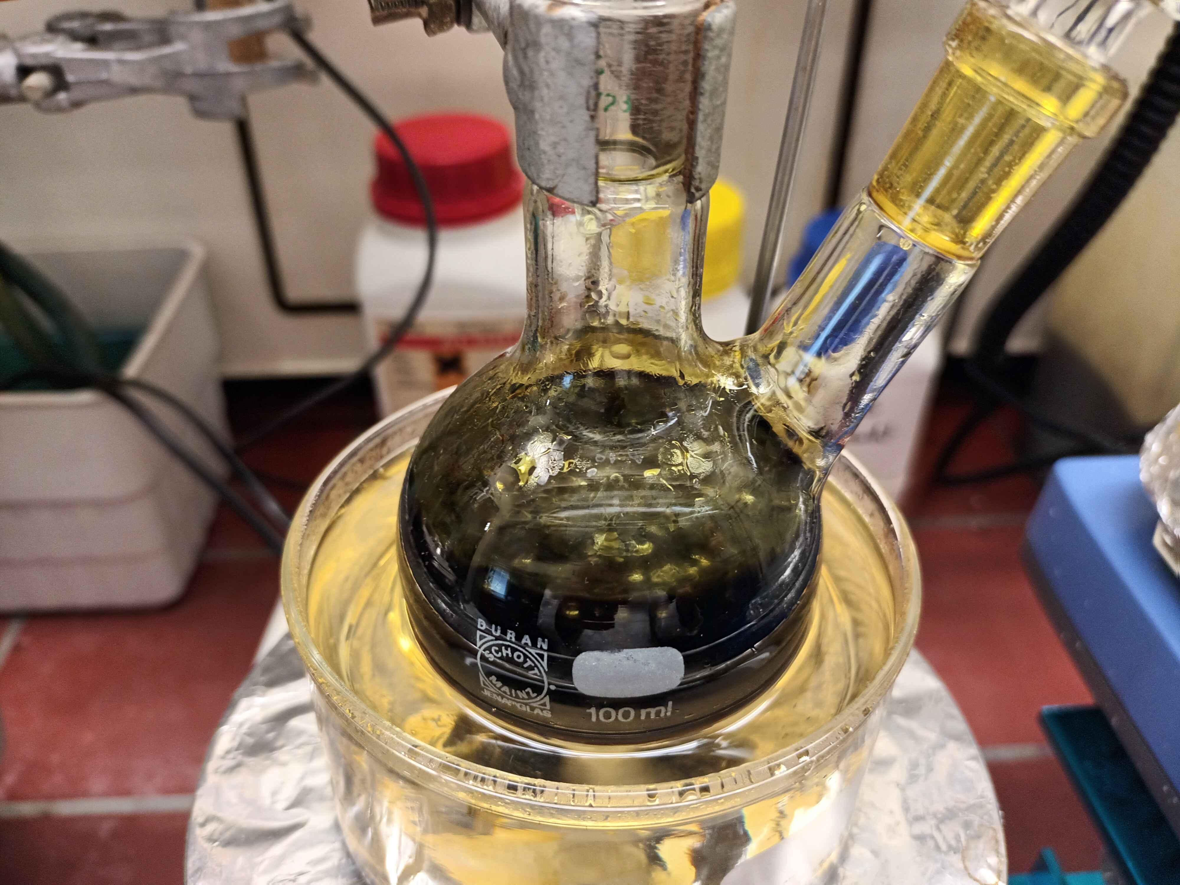

To this 13,8 g of commercial protocatechulic aldehyde (0,1 mol) were added as a powder, instantly causing the mixture to discolor and eventually take
on an almost black color. Heating was continued for 30 more minutes, during which time a separate reflux apparatus containing 12 ml of DCM (0,19 mol)
in 30 ml DMSO, heated to 70°C with the help of a glycerol bath, was set up.
Fig.7/8: Strongly discolored solution of the protocatechulic aldehyde (left) and the apparatus used for the preparation (right)

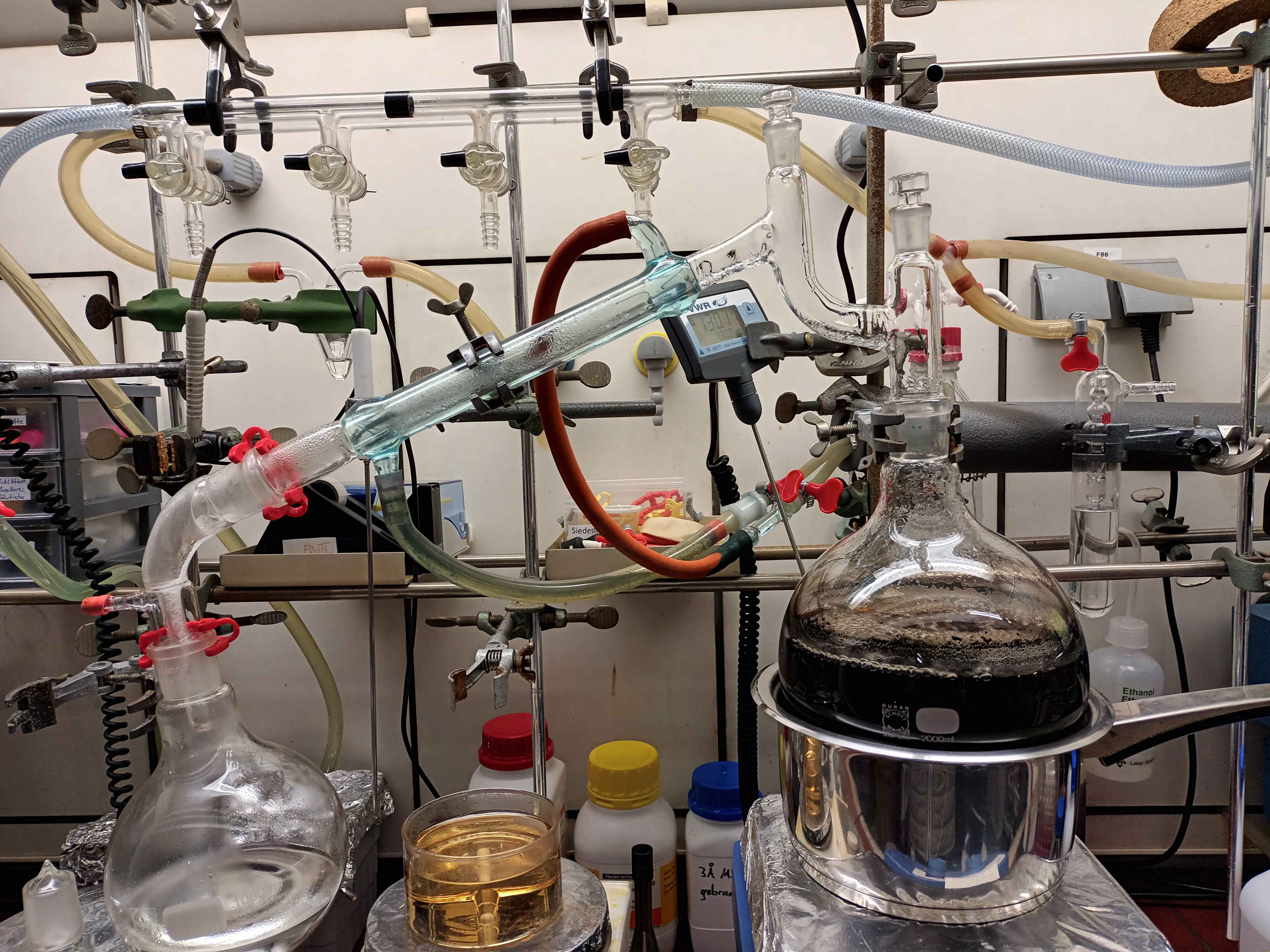

The temperature of the glycerol bath was risen to 100-105°C, and heating was continued for approximately 3 hours. To isolate the piperonal a steam
destillation of the black mixture was performed until the destillate coming over was fully transparent.
Fig.9/10: Final reaction mixture after combining the two solutions (left) and performing the steam destillation (right)

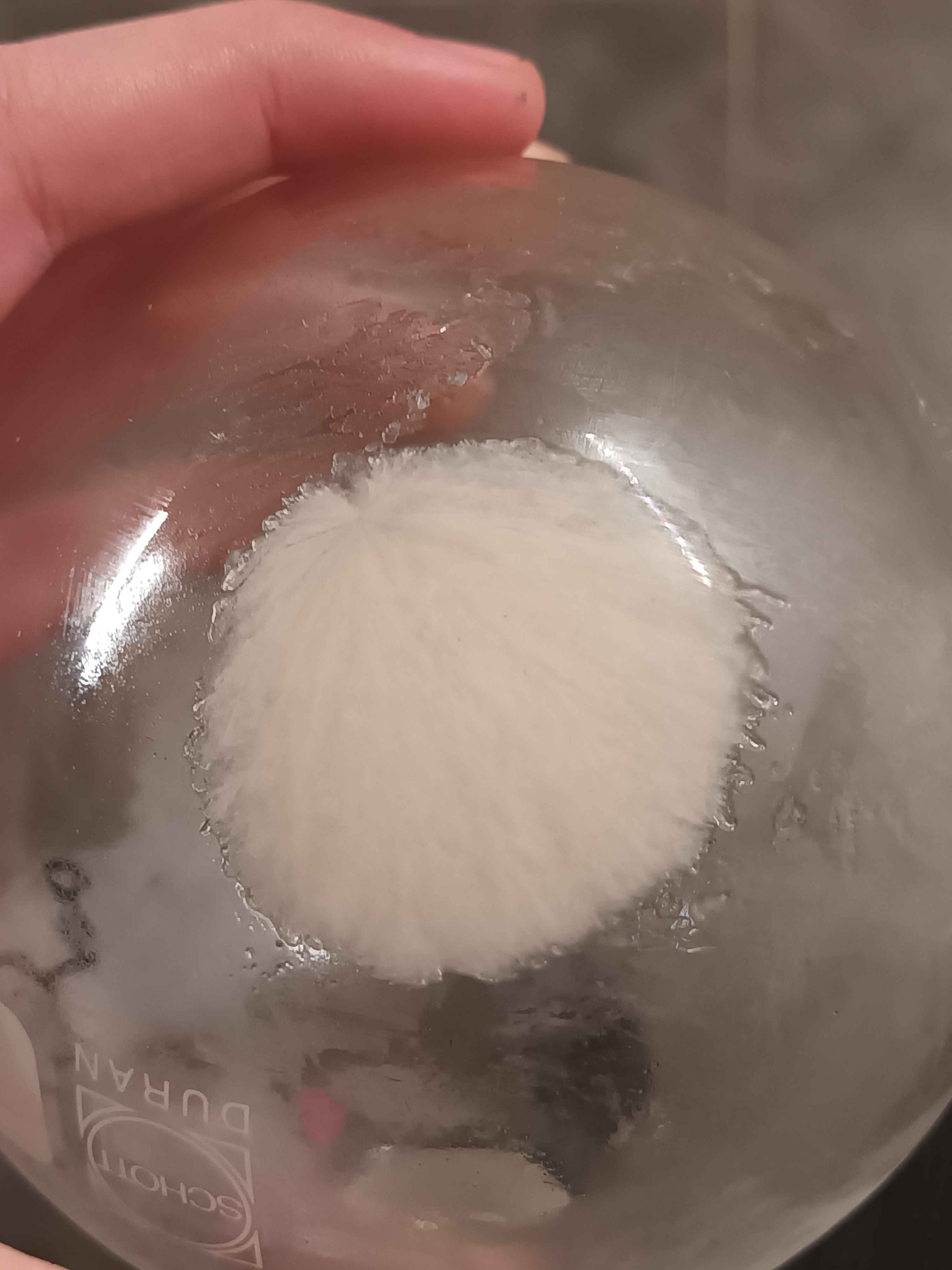

In total almost 100 ml of destillate were collected, with lots of product freezing in the condenser. Things were extracted three times with DCM, the

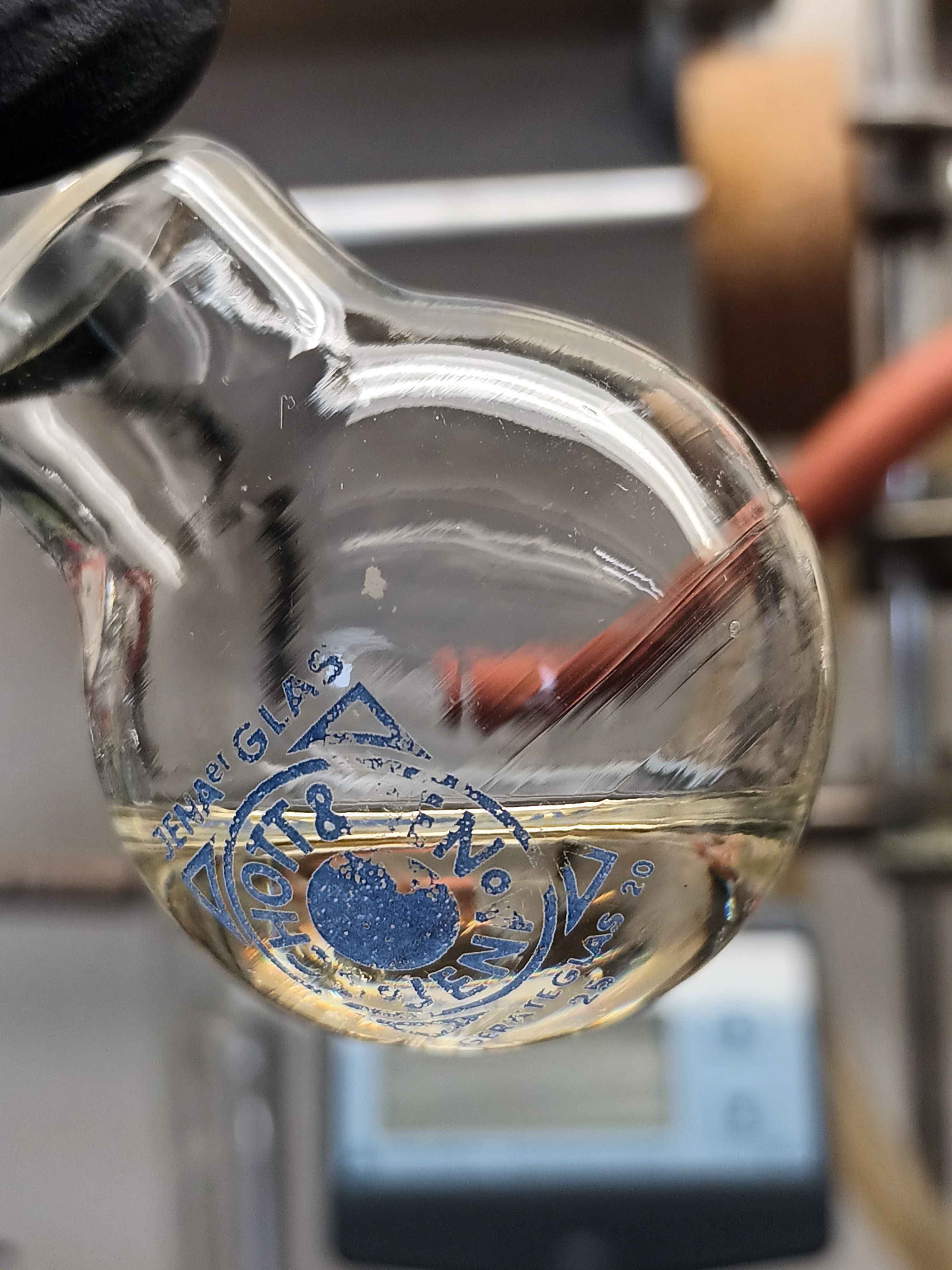

pooled extracts were washed with 2 molar sodium hydroxide solution (this took up all the slight yellow color there was) and saturated brine, and dried
over sodium sulfate. The solvent was rotovaped off, and a vacuum of 0,3 mbar was pulled on the product to remove any dimethylsulfide present from
decomposition of DMSO. This resulted in a small quantity of crystalline off-white solid (0,97 g; 6,46%) with a melting point of around 30-35°C with a
clear residual dimethylsulfide smell.
Fig.11/12: Rotovaping off the DCM (left) and the final crystalline piperonal (right)

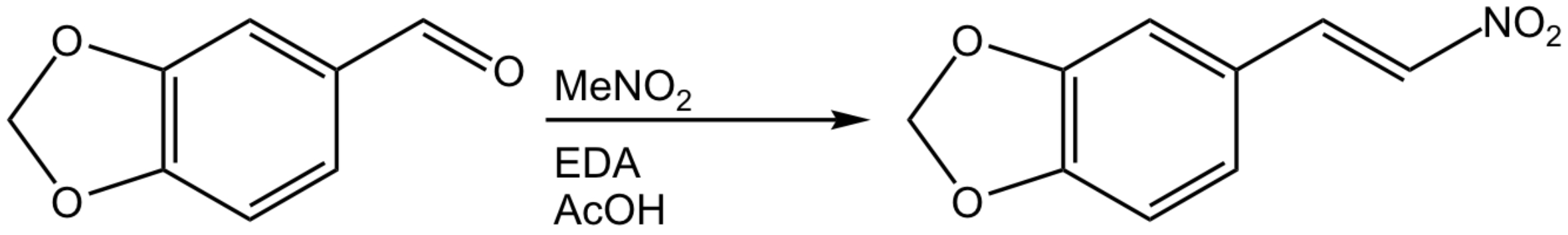

Fig.13: Synthesis of 3,4-(methylenedioxy)-beta-nitrostyrene by Henry condensation of piperonal and nitromethane
In addition to the piperonal made in the previous procedure a small quantity of an old commercial sample was added to add up to 1,5 g of starting
material (10 mmol). This was dissolved in 5 ml of glacial acetic acid by swirling the flask and set in a heating block on a magnetic stirrer. To this
292,2 ul of ethylene diamine (4,37 mmol) was added with the help of an eppendorf pipette, followed by 1 ml of nitromethane (18,46 mmol), instantly
causing the colorless mixture to take on a yellow color.

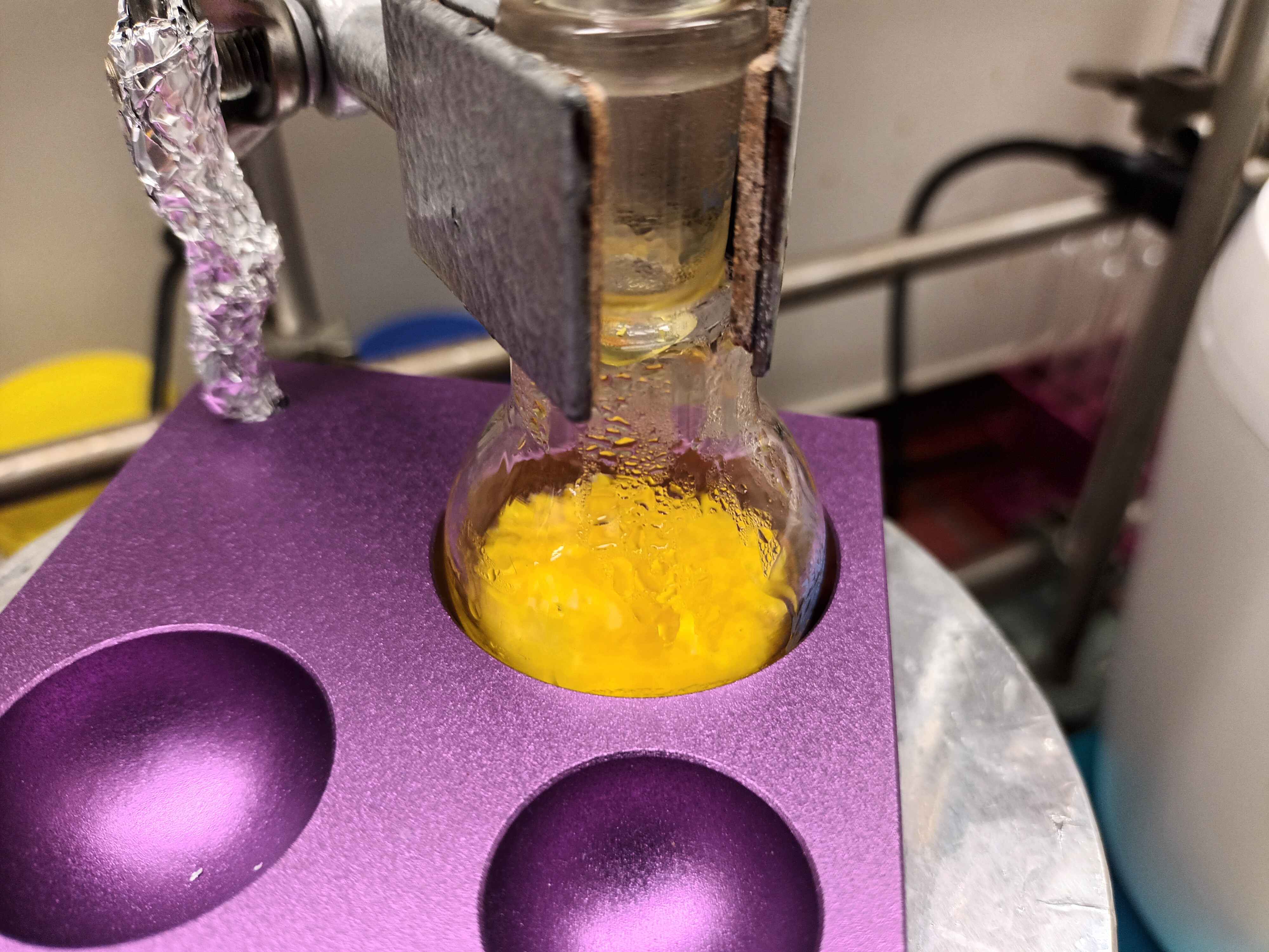

Fig.14/15: Solution of the piperonal in GAA (left) and the reaction mixture after addition of the nitromethane (right)

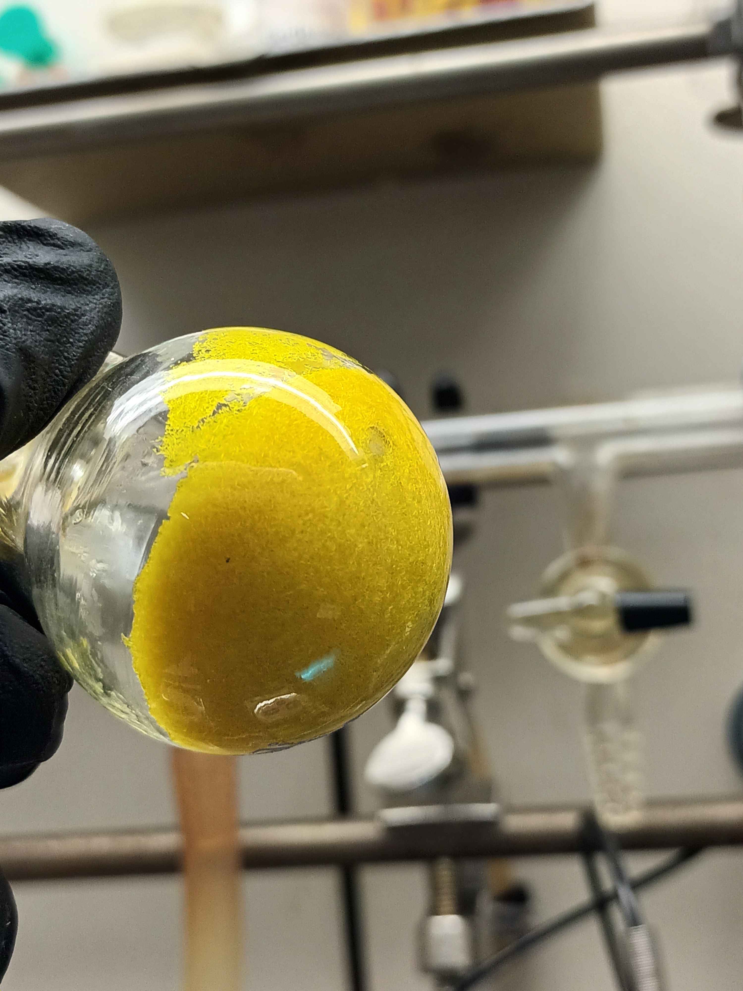

Stirring was turned on and things were heated to 100°C for 45 minutes, during which time some yellow needles of product started precipitating. The
suspension was cooled in the fridge, and the solid was removed by vacuum filtration and washed with a little dest. water.
Fig.16/17: First precipitation of product (left) and the reaction mixture after cooling in the fridge (right)

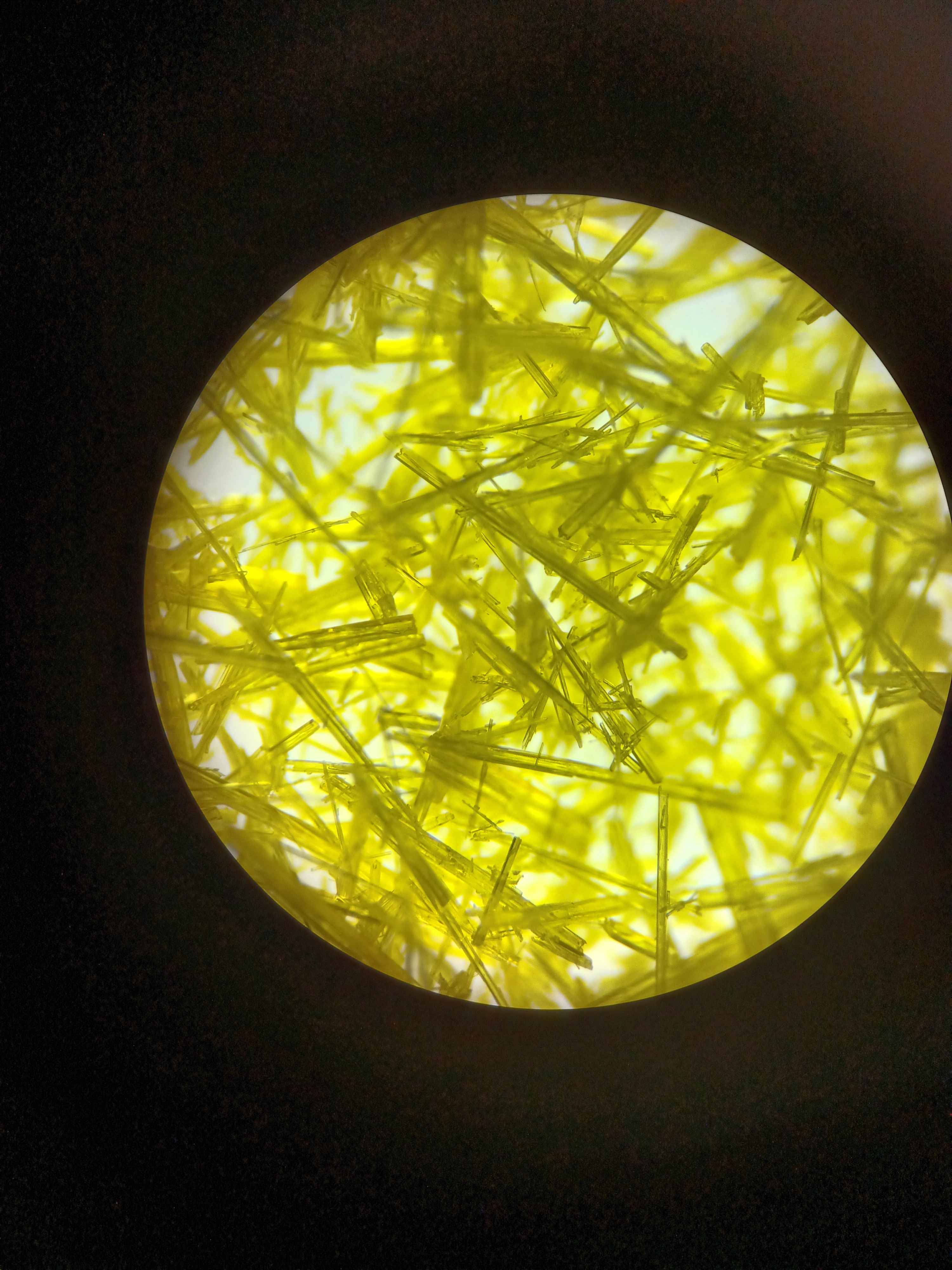

For further purification the product was recrystallized from 1-propanol, resulting in some gorgeous thin yellow needles of
3,4-(methylenedioxy)-beta-nitrostyrene (1,34 g; 69,44%).
Fig.18/19: The air dried product (left) and its crystals under the microscope (right)

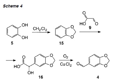

I have often wonder if it would be better to start from catechol --> methylenedioxybenzene --> piperonal.
With catechol there are fewer functional groups o worry about and there are many formylation methods then available to choose from.

I’ve thought about that as well, tho I never came to a conclusion that fully satisfied me. Most of the really good OTC formylation approaches
(particularly Duff reaction) are unfortunately ortho-directing, and the alternative of doing a two-step approach via the Blanc-reaction followed by
Kornblum-oxidation (something similar should be documented on Erowid iirc), comes with the significant downside of forming highly carcinogenic BCME as
a byproduct in the first step..
Additionally I‘m really not sure about the accessibility of catechol for the average amateur. I know it is occasionally found in oxygen absorption
packs, but I feel like that’s a really expensive way of getting a reagent..
Like sure, I could personally use my catechol bought at Sigma and formylate that with my TCT / DMF purchased from TCI, but that feels like defeating
the purpose of publishing it here.

Glyoxylic acid is an interesting possibility. It is an extra step.
Alkyl glyoxylates are occasionally reported to undergo basically the same reaction. My hypothesis is that making them from dialkyl tartrates might be
easier than making glyoxylic acid from tartrate + periodate, because the resulting mixture of salts is very hard to separate and makes that method
harder (glyoxylate and iodate have similar solubility). Periodate can also work for the ester cleavage step, which is nice.
So the reaction of an alkyl glyoxylate with benzodioxole is the idea I'm most interested in working with benzodioxole. You could degrade the
methylenedioxymandelic ester in the usual fashion or possibly do something creative.

@ clearly_not_atara; What's wrong with a reaction analogous to the guaiacol + glyoxalic acid route to vanillin? The only issue I see is that in this
reaction aqueous alkali is used in which both reactants are soluble. Where as the methylene-dioxybenzene ether will not be. But cold say methanol be
used as the solvent? Rather than using the less accessible glyoxalate ester.

Boffis: Unlike guaiacol, benzodioxole does not form a phenolate, so it does not react spontaneously without an acid catalyst. Alkali catalysis is not
available on benzodioxole. But with acid catalyst, usually some sticky crap is produced. I have heard that conc. H2SO4 at 0 C is a good system, but
this reagent is restricted now, and dehydrating sulfuric acid is unpleasant.
So the idea was to use things which are more soluble in np, allowing the product mandelate ester to be extracted from the rxn mixture. This might be a
less "sticky gunk" situation.

On a different point, something that just came to my head.
I now think the main issue with the piperonal synthesis probably is the use of NaDMSYL and hydroxide as the base, which may cause the aldehyde to
disproportionate in a Cannizzaro like fashion.
So by using much weaker potassium carbonate instead, which shouldn’t impact the reactivity all that much considering the acidic nature of the phenol
hydrogens, this may result in a significant improvement of yield.
Posts: 2818
Quote: Originally posted by Niklas  | On a different point, something that just came to my head.
This is correct; in the original Bonthrone and Cornforth, the methylenation of protocatechualdehyde with hydroxide base gave a poor yield, but when
the rxn was later attempted in a forensic chemistry (lol) journal with K2CO3, the yield was around 80%.
The difficulty with K2CO3 is finding an appropriate solvent. NMP is a better solvent for potassium carbonate than are DMF or DMSO, and this is what
the researchers were using. IIRC, K3PO4 has a better solubility in more common solvents. Beitia et al describe its use in DMF at 100 C, in DMSO at 80
C, and in glycol ether solvents.
Attachment: k3po4_beitia2011.pdf (79kB) This file has been downloaded 492 times

You can make Benzodioxole from catechol and Ch2Cl2.
Then react this with glyoxylic acid to get 3,4-methylenedioxymandelic acid.
Then to piperonal using O2 and CuCl2 or using AgNo3.
See attached paper
Attachment: 1488-Bjorsvik.Liguori.Minisci.Synthesis.Vanillin.Isovanillin.Heliotropin160c.pdf (183kB) This file has been downloaded 125 times

That’s definitely a nice one, didn’t expect it to be a documented approach honestly. Really promising yields as well, seems worth giving a try (as
far as the optimized alkylation procedure I‘m planning on trying next week ends up being unsatisfactory at least).

Greetings everyone, I honestly ended up procrastinating on revisiting the synthesis again, but here we go finally.
As a disclaimer, the approach I tried still kinda quite sucks, while the yield isn’t as bad, and the product seems to at least be actually
pure this time, it’s still definitely not what I‘d consider satisfactory. Probably on me tho, I‘m starting to think that steam distillation
probably really just is an awful way of working the mixture up (don’t ask me why I ended up ignoring the advice given for that), and I may
eventually revisit the procedure using an extraction process in the workup (potentially by extracting with ethyl acetate, washing this with brine to
remove residual DMF, removing the solvent, and vacuum distilling the residue).
Anyway, here the actual synthesis now:
A 100 ml round-bottom-flask was charged with 6,91 g protocatechulic aldehyde (50 mmol), 16,59 g anhydrous potassium carbonate (120 mmol), 1 g
potassium iodide and 500 mg hexadecyltrimethylammoniumbromide. 60 ml of DMF were added dissolving most of the solids, resulting in a brown suspension
of undissolved carbonate. This was followed by the addition of 6,5 ml DCM (101,4 mmol), a condenser was attached, and the mixture was heated to 90°C
in a heating block for 36 h, where on analysis with TLC (3:1 n-hexane / ethylacetate) at the twelfth hour most of the starting material seemed to
already be converted. After cooling the resulting dark-brown solution was diluted with water, and the mixture was steam destilled until around 1600 ml
of destillate had been collected, at which point the destillate seemed no more cloudy with no more oil separating. This was extracted three times with
ethyl acetate (DCM heavily tends to form emulsions here), the yellowish extracts were washed with dilute brine, the solution dried over anhydrous
sodium sulfate, and the solvent removed under rotary evaporation. This resulted in a small quantity of a yellowish oil, which on cooling to -20°C in
the freezer solidified resulting in a white crystalline solid with a flowery smell. 3,00 g ; 40%
Fig.1-2: The progress of the reaction
Fig.3: Performing the steam distillation
Fig.4: Crystallized, still slightly wet piperonal
