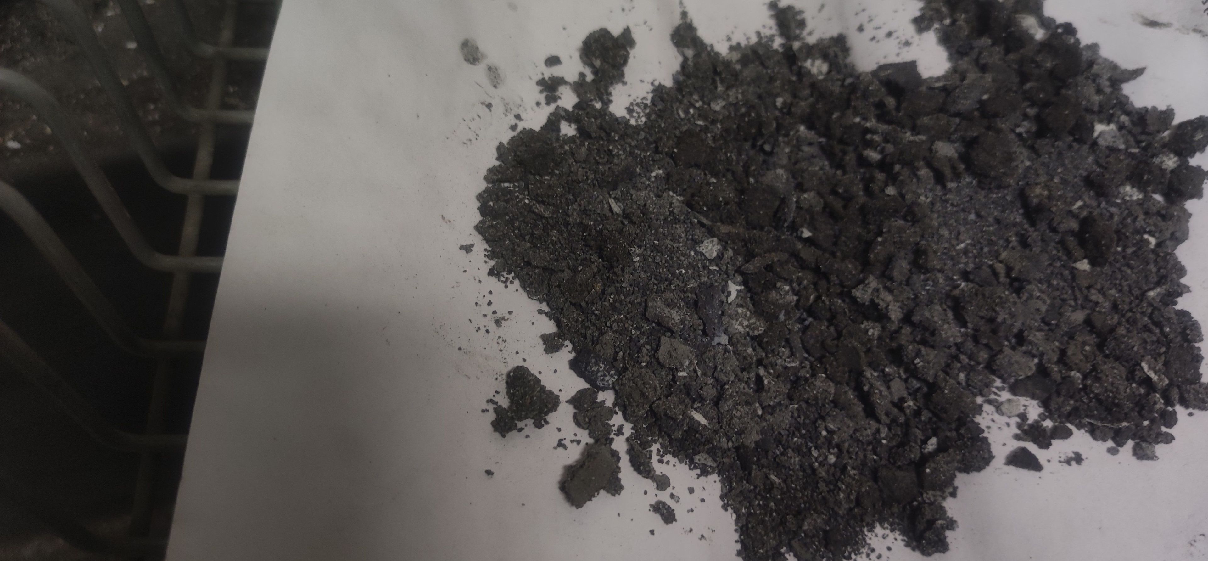

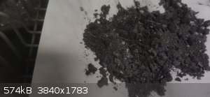

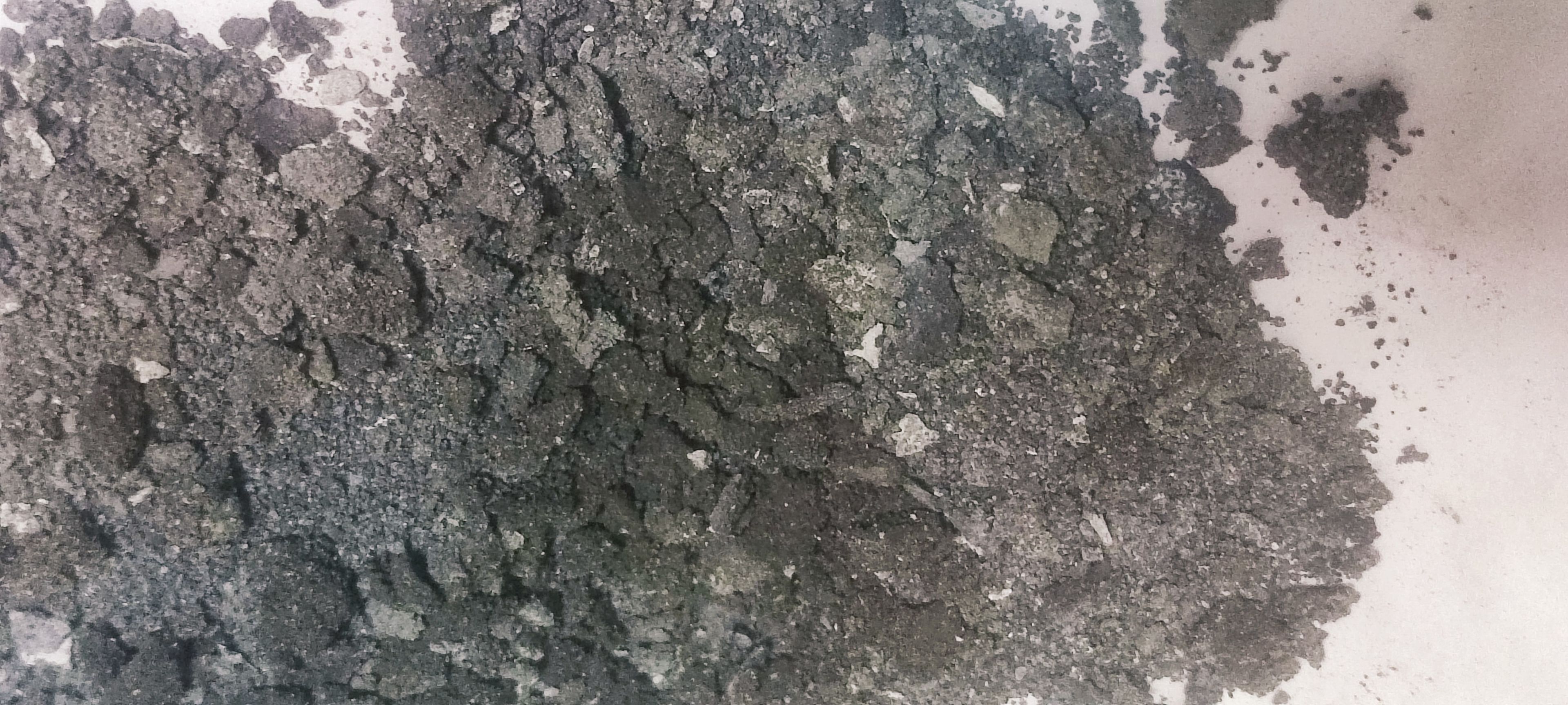

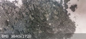

Recently I carried out a reduction of SiO2 using Mg.
The amount of Mg used for the reaction was a few percent higher than it would result from stoichiometry. Among the products you can see inclusions of a white substance, most likely unreacted SiO2. The SiO2 came from fuses.
Sil2.jpg - 574kB Sil1.jpg - 1MB
I confirm that we will not get pure Si using this method. The thermite reaction is pretty for show: it proceeds calmly, shining with a strong white light. A lot smoke is generated.
I purified the post-reaction mixture in diluted HCl and washed it several times with water.
I show what I got in the photo. Among the reaction products was magnesium silicide: when pouring Si into the acid, you could hear a lot of shots and sparks above the solution.
The reaction of magnesium silicide with HCl was identical to that in the article:
https://en.wikipedia.org/wiki/Magnesium_silicide
