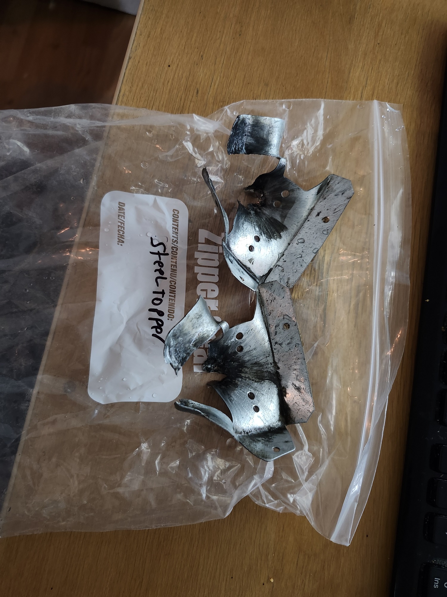

Getting closer. This was half a gram of NAP in a sealed PT100 thermometer body. Hand packed densities. Slowly scaling up the amounts as I am testing my det chamber’s ability to cope with these things as well. So far it’s done well to contain small amounts of shrapnel and deaden the sound to the point that the dogs don’t even react. Next test is 1 gram of NAP.

Surely it was a detonator ? It looks like woodpecker pecking.....:cool:

[*] posted on 20-4-2024 at 05:14
I’m not sure what happened there. It’s very interesting.

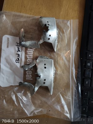

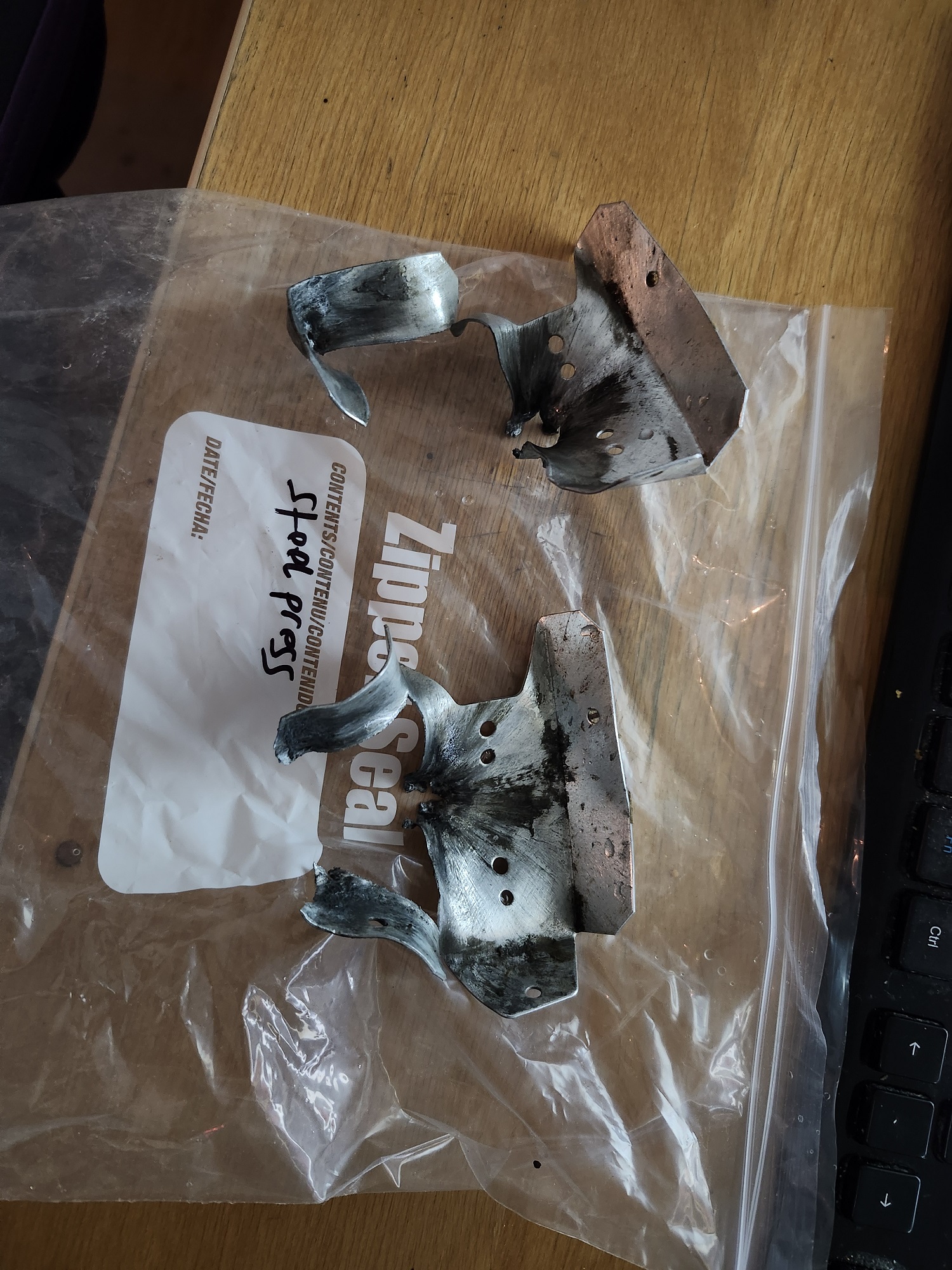

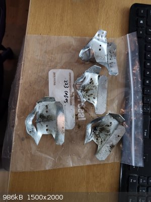

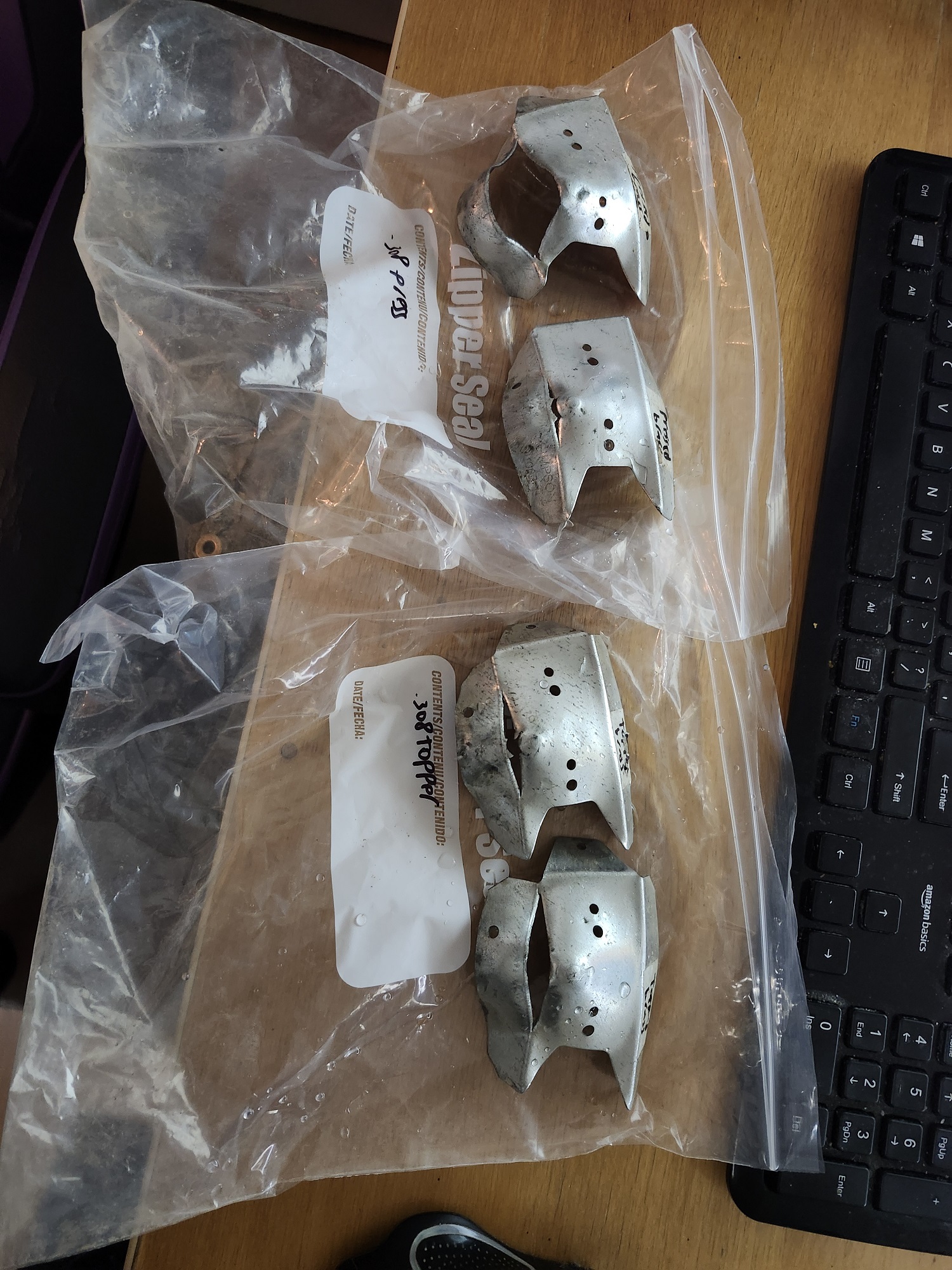

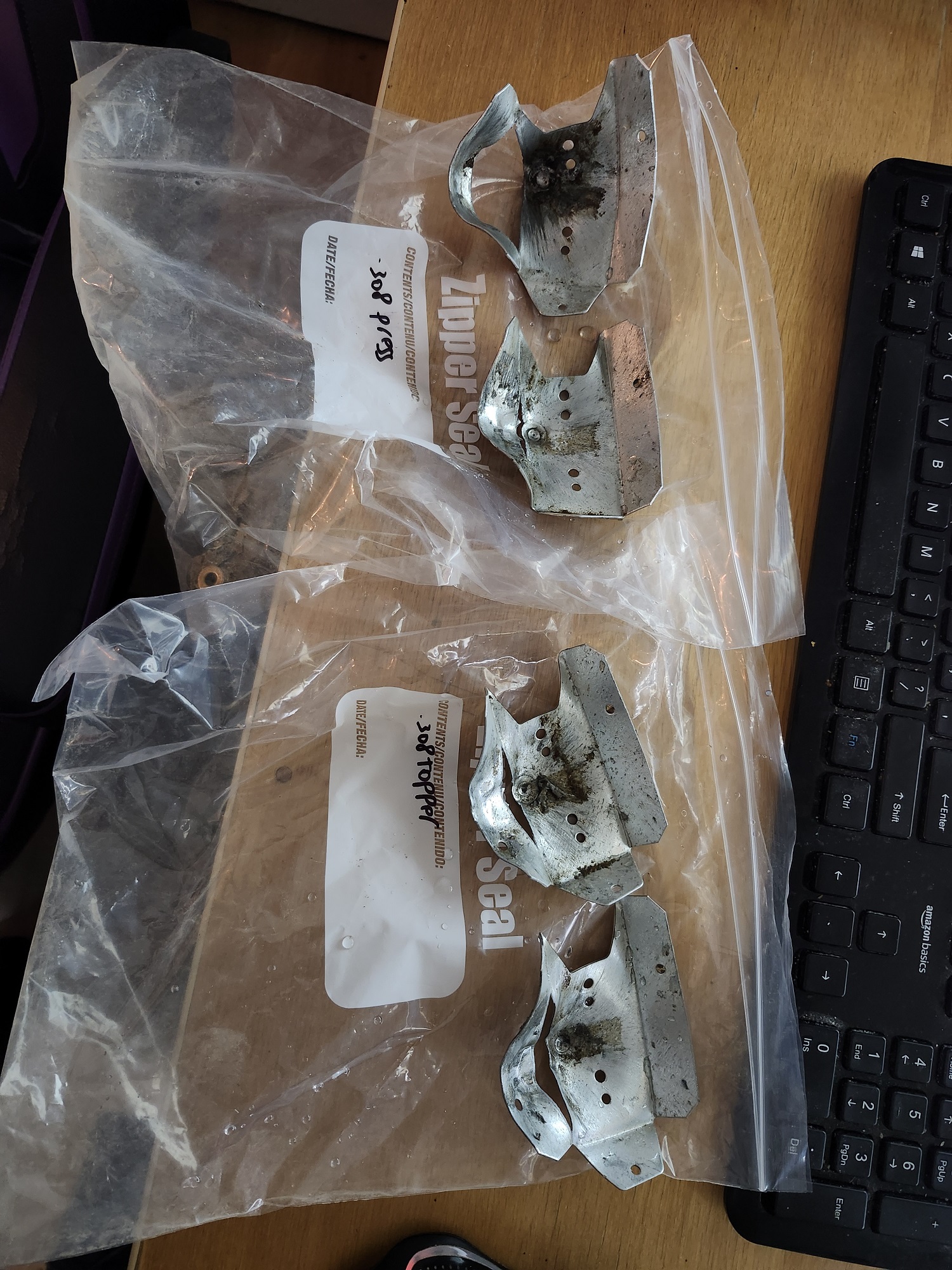

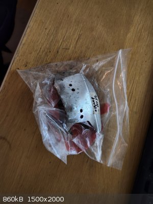

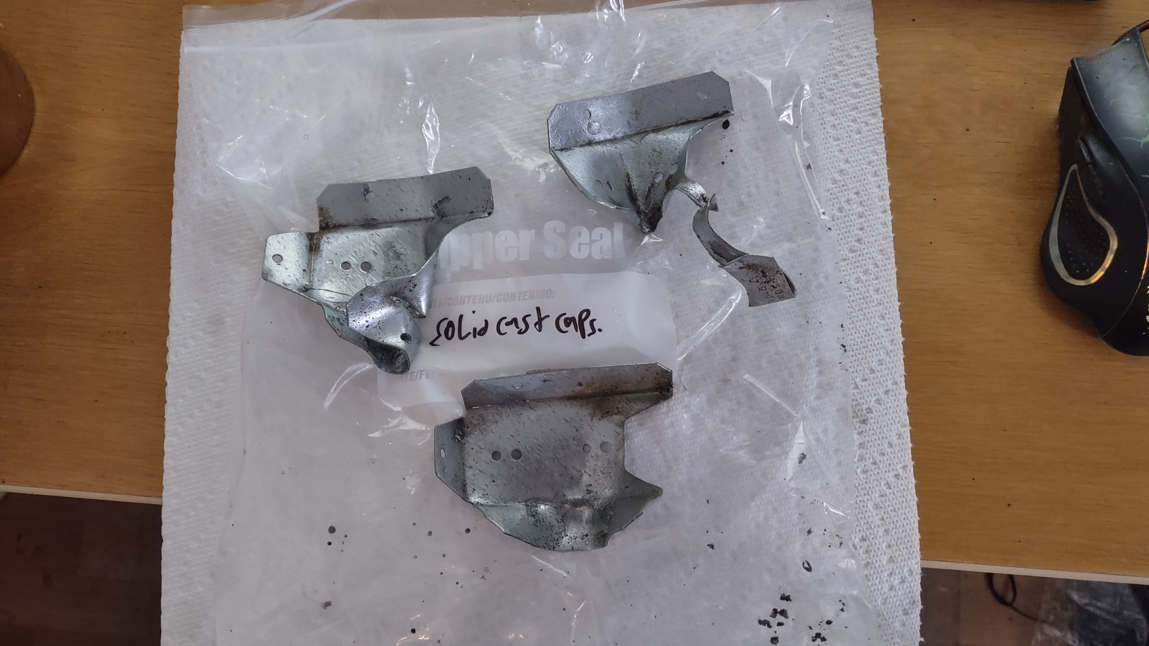

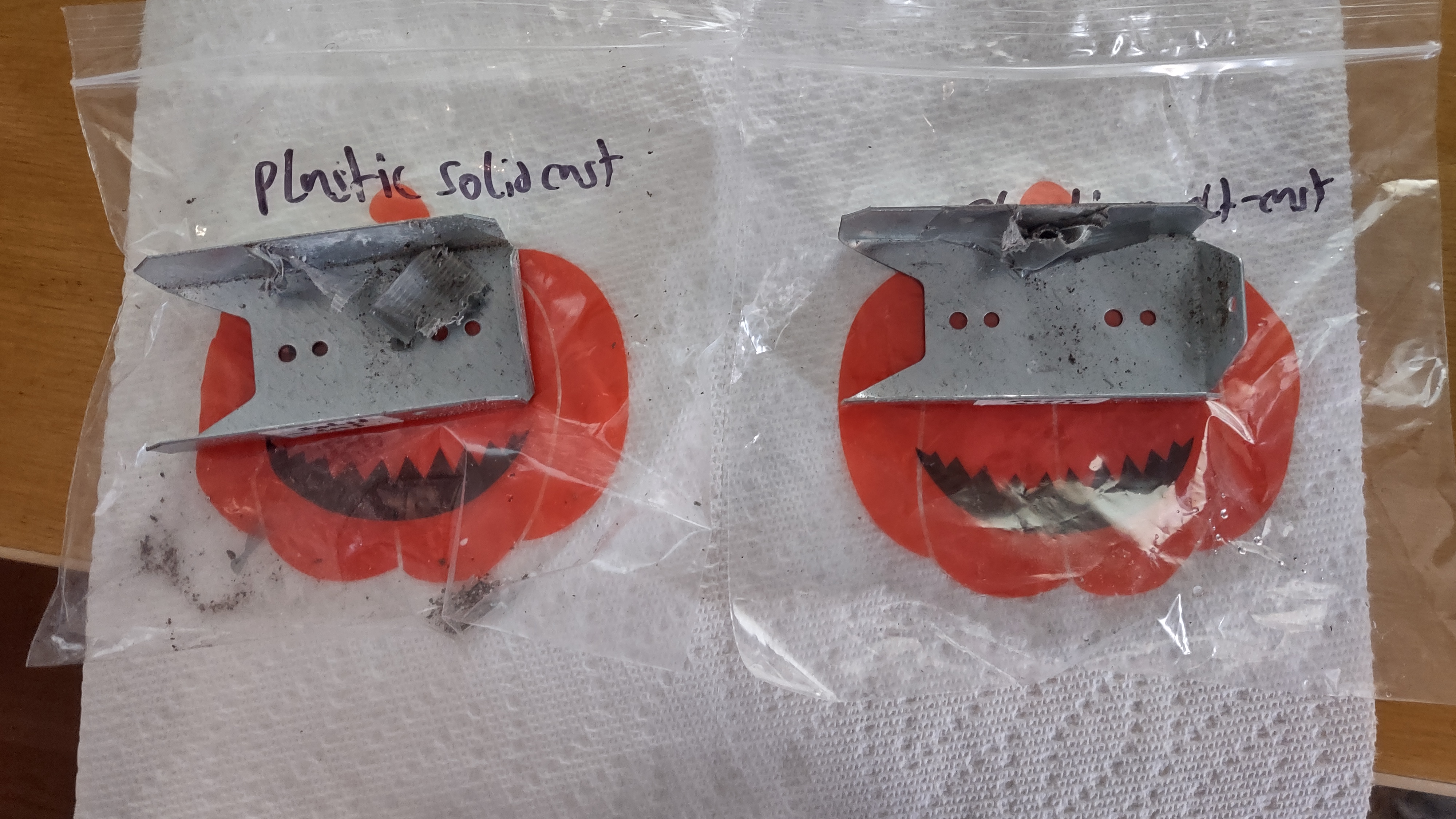

OK, so I went out to test out my blasting caps. I made 9 total caps for testing, 6 steel caps, 2 plastic caps, and 1 7mm remington magnum shell with the neck removed (should have kept it in retrospect). All but the 7mm shell had 1g of ETN + 0.3g of ETN/NHN mix (melt-cast and ground ETN). The ETN/NHN was only very lightly tamped and not pressed. The 7mm shell had 4g of ETN + 0.6g of ETN/NHN mix.

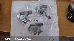

3 of the steel caps and 1 of the plastic caps had solid cast ETN in them, this was done via pressing the powder ETN and then placing the cap inside hotwater to melt the ETN before it was carefully removed and allowed to cool down for 30 minutes at least. These caps had inconsistent performace that convince me that making solid-cast ETN to explode is a lot more difficult than I thought. The plastic cap did no damage to the witness plate but it did fully explode. It was the loudest plastic cap I ever detonated.

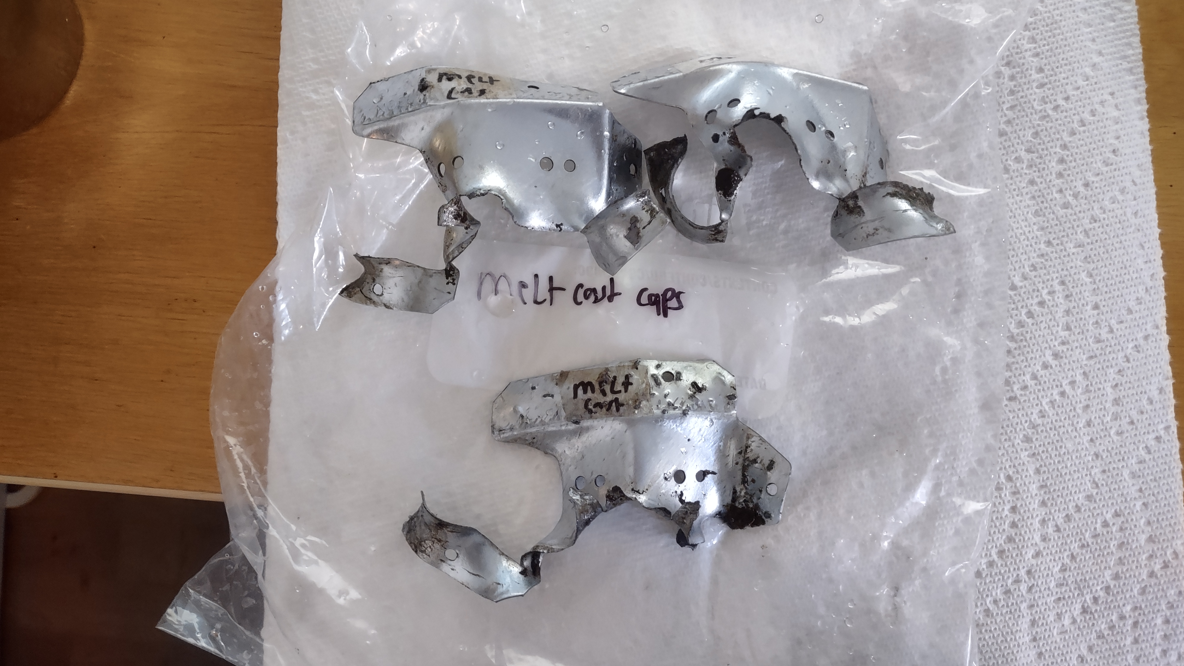

Another 3 steel caps and 1 plastic cap had melt-cast and ground ETN pressed in them and they performed much, much better. I am convinced that this is the best material to use for blasting caps. The plastic one, however loud it was, didn't even fully detonate all the ETN! I actually had to tip out the ETN from the cap, which I found very strange.

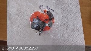

The 7mm remington magnum shell... holy hell. That was intense. I didn't even all the pieces of my witness plate, it was blown to bits. I wonder if this cap would be sufficient to detonate ammonium picrate?
I think I am mostly done testing out caps. I know that LL will tell me that I need to remove the bottoms of the caps and... I agree. I should be doing that and using a little aluminum foil to stop the stuff from coming out and to hold it in place. Real detonators do have a very thin bottom (sometimes as thin as 0.03mm). I think that without much need for testing them they will be superior what I have now.
Plastic-caps - Copy.jpg - 2.4MB7mmbigcap - Copy.jpg - 2.5MB

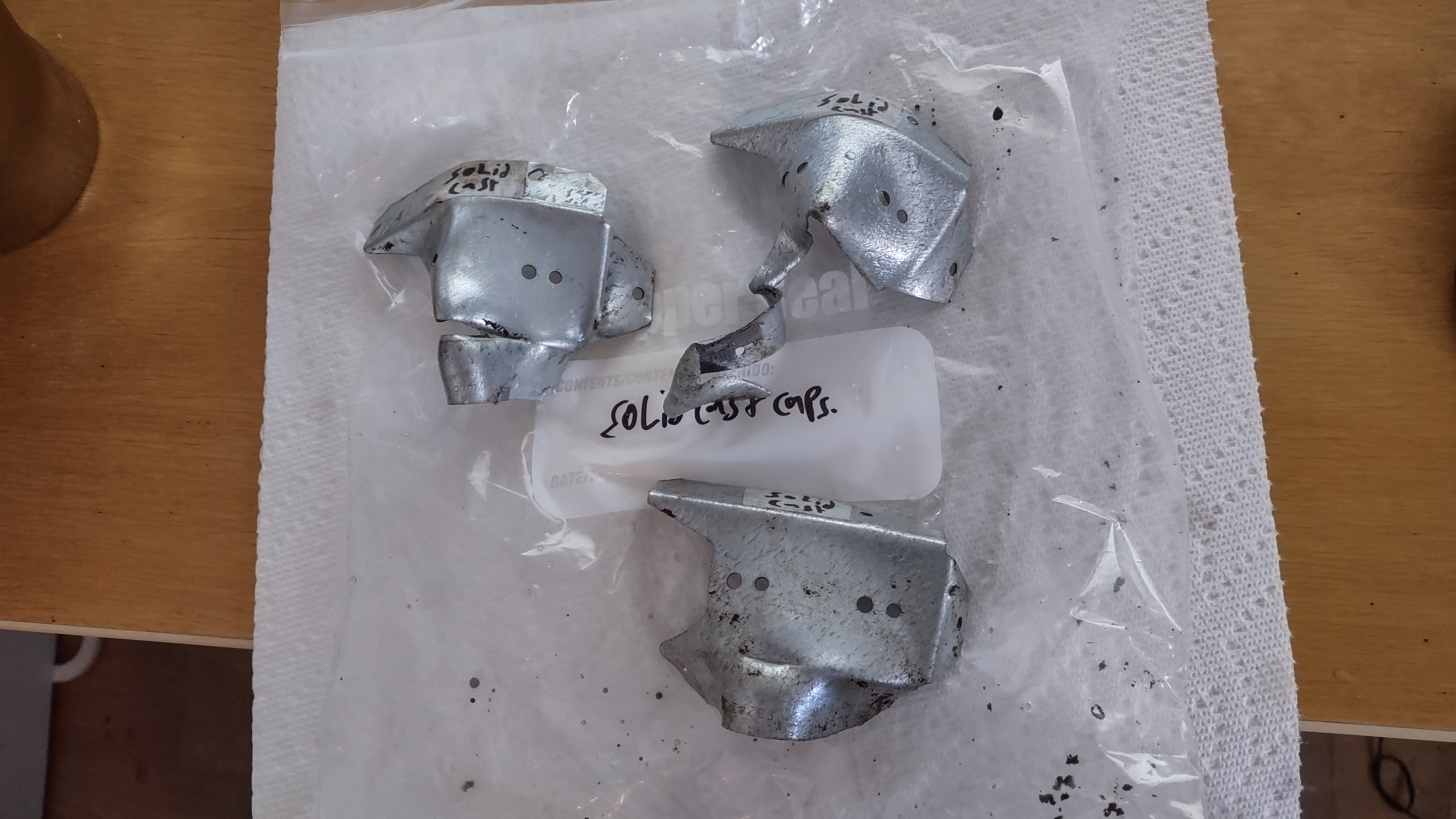

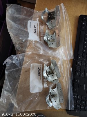

The rest of the pics
Melt-cast-steel - Copy.jpg - 2.1MBSoild-cast steel - Copy.jpg - 1.9MBSolid-cast-steel2 - Copy.jpg - 2MB

[*] posted on 3-7-2024 at 22:17
Your research confirms my long-held suspicions. That ETNs can be "overprinted". In my experiments, if the ETN was pressed in the vise to the highest possible density (estimated at 50 Kg) there was occasional incomplete detonation or even failure. ETN at high densities creates an insensitive block of matter. For this reason, it is better to press only at 10 Kg. For the output segment.
You described 9 attempt, but on photos are 12 damaged plates. It seem weird.....:cool:
The technical term is 'dead pressed', and perhaps you are right. Perhaps the solid-casting is what is causing that dead pressing issue without actually pressing it since it is at the highest possible density.
I don't use a vise, I always hand press, I tried to use a vise but it was always not good. So what I will do going forward is to give a solid press, but not too hard.
Also I showed some of the plates on the reverse. The solid-cast ones. That's why it looks like there are twelve. :)

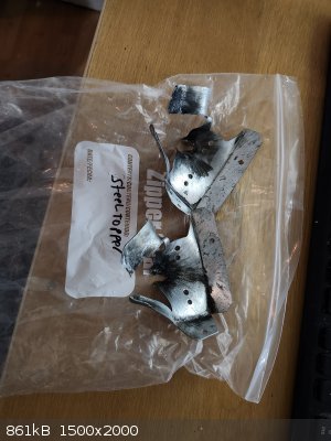

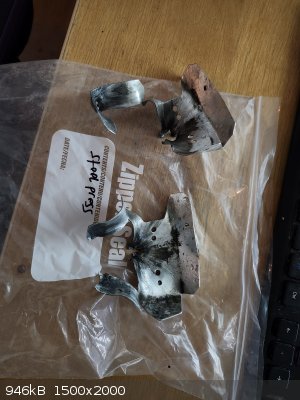

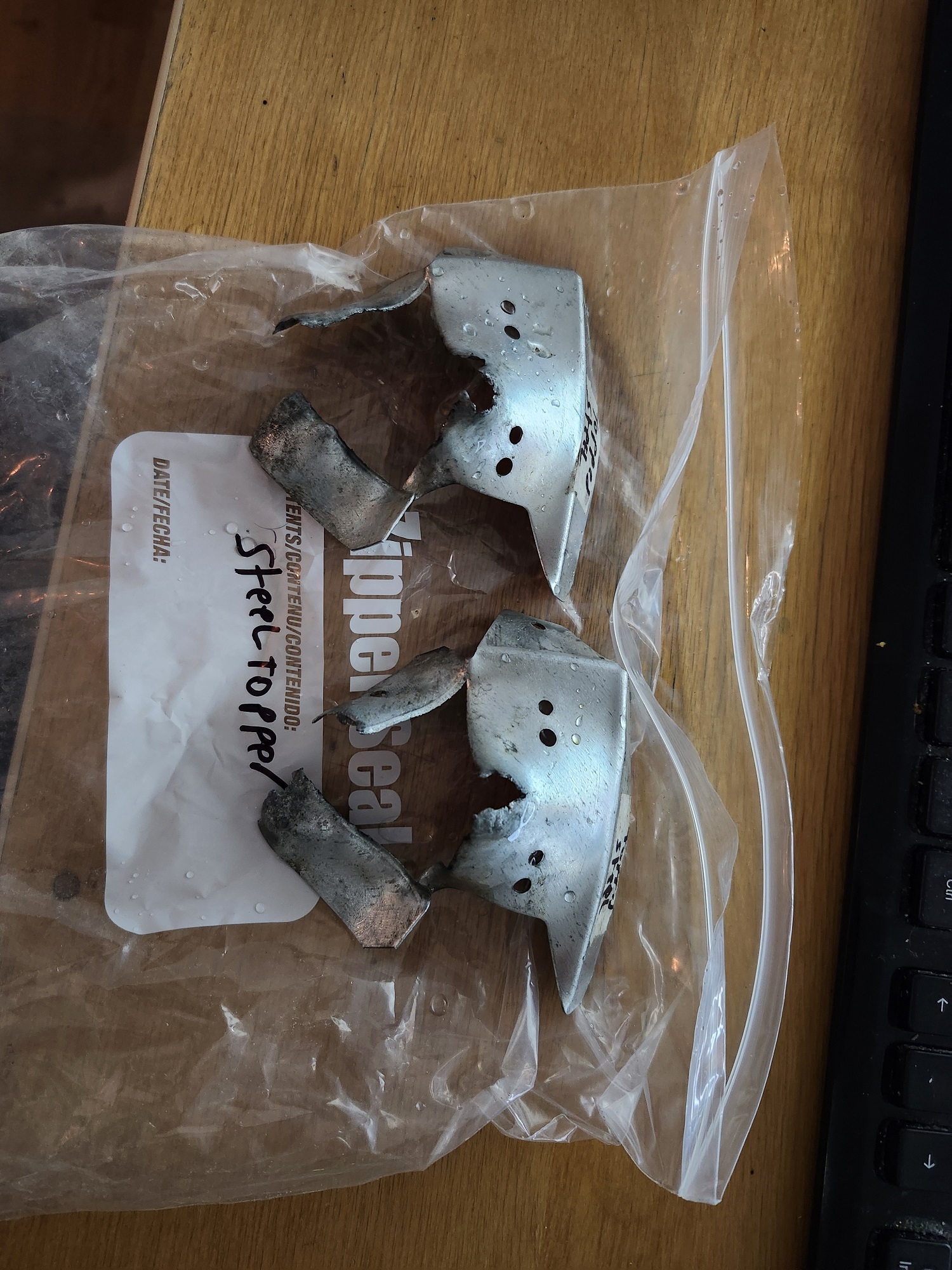

First set of photos.
20240811_213716 - Copy.jpg - 861kB20240811_213723 - Copy.jpg - 937kB20240811_214054 - Copy.jpg - 946kB20240811_214101 - Copy.jpg - 784kB20240811_214315 - Copy.jpg - 950kB20240811_214327 - Copy.jpg - 907kB20240811_214706 - Copy.jpg - 986kB20240811_214715 - Copy.jpg - 811kB
ManyInterests
Posts: 966
Registered: 19-5-2019
[*] posted on 12-8-2024 at 16:54
OK, so I wrote a much longer summary previously, but I will try to keep this one short.
I made a total of 13 caps. 4 steel and 9 brass shells. The 'pressed' is decently, but more lightly, pressed melt-cast ETN into the cases, while the 'toppers' were similar but had a little bit of lightly tamped ETN on the top. I think ultimately they were identical. I will let you, LL, if you read this, to decide if these steel cased one in this instance that blew a much nicer hole than last time (which blew more of the steel plate apart, which you said was not good).
I learned a valuable lesson with brass casings. The Improvised Munitions Handbook advised to remove the primer and drill a bigger flash hole in the bottom to allow the fuse to fit through (and in my case an e-match as well). I didn't know why this was the case, but I was told that the bottoms of brass shell casings are very thick and very hard... and I had no idea just how true that was! The results show. There are no holes, because the bottom simply did not allow the explosion to go downwards enough.
So going forward I will make some more detonators made from 5.56x45mm/.223 shell casings but I will have the explosive train start from the bottom to the top.
Now this is the big one: You mentioned bottomless casings, or cavities as you like to cal them. You did put some aluminum foil pressed into the bottom of yours (and I still can't figure how you got them not to slip out... despite mildly crimping and pressing). But would simply applying tape to the other end of the case be sufficient? Will it explode all the way through and make very nice hole in the steel or will it be a problem? I suppose I could crimp it, but that would reduce the case's overall capacity and I wouldn't like that.
What about making a very small dab of baking soda/cotton with super glue? Too hard (they can be really tough), or just adding some aluminum foil to the tape. I am very curious as I think I will finally end my journey to making a super powerful detonator! :D
20240811_214926 - Copy.jpg - 952kB 20240811_214931 - Copy.jpg - 860kB 20240811_215037 - Copy.jpg - 1.2MB
[Edited on 13-8-2024 by ManyInterests]

LL’s method is really simple. Small rolled up ball of foil maybe pea size at most, steal plate and a steel rod . Using a hammer , put the ball in the tube , use hammer to smash it flat in the tube a few good hits. Almost makes a commercial appearance of a cap. Holds very well . Can use super glue to waterproof the exterior if you feel inclined

You can clearly see the imprint of the back of the casing on those images.
As you have learned you need the output portion of your detonator to be encased in the weakest part of the casing, or at least no stronger than the rest of the casing.
For the end of your detonator you really only want just enough material that the contents are protected sufficiently dependant on your use.
If you are using steel tube as your casing and you want to make an aluminium end cap try to first rough up the inside of the end of the tube with a file or sand paper, then crimp the end a little if possible. Then add a small amount of aluminium foil and press it hard with a rod just small enough to fit down the tube and it will stay in place no trouble at all.
If the detonator does not need to be waterproof and will be protected from damage then you can just use some tape to close the end.
