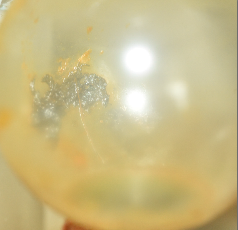

So here is my results, keep in mind i think i have a pic missing! seems to have been a camera mishap with a setting.
The amount of nickel used was roughly 1g, i didnt measure as it is simply a test to see if nickel would dissolve in ferric chloride.
In the other thread i cant find i did post the strengh of ferric chloride, but cant find it now. Anyway its about as strong as you can buy commercial
ferric chloride.
I used around 50ml - 100ml, i dont remember and again did post it before. Again dosnt matter as you will see.
I acidified with 36% HCl, i used 2-3ml as the ferric chloride claimed it had some in anyway, the PH on paper indicated i hd dropped the PH to around 2
Because the blog said add a amine i am not sure why but i added 32% Ammonia, not much but this is what happened.
Not good!

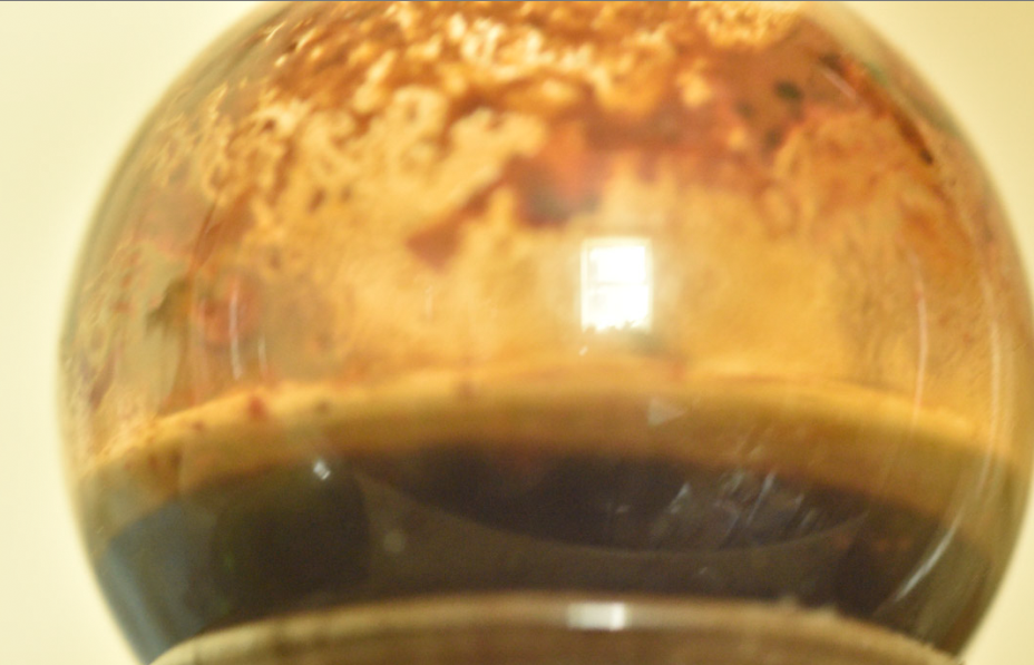

So did it again and didnt add ammonia, 4 days later there was still a little nickel left
And what looked to be an extremely brown liquid! I didnt take a pic of it but it did look very much like this one with the exception there wasnt much
orange stain around the top.
I decided to take some of this liquid and simply add water, i didnt measure the amount because i thought it had all failed, was adding water so i
could see how dark it actually was. What i got was the following!
I am wondering if that is good enough to use to plate Nickel onto things? I can deal with chlorine and gasses by my normal pass through a one way
valve and wash bottle technique.

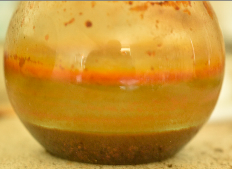

The reason for asking is i tried to drop out any iron or maybe even the nickel chloride by complexing with Ammonia, however even adding two small
drops from a pipette gave me the following
[Edited on 10-6-2018 by NEMO-Chemistry]
Before anyone jumps on me, i know this wasnt very scientific, but i did it as quick to see if i could get any Nickel chloride, Nickel is expensive and
having tried various methods to dissolve into something i can use to plate with hasnt gone well.

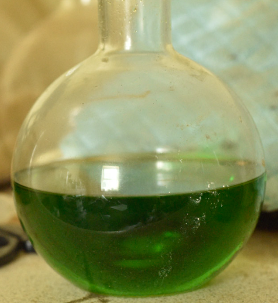

The first time I made nickel salts I just electrolysed household vinegar with some nickel 99 welding rods. I fully submerged the anode and just left a
cm or so of the cathode in the vinegar. Over a couple of days I was left with a nice dark green nickel acetate solution that I was able to plate from.
To speed up the process I would crank up the amps until the solution would get too hot and swap the electrodes to even out the erosion. The watts
nickel bath works much better but the acetate solution was functional.

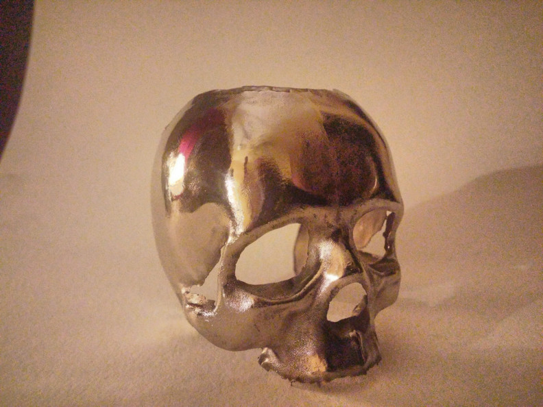

The trinket in the attached image was electroformed over a graphite coated wax form using the watts sulphate bath. My electrodes were baskets of
chopped up welding rod zip tied to a graphite gouging rod. It is about 1/2 - 3/4 mm thick and stands up to aggressive polishing. My next step is
nickel crucibles.

thats fab!! acetate i can do i got flakes but got a combustion tube with small hole in bottom of a test tube like thing, so nickel in that and a
cathode should do the trick even if slowly. will look up whts bath
Thx
i really love that skull!
