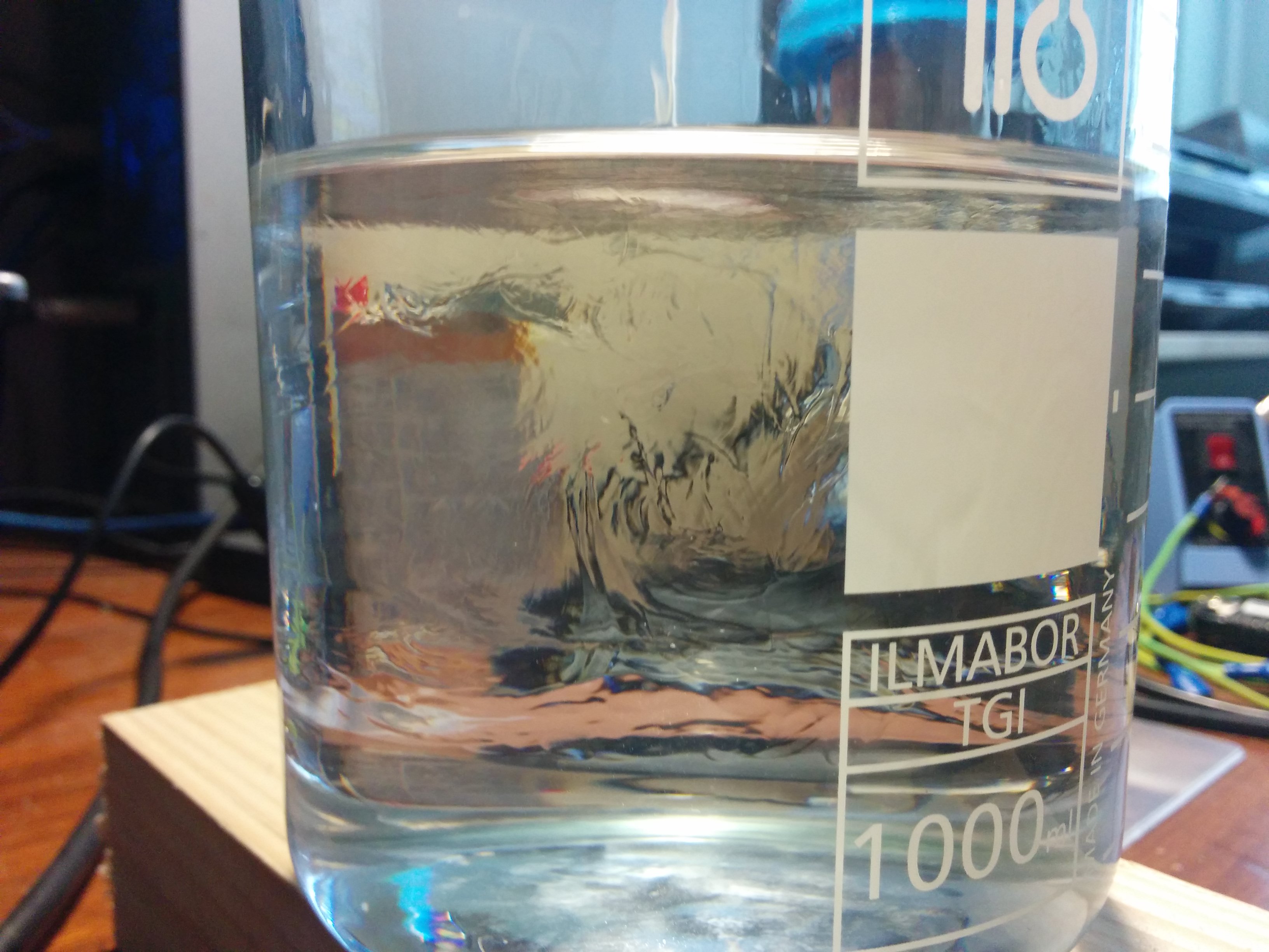

Hi,
I needed some toluene but since it's hard to get it in pure form in my country, I purchased 1l bottle of paint thinner, that has toluene and acetone
in it - that are the only two ingredients that were listed on the bottle label, but I think there are probably some other compounds in this mixture.
Toluene and acetone are probably just the main two ingredients (that are present in largest quantities)...
So, I distilled the thinner and when the temperature got to 111°C, there was about 25-30% of the liquid left in the flask (if there wasn't any other
compound with higher BP than toluene's, that should be pretty pure toluene, right?).
And here goes my first question: distillation started at about 66°C, but shouldn't it start at 56 (BP of acetone)? I know that mixing some compounds
can change the boiling points, but does that happen in this case too? Also, at about 70 or more deg. C, I noticed the phenomenom on the picture,
below... Don't know what it's called, but this is where I think the second (mysterious) compound, with different density started to distill. Am I
right?
Second question: when you have a mixture of let's say toluene and acetone, why doesn't all of the acetone distill at it's boiling point, instead of
gradually increasing temperature, when there is still acetone in the mixture? Is that why we can't distill compounds with BP's closer than 20°C
together, without using fract. column?
Thanks for your answers! ![:)](./images/smilies/smile.gif)
![IMG_20150930_114014.jpg - 769kB](https://www.sciencemadness.org/whisper/files.php?pid=421246&aid=44002)
[Edited on 1-10-2015 by xfusion44]

Quote: Originally posted by xfusion44 ![](images/xpblue/lastpost.gif) |
I noticed the phenomenom on the picture, below... Don't know what it's called, but this is where I think the second (mysterious) compound, with
different density started to distill. Am I right?
You are probably right, however it may just be that your condenser is either hotter or colder than room temperature. Some liquids, (such as sulphuric
acid) changes densities very significantly at different temperatures, so those distortions could just be due to your distillate being a different
temperature to what is already in the beaker.

Quote: Originally posted by Deathunter88 ![](images/xpblue/lastpost.gif) | Quote: Originally posted by xfusion44 ![](images/xpblue/lastpost.gif) |
temperature to what is already in the beaker. |
Well, that could be possible. I started with ice water, which probably warmed up significantly after distilling about 600ml of liquid at 66-111°C.
The distillate smelled pretty much like acetone, so the acetone is most probably large part of it.
Thanks!

Washing as Praxichys sggested certainly works.
I followed that advice and the two layers separate almost instantly.
