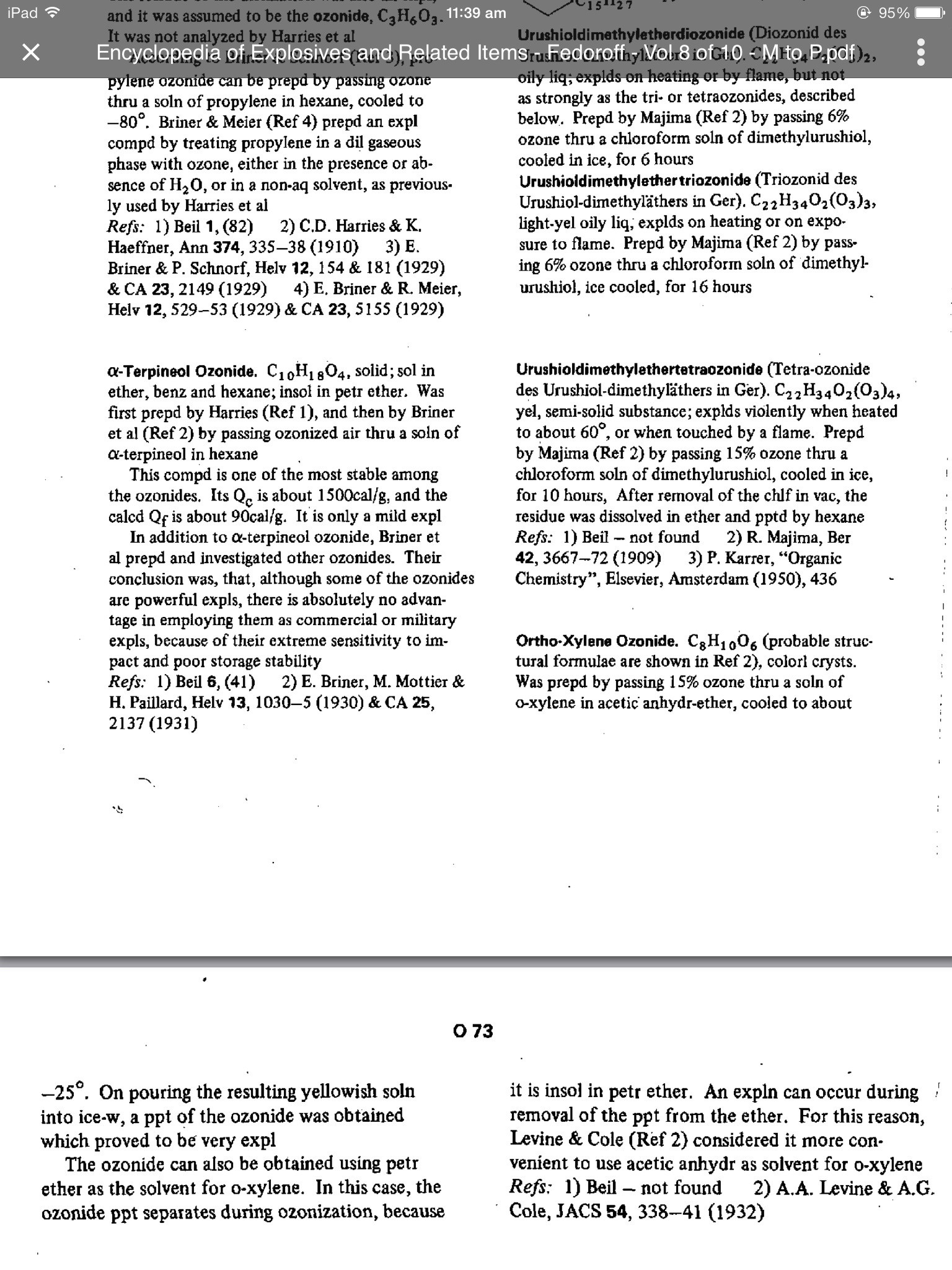

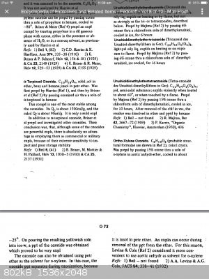

Oh forgot to add the picture, this should add a bit more context to what I'm trying to do
image.jpg - 802kB

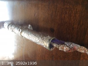

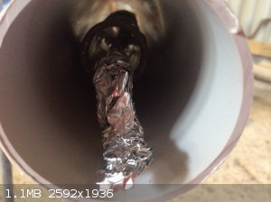

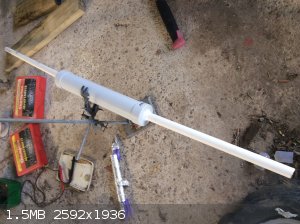

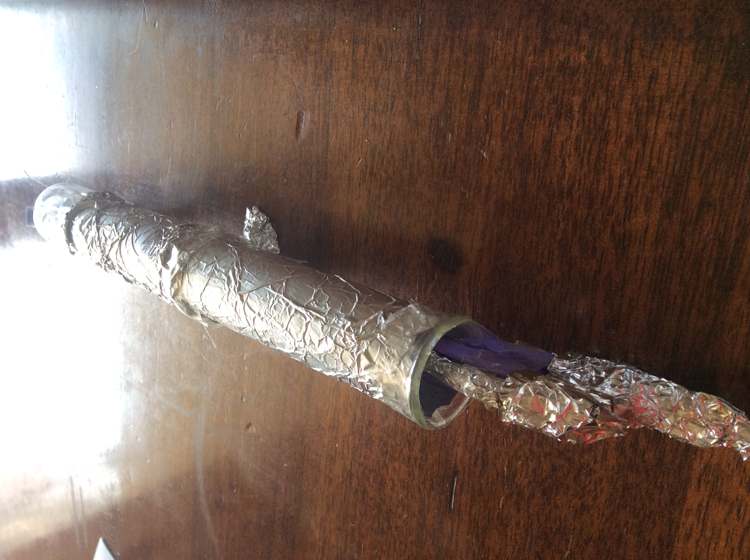

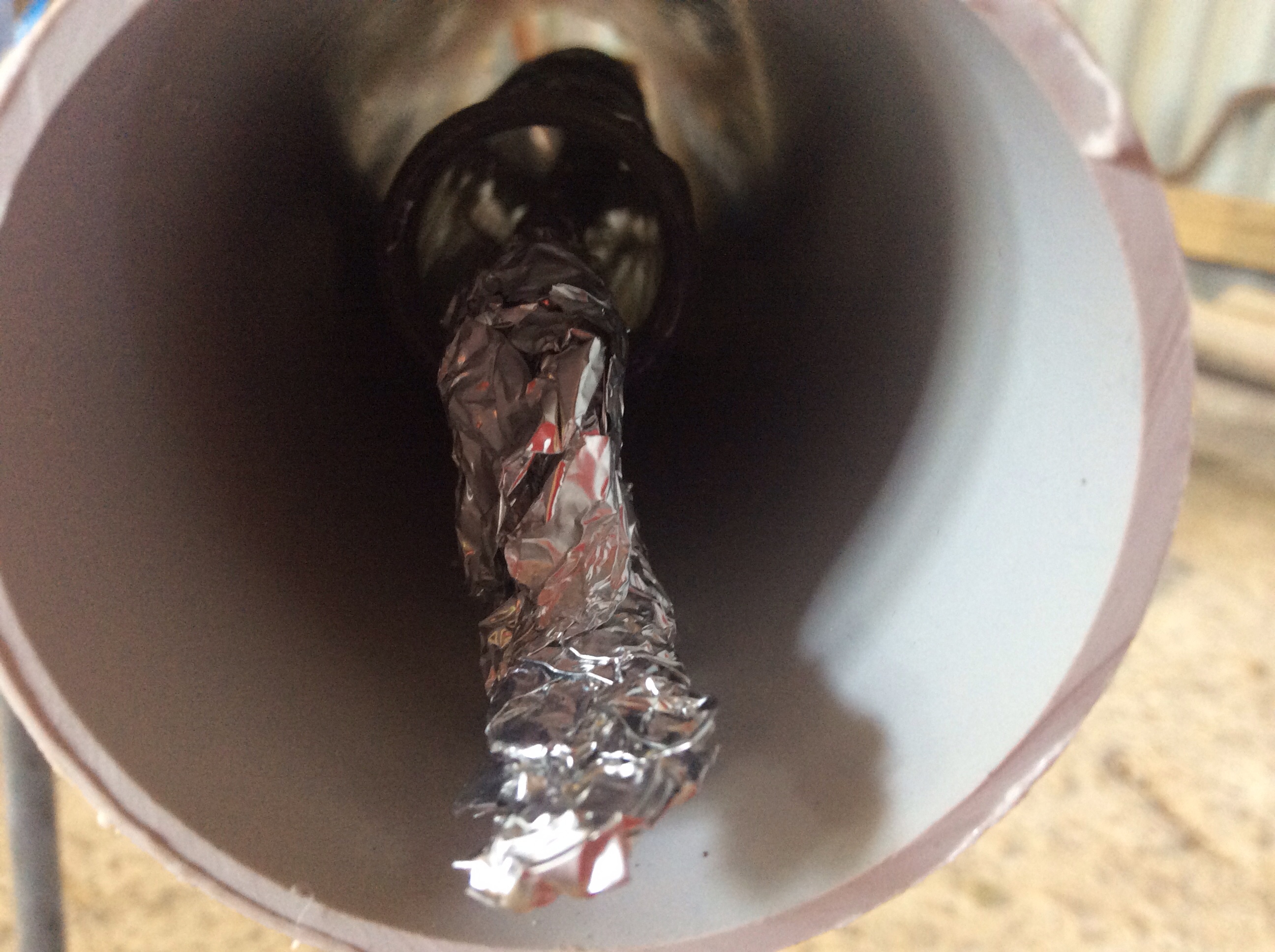

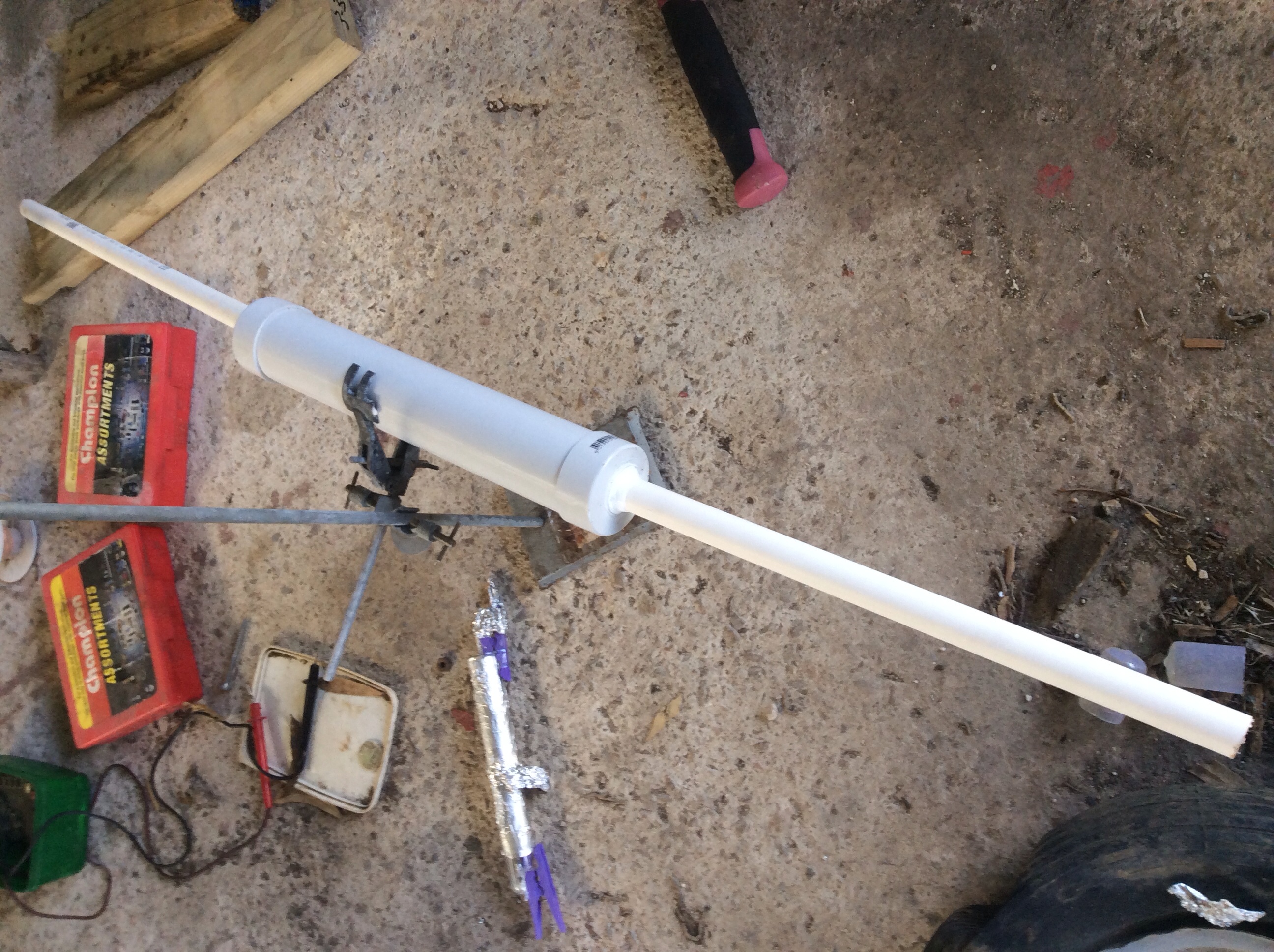

So I've decided this is going ahead. A air compressor is to be used to pump the air through the PVC tubing holding the coronal discharge. A transformer has also been found, and wishing a few days the ozone generator can have its first test run.
The al foil is to be connected to the transformer via two screws sunk through the PVC.
I also have a litre of what seems to be quite pure xylene, and have seen that it is soluble in butane.
image.jpg - 1.3MBimage.jpg - 1.5MBimage.jpg - 1.1MB

Sorry Tdep, if the top pic is of the putative plasma generator, it looks a bit crude?
It's important to have a uniform spacing (~3-4 mm) between electrodes to prevent a full discharge occurring!
There are various generator designs you could google . . .
Tdep
Posts: 519
Registered: 31-1-2013
[*] posted on 28-9-2014 at 03:06
Haha fair call. I should've probably waited until I tested it before posting.
It looks crummy because of the al foil, but it's really the best metal to use because of the passivation (right?)
I'll test it. If it arcs between electrodes, well then I'll have to redo it
