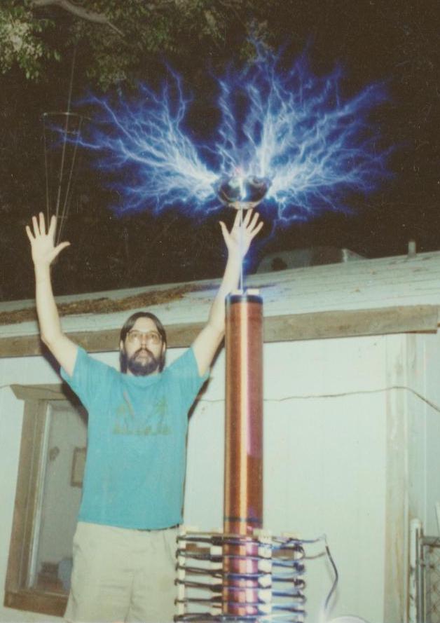

Thanks for the compliment. Believe it or not it only took under 3 hours to wind that 6" PVC pipe with Litz wire for a length of 5 feet. I perfected my method of winding giant coils by hand using a rotating arbor mounted on two saw horses.

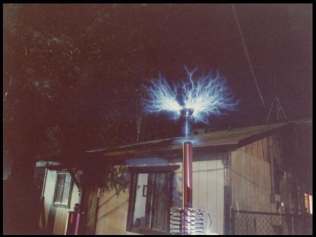

t61.jpg - 43kB
I built an extra coil about 3 feet in diameter which you can see on the ground by the front door which I later mounted in the air connected to the top of the Tesla coil. Took a while to wind that one.

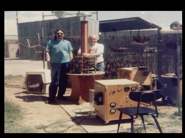

t62.jpg - 54kB
If you look closely at the front of the box (chair in front) you can see where my now DOA Variac used to mount. The guy in the white shirt is Robert Golka which you have probably seen on some old Nova show about Project Tesla, but that is another story. Right behind that box is a bank of three 0.02 uF 120,000 volt Plastic capacitors mounted on Plexiglass supports.
