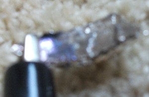

Element collector I mean the blue, magenta, golden, etc colors get stripped to what appears to be the elemental metal. Here are two awful pictures to
demonstrate. The first one is the blue pretty bismuth oxides, the second is the partially electro stripped material. (note black cable for
anode unless I wired my PSU wrong which I doubt...)

Maybe it has to do with the way the oxides are layered generating the different spectrum of light adsorption. Then when I apply the current it fully
oxidizes them removing the color. The metal doesn't look dull or gray neccesarily but it could be more dull then fresh metal.
