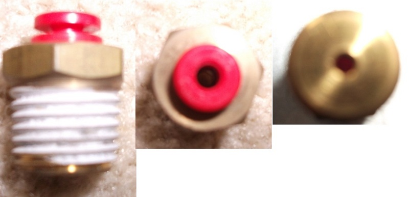

Here's my experience with vacuum pumps. I had a fridge pump once, it gargled up the water in it's ice-water bath and died :D/:(. Though a few weeks ago I bought a rough vacuum diaphragm pump(~200mbar), previously I've relied solely on a water aspirator. I think it'll suit my needs for simple tasks such as vacuum filtration, and basic solvent removal. Won't be ripping any DMF or DMSO or anything, probably things like ethyl acetate, THF, dichloromethane (wouldn't want a fine vac for that anyways), etc. Not really lacking the theory on vacuums or anything not to say I'm an expert but the practical stuff is where I need some advice.
Anyways, I read the manual for it(provided by gast) to see what kind of in-let it uses as I am confused about the in-let that was provided. It's a 1/4 NPT thread but it's pretty peculiar I'm not sure what its function is. It had a two part red 'nozzle' thing that says 1/8 which I believe represents 1/8 inch for its outer diameter and it also says "SMC". Edit- it's actually a bit bigger then 1/8 inch so that theory is gone. On googling "SMC" or "1/8in SMC" shows pictures of cameras and dozens of other abbreviations.
Should I be trying to find a 1/4 NPT nipple connection to fit on some hose and replace this piece altogether, or should I be trying to fix hose to this weird red thing? A picture is provided. Any advice or guidance is much appreciated as always.

This won't be of much help... just my opinion, but I think a hose barb would be the easiest replacement. Actually what is that red thing anyways?
I recently bought a vacuum pump as well and had to hunt around for a hose barb adapter at Home Depot and found one in the plumbing section... Installed it on the pump and no problems so far. Could it be that the red bit is some sort of filter for particulates?
One thing I also found at the good old Home Depot in the air compressor accessories is an in-line filter to trap micro fine particles from entering your air tools, I bought it and it can hold a vacuum and works well. Not like I tried to vacuum shit up just for fun, just saying, it might be worthwhile if you need a filter of some sort.

Home-depots web-site didn't show too much promise.
Nope, the site is very poorly built :S Go to the section where clear plastic tubing is sold (near the toilet stuff in my local store) and you will find a huge variety of valves, adapters, hose barb adapters with threads inside and outside etc. Otherwise check the air compressor accessories and they have some, although not as many, types of hose barb adapters.

Thanks mailinmypocket just went to the hard-ware store got the right sized fitting did a quick wrap with some teflon tape and screwed it in. Works a treat. Also scooped up some DCM :)

That red fitting is called a push-to-connect fitting. You simply push in a hose of the correct diameter (1/8" OD for your fitting), and it is sealed by an o-ring and held in place by a (usually) stainless grasping ring. To remove the hose, you push down on the plastic ring, and pull out the hose. These fittings are common in compressed air systems, but leak like a sieve under vacuum.
