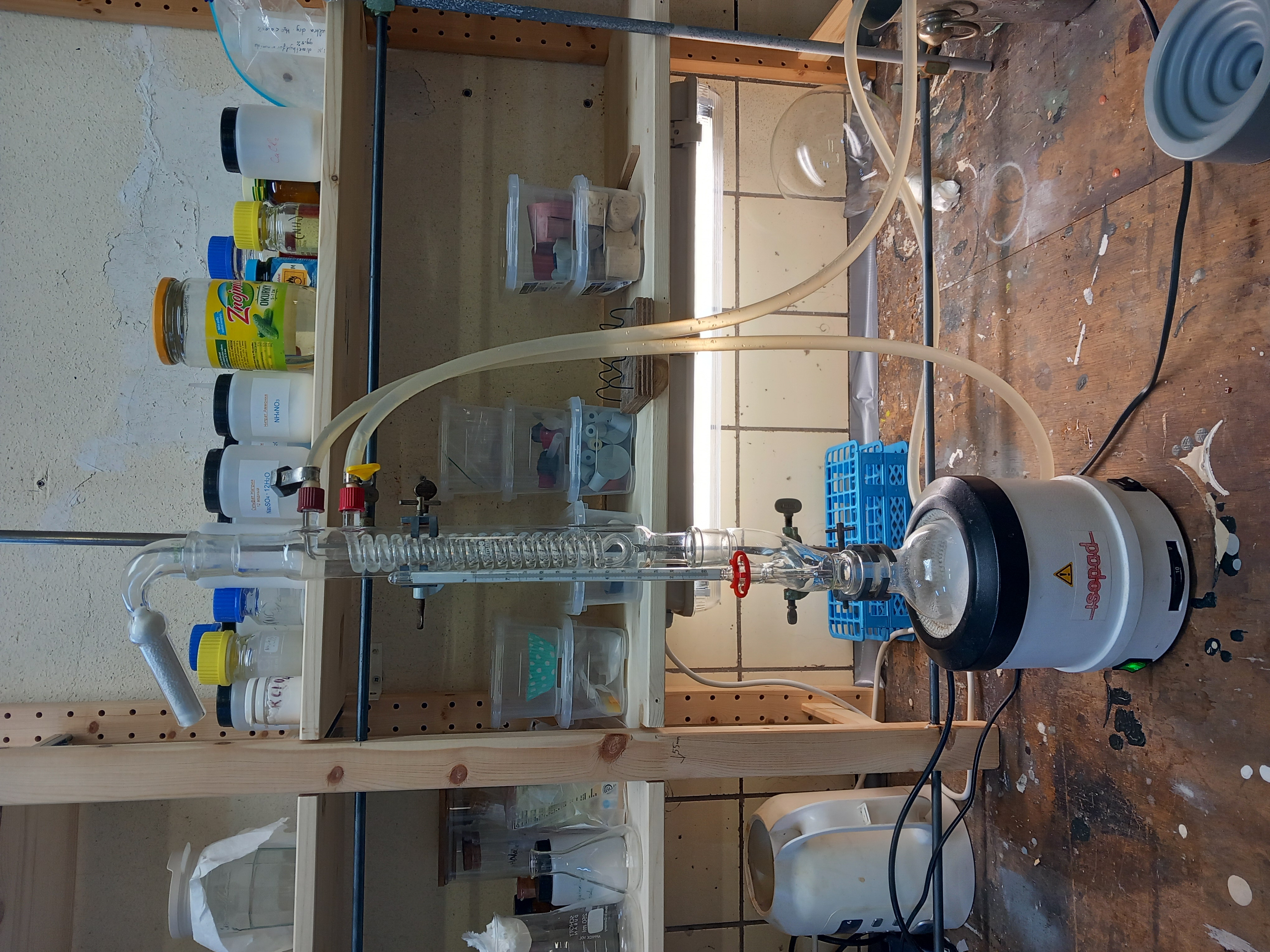

teodor
Posts: 1001
Registered: 28-6-2019
Quote: Originally posted by woelen  | What I read from your posts is that heating (actually fairly strongly) is needed for drying, and that is a very important difference with many other
drying agents (e.g. P4O10, CaCl2, NaOH, CaO). It makes the use of this drying agent for the average home chemist much more difficult, especially
because it also attacks glass quite strongly at the temperatures you mention. |
My last experiments I did in the range 114-125C in the boiling anhydrous acetic acid media. At this range it can act with differet speed depending on
the compound. It much more eager for sidium ions than for hydrogen ions. So it cannot dehydrate acetic acid alone but it can dehydrate e.g. sodium
acetate solution in acetic acid (fast). The boiling point suggest I was probably able to get 20% acetic anhydride solution as the result of sodium
acetate dehydration at temperature lower than 125C. I continue quantitative part of experiments and if there is at least your interset I'll keep you
informed.
As for aqueous acetic acid it can dehydrate it to 100% where equilibrium between hydrogen pyrophosphate and the acid doesnt cause further dehydration.
This is during several hours and not minutes as in the case of NaOAc.
I think it would be possible the same way to dehydrate some salts if they are soluble in AcOH and not decomposing by the action of metaphosphate. (And
this IF is a very big one. Most of compounds are decomposing by metaphosphate fusion. The question is - at given temperature).
But ones need a reflux setup for such kind of experiments.
The compound in the acid media acts in solid state (Graham's salt is not soluble in the acid), so I don't think it can attack glass.
The product of the reaction (e.g. Na4P2O7) could be soluble. I can check what is the dry residue after I will evaporate acid. But it is not the first
priority. I try to find the most optimal way to dry the compound itself because adsorbed water percent is quite high and part of its power is wasted
to self-dehydration. Which is probably not happening below 100C. That's why I said it is the peculiar drying agent, it can coexist with water at room
temperature.
Boiling in AcOH dehydrates it but then you need much excess for the primary reaction.
If you ever thinking how I can get the amount of water adsorbed - easily, by the acid boiling point drop.
And yes, woelen, you got the point of my latest experiments quite right - the temperature and (re)usage of glass. I can confirm - even suspension at
112-125C works great.

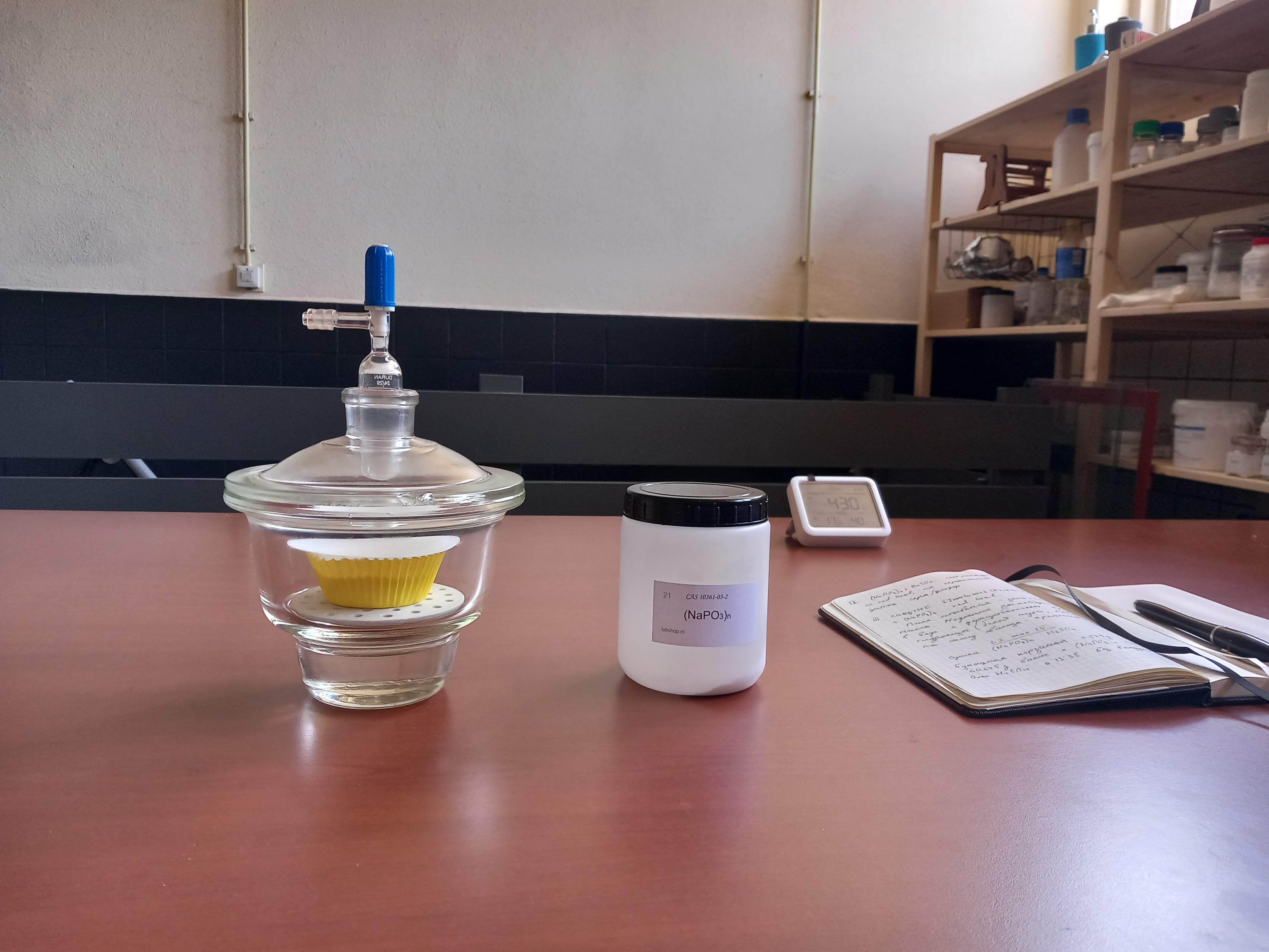

So, according to my preliminary results and thinking the most serious problem is the equilibriums
2 NaPO3 + H2O <-> Na2H2P2O7
NaPO3 + H2O <-> NaH2PO4
For drying of crude hexametaphosphate I can imagine several ways:
1. By heat. Drawbacks: could change the chemical properties.
2. Dessicator over H2SO4. I think anything more powerful is more expensive or did I miss something? I don't want to dry a drying agent with more
expensive drying agent, it is a nonsense. Drawbacks: none.
3. Washing with AcOH. Drawbacks: only for reactions with AcO-, other reactions would require drying from AcOH.
4. Reflux with AcOH. Drawbacks: equilibriums mentioned at the beginning.
5. Azeotropic distillation (benzene, alcohol, hexane etc). Drawbacks: possible dehydration reaction with some compounds, the solvent residue should
not interfere with further experiments.
I would check all those ways, but having limited time today I started my experiment with the option 2.
The weight of the empty "pralinevormpje" is 0.529g and together with (NaPO3)n (bought from labshop.nl) is 60.645g.
Let's check the mass change in few days.
[Edited on 22-3-2025 by teodor]
