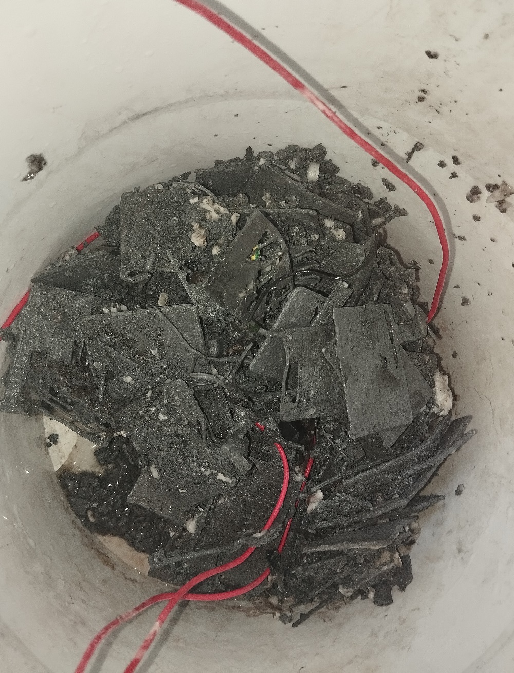

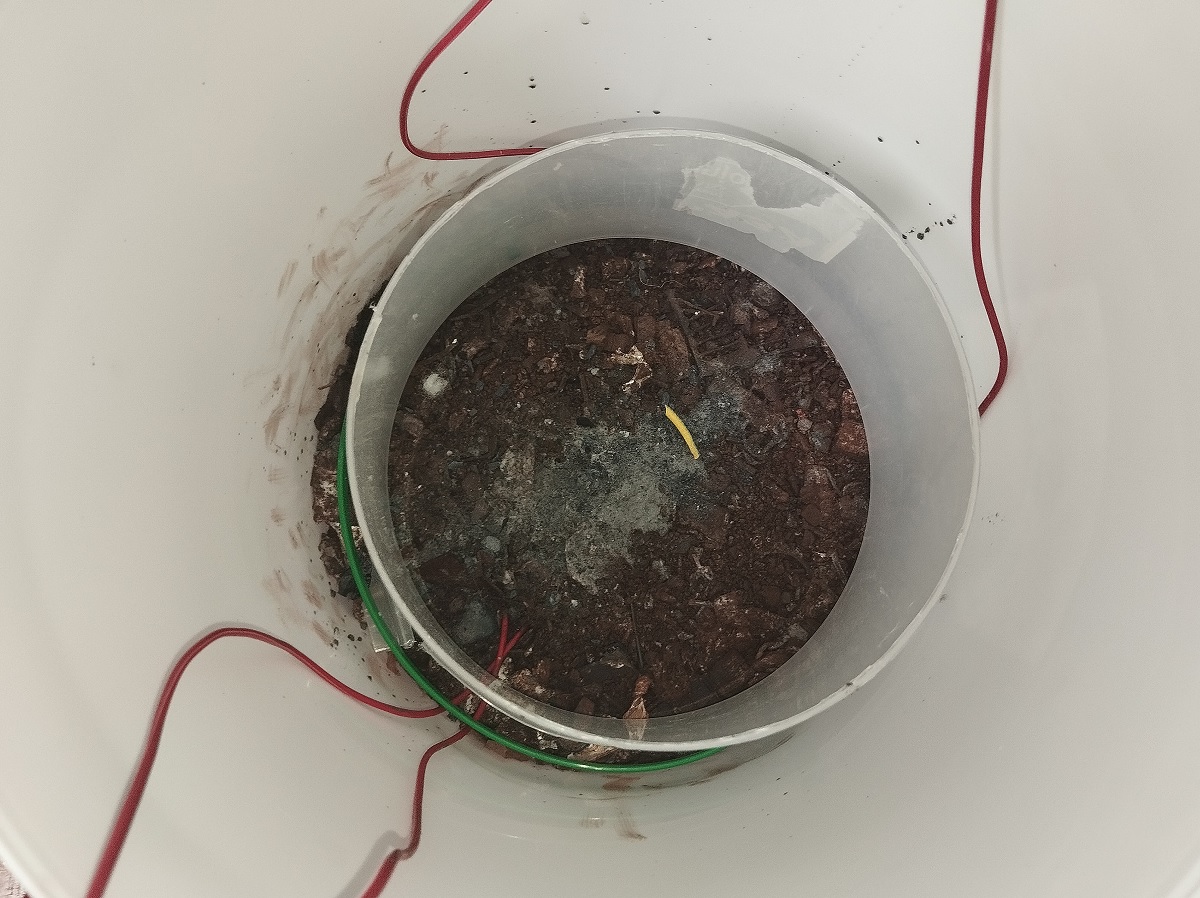

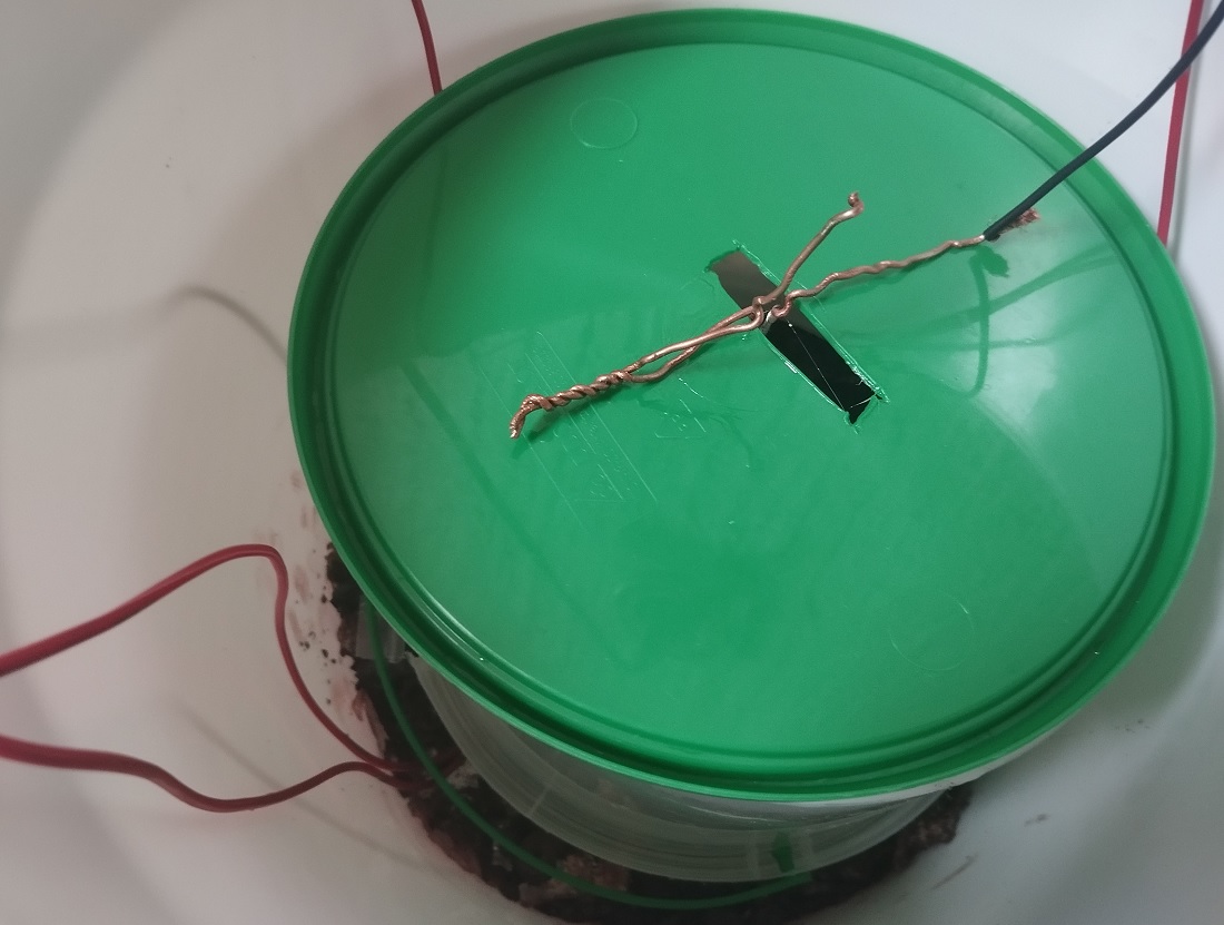

After that, the second stage began. Partially restored negative plates were placed in a layer in a 10-liter polypropylene container. Copper wire was attached to 4 of them. A layer of whole positive plates was placed on top of the negative plate layer, and at the very top, a powder of resolved positive plates. The result was a layered pie that was slightly compacted. The anode was made in the same way as in case 1 and a contact was soldered to it, but it was insulated with varnish to protect against corrosion. The cathode pie was filled with electrolyte after electrolysis of the plates, but diluted by 2 times to cover all the powder and space for the anode. (See photo)

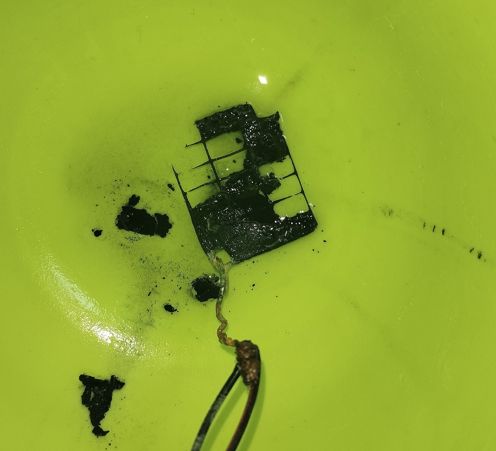

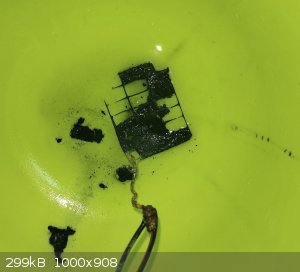

A voltage of 5 volts was used for electrolysis. So it was 2 amperes at first, but after 3 days it grew to 4.3 and remained so until the end. On the 3rd day, hydrogen began to be released on the cathode, but the process continued for 6 days for complete conversion. The contact to the anode held up, but the anode almost fell apart (see photo)
In theory, you need 50 ampere hours for 300 grams of lead sulfate
After electrolysis, the electrolyte was separated from the cathode, and the cathode mass was washed with water. You can see it before and after. A lot of spongy lead was obtained, as well as some sulfuric acid. Spongy lead can be melted into an ingot with a flux and a reducing agent.
A destroyed anode can be restored in the same way. During electrolysis, a noticeable amount of ozone is released, especially at the end.

There were 4 kg of powder not 3. Destroyed anode was recovered by same way. Sediments from the wash waters were also recovered with the anode.
