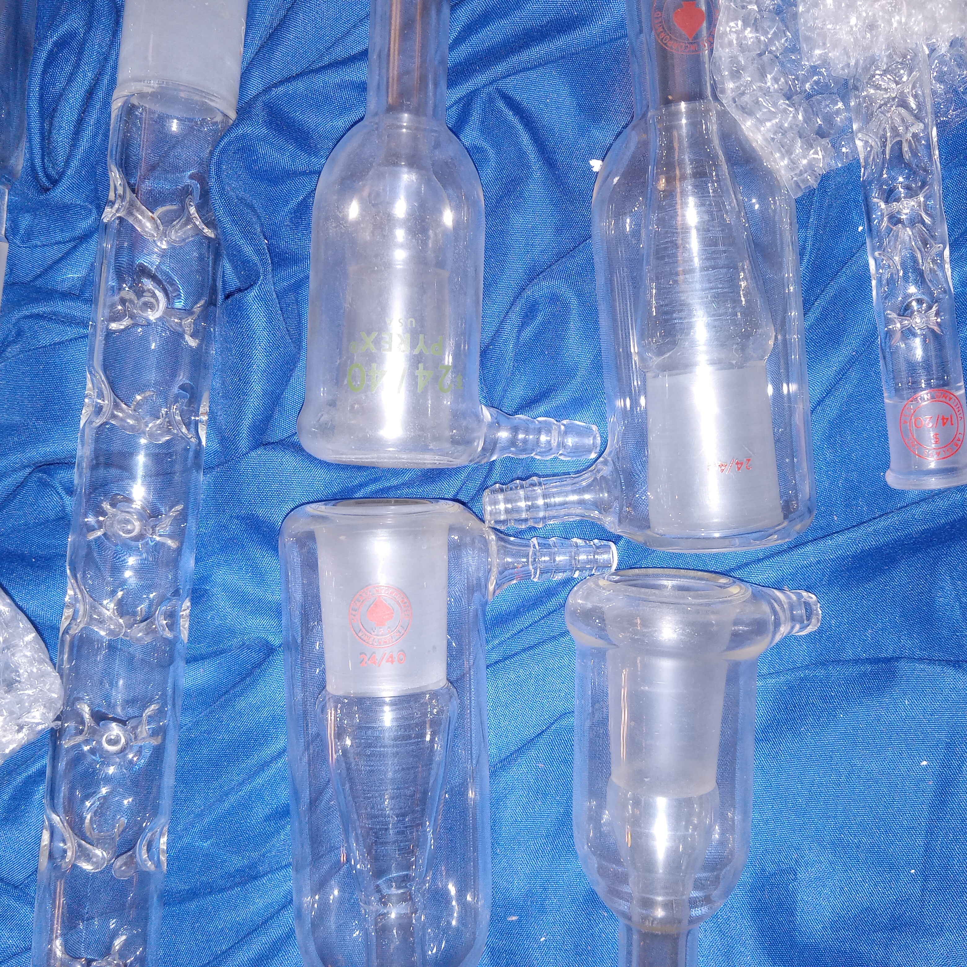

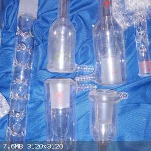

I bought a lab glassware lot and id like Thoughts on the condensers that are jacketed over the female joint portion
Is the jacket over the female portion of the condenser good or bad I ask cause I see they don't really make a lot of them Like this now and my thought other than cost of making it like that is the thicker glass being cooled same rate as thinner glass could be reason for structure failure just my ìnital thought without having done any research cause I know things like this books only say so much it's the experience that tells it all......good or bad with the amount I paid for all the condensers i received ill make money and have a few choicè pieces LMK if anyone would like to see all the glassware

No system to fasten one piece to the next, (eg Keck clips, springs, threads etc.)
otherwise quite interesting.

I can't think why that would be good but I also can't think why it would be bad except for what Sulaiman already pointed out (no easy clamping position). Maybe it might help with joints seizing? Or if it stays cool around the joint then your joint grease is less likely to flow out (viscosity gets lower with temperature).

What do the rest of the condensers look like? I've had takeoffs that connect to distillation heads that are jacketed like that so that highly volatile materials will be remain condensed after they come out of the distillation head. As for clamping, throw a rubber band around the nipple and over your glassware.

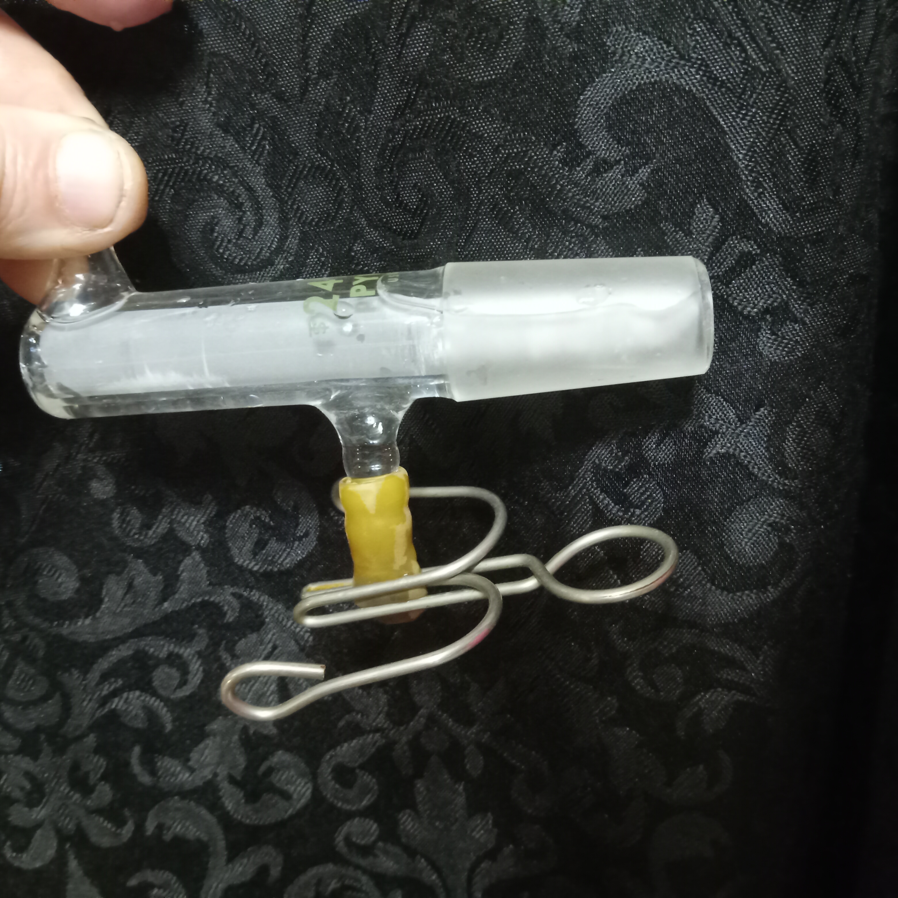

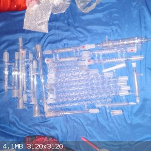

Here is a pic of a small condenser that has only a male end but the coolant is able to go to the tip of the male joint. I'm not sure if it is a production piece from pyrex or if it is just a salvaged broken condenser that has had a barb put on and sealed by an experienced lampworker. I'm thinking the latter because the condensers that have the big coolant jacket over the female joint are also like that ( coolant able to go to the tip of the male joint). Also attached is a pic of all the glassware, that I bought in a single listing on eBay for brace yourself.....$120US .....even though it was not what I was needing to get. i just could not pass it up. I figured that I could sell most of it. keep a few select pieces and have a few more dollars than I originally to started with, to get that big azz RBF I need and mabey a few chems I want. Hopeful thinking

The item on the right is just a cooled stirrer shaft. The shaft can generate heat so they sometimes are cooled that way. It is not useful as a condenser by itself, just a way to keep the shaft from heating up, still need to oil or grease it also. The hole should be 10 mm most likely.
That is a great haul of stuff or $120. Happy to swap a few things if there are items or chems that you want to swap condensers, Vigreuxs, or other stuff for.
