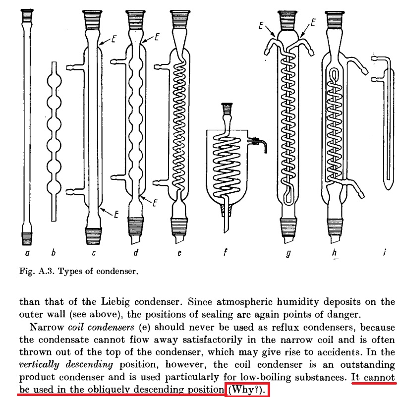

Hello folks,
another question:
In another part of the book "Organicum, practical handbook of organic chemistry" it is mentioned that coiled condensers cannot be used in tilted
positions and the book asks "Why?" is there anyone who knows the answer for this question?
Condensor type "e" is under question
[Edited on 11-9-2024 by sarinox]
Posts: 2701
Condenser "E" is a Graham type condenser, and since the liquid condenses in the inner coil, the liquid has to drain from the coil via gravity. If you
fill a section of the coil with liquid, it will pool and prevent vapors from moving up the condenser in a smooth flow, this building pressure up,
which can cause the joints to leak vapors. Like a sink trap, which is meant to prevent gas flow, the coil will stop vapors from moving well.
Condenser "b" and "D" (Allihan condensers) are also poor using at an angle, as they hold liquids, and create a non-smooth flow of your product, and
also prevent vapors from seeing the cold part of the condenser. The other condensers all have the condensed liquid flowing on a smooth surface where
gravity can bring it to the outlet OK, except i, which is meant as a trap and used to collect material with itself. But they have limited capacity.

Hello and thank you for your reply,
So, I cannot use d in tilted position or I can but I would lower down the yield?
You know currently I don't have equipmentss to use the condenser d in vertical position.
-Sarinox

Quote: Originally posted by sarinox | Hello and thank you for your reply,
-Sarinox |
I have used "d" (Allihn) condenser in tilted postion without problem. Although some "pools" of destilate will form (thus reducing the cold surface),
if you compare it to "straight" - C - Liebig condenser, for the same lenght, I think that the Allinh condenser has more cold surface, because a sphere
has more surface than the wall of cylinder (or tube) of the same height.
But maybe Im wrong. - because is the only condenser Ive got....
here is some more information:
The Liebig condenser is used only when the vapor rate is relatively low or used diagonally downward for distillation. The Allihn and Dimroth
condensers are more favored in reflux or redistillation, and the Dimroth condenser could offer better condensation efficiency.

Rainwater
Posts: 901
Registered: 22-12-2021
I believe "E" & "F" are graham style and are best used vertically unless you have a method to force the distillate through the condencer.
A pressure gradient caused by applying a vacuum and using a cappallery as a bubbler to prevent bumping is the best example I can think of.
Since learning how to use a graham to control reflux takeoff, I mostly use this in conjunction with a "G" for really hard to seperate mixtures.
Graham's are very useful when you have a compound that likes to supercool before condensing. Like butane, or when there is the need to maintain a
large thermal load in the distillate, like in a stripping column.
Sometimes, it is undesirable to use coolant far below the boiling point of a compound and a coolent will be just a few degrees below the distillate
temperature. Thermal transfer is directly proportional to the temperature difference between the two mediums, resulting in degraded performance. A
graham makes up for this with a larger surface area.
[Edited on 12-9-2024 by Rainwater]
