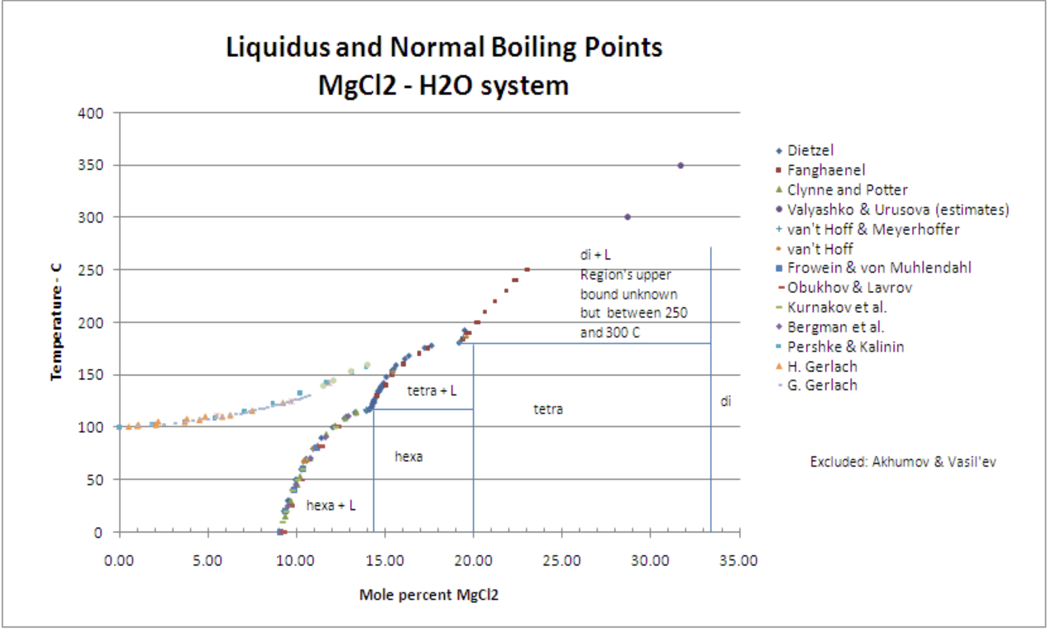

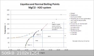

[*] posted on 11-9-2024 at 10:46
So it appears that you can get to around 150 C, although you may need to keep replenishing the water.
