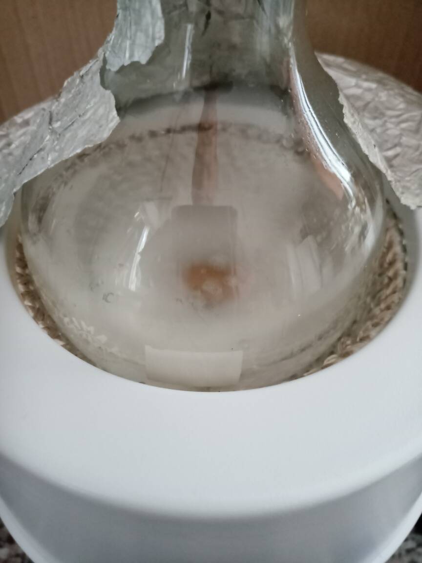

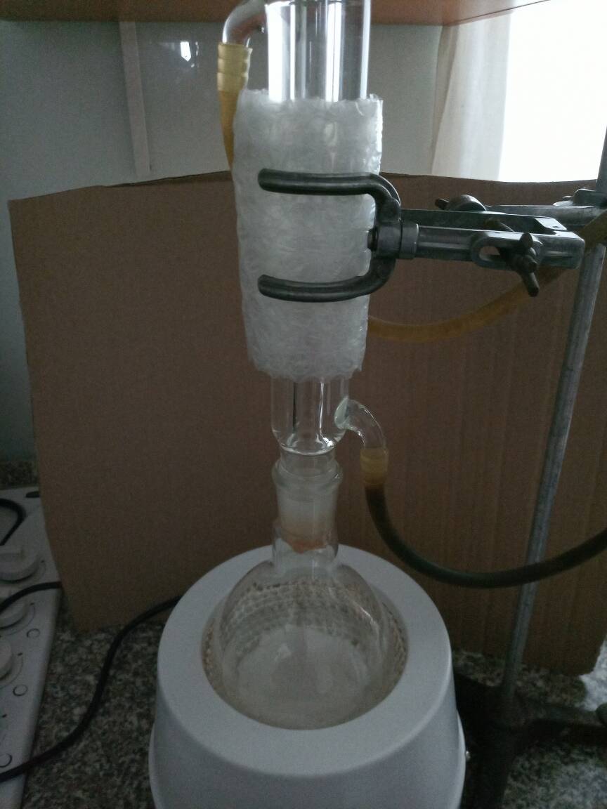

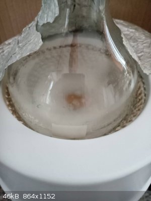

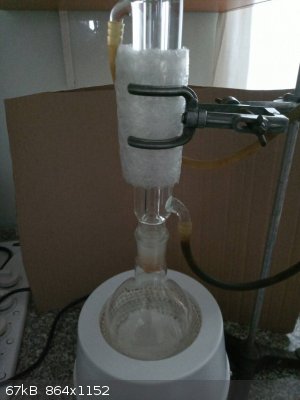

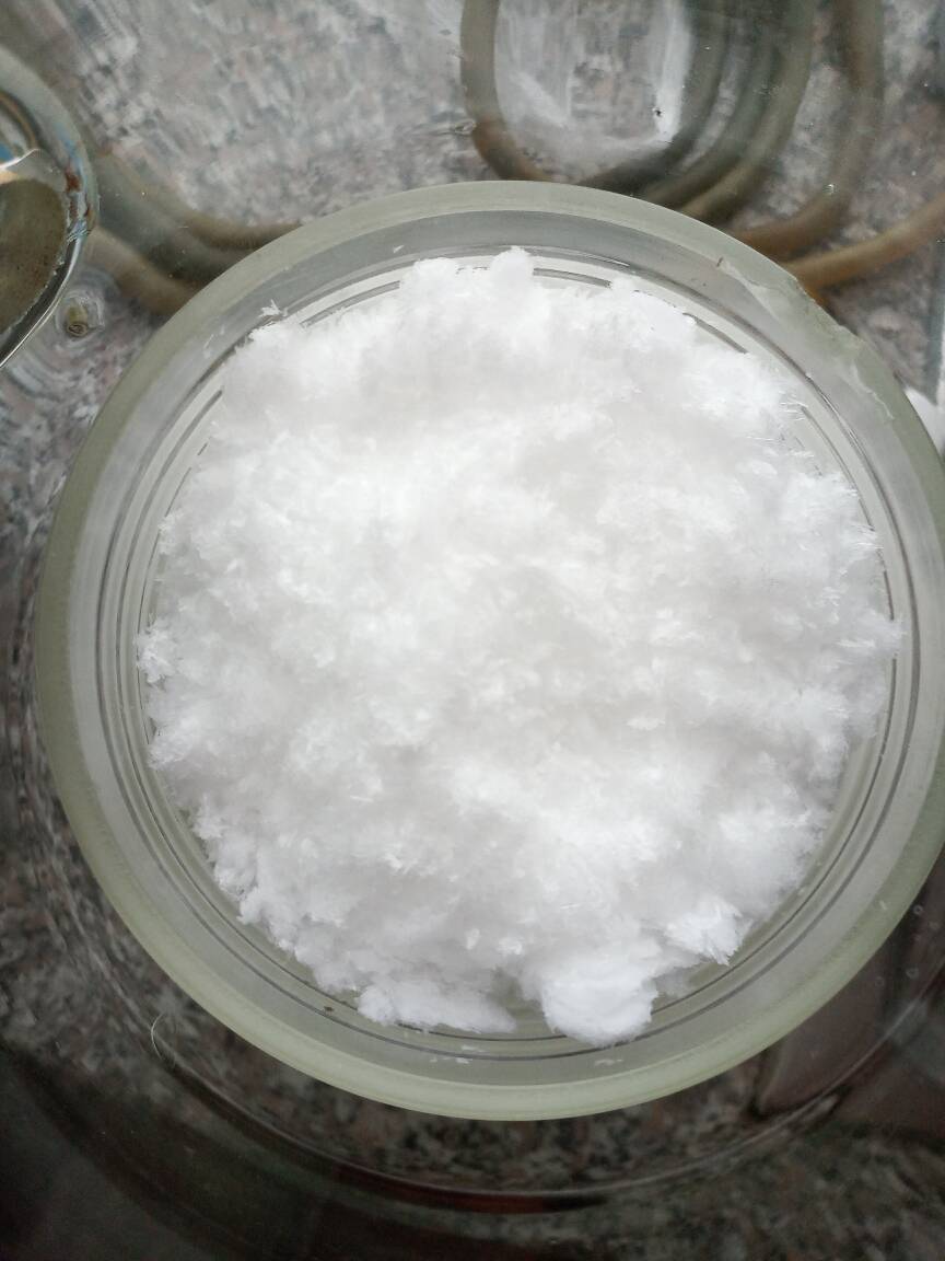

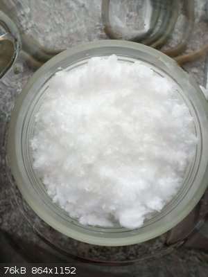

So I did a quick try of the reaction between methanol and amidosulfonic acid into ammonium methyl sulfate.
97,1 g of amidosulfonic acid (1 mol) with 200 ml of methanol was put into 500 ml RBF and magnetic stir bar. The methanol used contained only very
little of H2O (max. 0,05%), its volume was in excess but later the volume shown to be the right amount. Reflux condenser was attached with drying tube

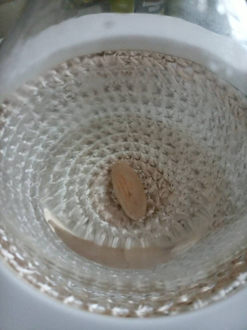

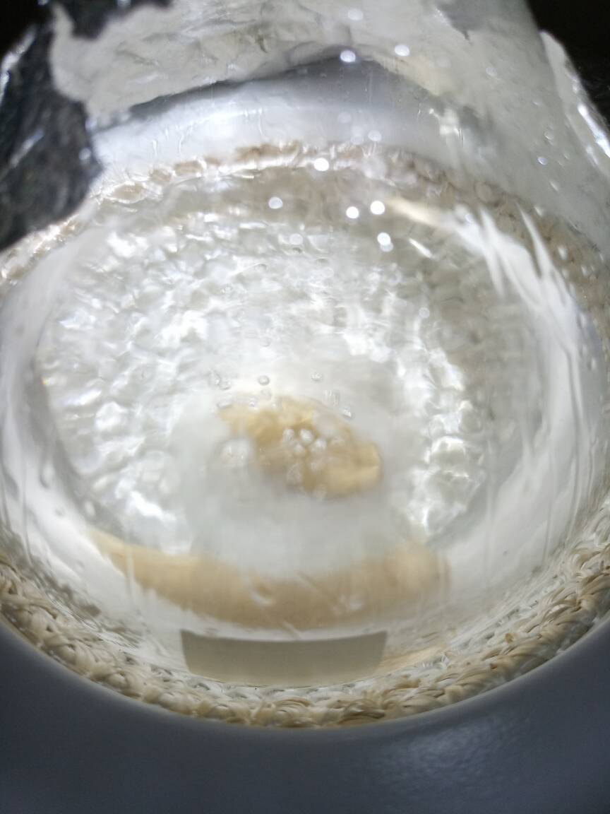

to prevent moisture from air to enter. The reaction was heated and magnetically stirred. The reflux lasted totally 6 hours from which first 3 hours

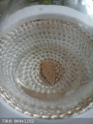

the stirring was impossible and only after 3 hours when substantial amount of sulfamic acid reacted the stir bar started to rotate finally.

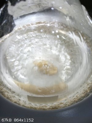

After 6 hours of reflux (from which 5 and half hours there were visible crystals and only last 30 minutes the content was fully dissolved) the heating
was stopped and the content was allowed to cool down to room temperature. The solution stayed clear due to its supersaturation. Only after vigorous
stirring for few minutes the supersaturated solution crystallized quickly. The condenser was detached, flask was stoppered and put into a fridge to +4
C overnight.

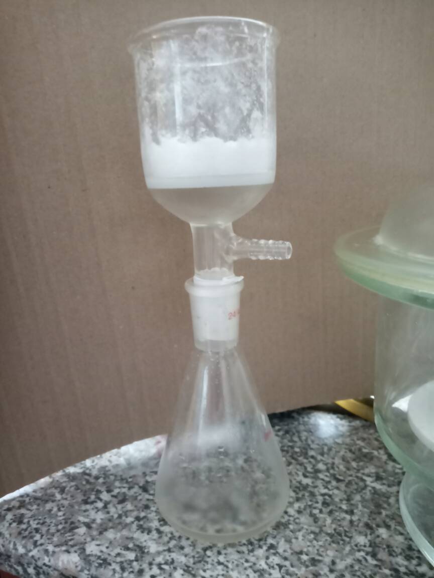

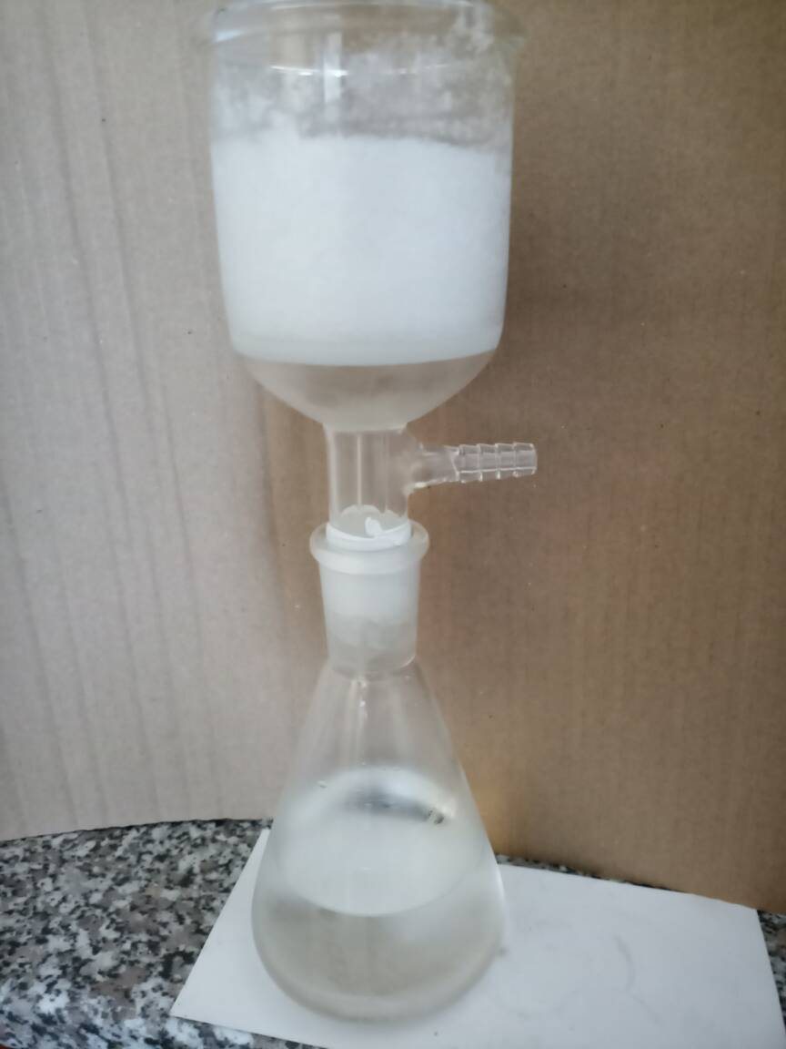

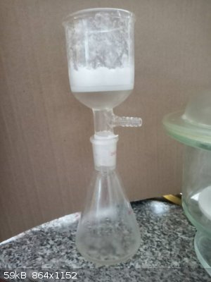

Crystals were filtered on sinter, dried for a while on sinter using suction (it was necessary to press them into about half of their volume using the
reversed side of a stopper, also take in account they are hygroscopic so do not suck them for too long) and then further dried in a desiccator over
anhydrous CaCl2. Crystals were very fluffy, their volume was about 200 ml when scraping them from sintered funnel.
Mother liquor was put back into 500 ml RBF and 100 ml of methanol was distilled out. The same crystallization process was repeated and the crystals
(cca 3 times less than the main crop) were added to the main crop and dried in desiccator. From the second filtration the volume of mother liquor was
30 ml so approximately 50 ml of methanol was lost during vacuum filtration + adhering on the crystals or maybe forming some adduct. The product was
hygroscopic which was visible on their remainders when cleaning the glass.

methanol, very low water content (max 0,05%)
amidosulfonic acid (if using not much pure acid especially with insoluble impurities then very likely no supersaturated solution obtained)
reflux, a lot of acid on the bottom of flask which denied stir bar to rotate for half of the reaction time
after 3 hours of reflux a lot of amidosulfonic acid reacted so the stir bar started to rotate finally
after 5 hours of reflux there was still a little of undissolved amidosulfonic acid, it completely dissolved after further 30 minutes and the reflux
was done for 6 hours totally
vacuum filtration of the product
distilling out 100 ml of methanol from the mother liquor (stirring stopped for a short time just to make a photo)
second crop of the product
crystals were quite fluffy and hygroscopic

Thank you for this detailed report of your experiment Fery! It looks like you got some very nice crystals out in the end! I would imagine that most of
the crystals you have there are ammonium methylsulfate.
To get methylamine sulfate you would now have to heat these crystals of ammonium methylsulfate to about 270C and hold the temperature there for about
15 minutes. But be very very careful that the temperature does not rise above 270C or your product will quickly charr and burn (happened to me on the
first try). So heat it very slowly. According to this paper,
https://sciencemadness.org/scipics/CT9140502762.pdf
that will convert about 98% of the ammonium methylsulfate to methylmmonium sulfate.
I tried this with my product and got a highly hygroscopic product out. So then I dripped a conc. solution of NaOH into it and bubbled it into a HCl
solution to make methylammonium chloride.
Still have to purif that though, let's see if it worked, but it certainly smelled like methylamine.
