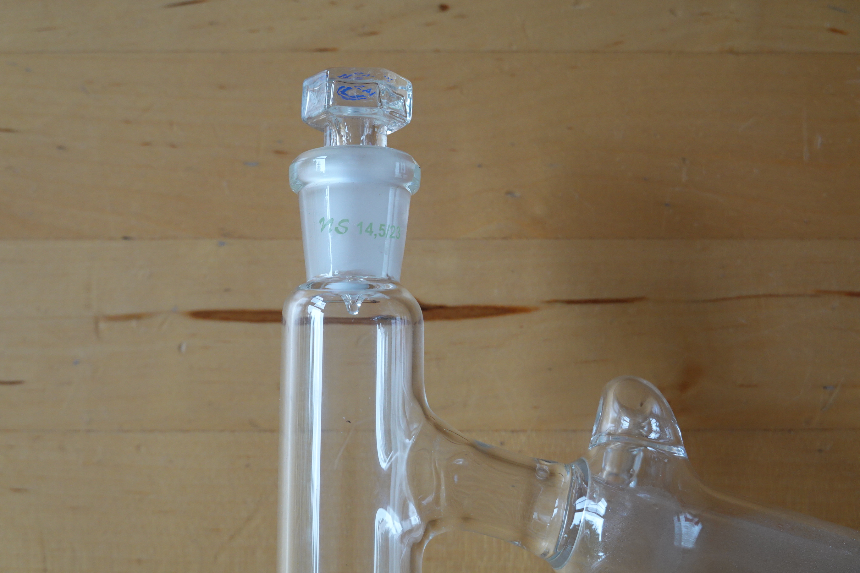

[Q]: How can I remove this stopper from the distiller ?
I have been using this distiller for years. It works great, particularly with the water cooling.
But I cannot use a thermometer in the top with the NS 14.5/23 plug, because I cannot remove the stopper. I am reluctant to use brute force, because
the distiller will probably break.
Does anybody have ideas how to remove it ?

Try heat (submerge in warm water to heat up the outer joint) and the wooden dowel method. Or maybe an acetone soak could help penetrate the joint.
http://www.ilpi.com/glassblowing/frozenglass.html
[Edited on 4-18-2020 by monolithic]

I tried each one of those methods and they all worked for me, but the best method was the hot water method suggested by monolithic. it has unstuck a
couple stoppers for me. Then I started using lithium grease.

You can as well take a spoon and knock the plug around, using some force, but not too much, not to break the stopper. You can heat it before doing so.
Sometimes it works.

Allow time. It is easy to get impatient.
I had a sep funnel recently with a similar issue. I can't remember which solution finally worked but I do remember that leaving it for >24 hours
soaking in something certainly helped.

I had the same issue recently. It felt as if the the stopper and the joint became one. I passed the joint through warm water while applying my Grip
Strength™ to it for like 20 minutes hard enough that it felt it was gonna break. It eventually came off after a while but the stopper was only the
the joint for like five months instead of years in your case. You could try to let solvent through the cracks such as acetone or alcohols like
methanol, ethanol, or isopropanol. Well, good luck and try not to break it when forcing it off .
