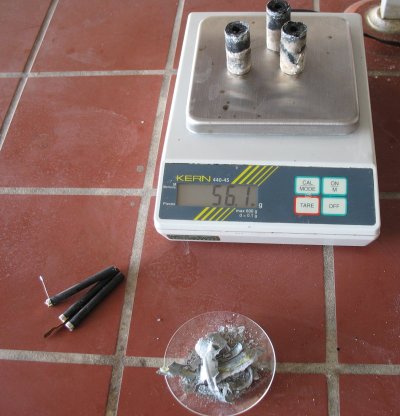

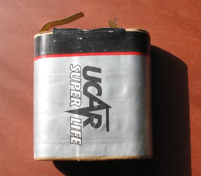

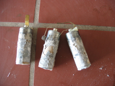

A spent zinc-carbon-battery (3R12) was weighed, opened and disassembled. [2] This on was completely corroded.
The black battery mass was weighed.[3]

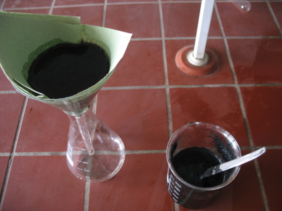

The black mass was washed with water and then mixed into a solution of 22.5 g NaHSO<sub>3</sub> (0.22 moles) and 73 g
NaHSO<sub>4</sub> (0.61 moles) in 600 mL of cold water.[4] When preparing the solution, sulfur dioxide may be evolved. The beaker
containig the mixture was covered and allowed to stand over night. The mixture was filtered the next day.

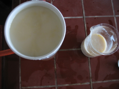

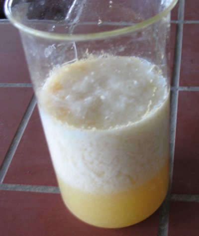

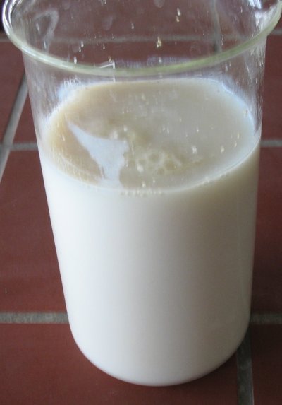

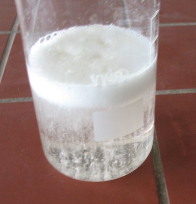

To the clear colorless filtrate there was added 88 g sodium carbonate (0.84 moles) slowly and carefully so that it completely dissolves
(CO<sub>2</sub> is evolved. Caution! There may be sulfur dioxide evolved too in the beginning!). A white to beige precipitate was formed.

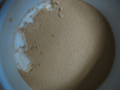

The precipitate is succion filtered through a Buchner funnel. The filter cake turns into a more brownish color as it is slowly oxidzed by air.

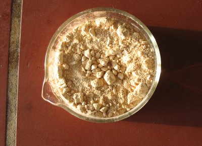

The filter cake was dried on a clay plate and then in a dessicator until constant weight.
Yield: 44.7 g of an ochre powder.

[2] The weight of these batteries varies. Some weigh 102 g, this one only 93,3 g.

But there is a problem, IMHO.. Did you washed the black mass only with water? If yes, I guess there is Zn contaminating your MnCO3.
BTW, I have +/- 2 Kg of tech grade MnO2, but Im gathering many batteries to obtain homemade MnO2 and compare it..
Part of my MnO2:
My MnCO3 (this was made by reacting unknow purity MnSO4 solution with Na2CO3, washing very well the ppt and drying):
