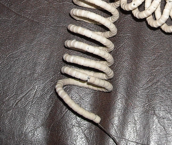

Any of the resistance wires can operate here, the insulation is the trick. Fish spline beads (also as fish spine beads) are sold at numerous outlets. Below is a picture of the 4.3 mm OD beads and the 0.8 mm Alumel wire I used. This is the ideal answer to the need to wrap flexible heat around a metal tube.

DSCN0826.JPG - 217kB
Another method is to adhere ceramic paper with sodium silicate directly onto the chamber being heated. After that, resistance wire can be coiled directly onto the surface. A second layer of paper/silicate holds the heating element in place.

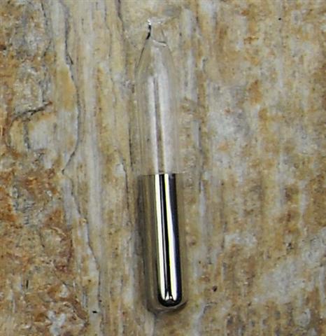

Here's Cs's dirty little secret, though....Cs is actually the same color as the other group 1s, bright silver. Cs forms a multiplicity of oxides. One or more of them cause the golden tint associated with Cs. So, your atmosphere doesn't need to be perfect, just good.

[*] posted on 27-6-2012 at 12:06
Well, to wrap up my progress here I'll post this final picture of my recent Cs ampoules. I can now make them without any traces of oxide. Not surprisingly it a matter of learning a few little tricks, but the most important seemed to be to freeze the Cs before sealing the ampoule.
cs3 (Small).jpg - 79kB

Sublimatus
Posts: 108
Registered: 8-6-2011
[*] posted on 27-6-2012 at 15:31
That's the first sample of silvery caesium I've ever seen. It's beautiful. :o
Do you think it'll tarnish if it were to remelt inside the ampule?
In any case, congratulations.
Zan Divine
Posts: 170
Registered: 3-12-2011
Location: New York
Mood: Wishing all the worst that life has to offer to that SOB Wayne Lapierre
[*] posted on 27-6-2012 at 16:01
Thanks. The metal remains totally shiny when melted. It looks like clean mercury but with a golden tint. It won't change since it's under argon and any adventitious oxygen has already reacted.

Sublimatus
Posts: 108
[*] posted on 27-6-2012 at 16:21
Excellent.
