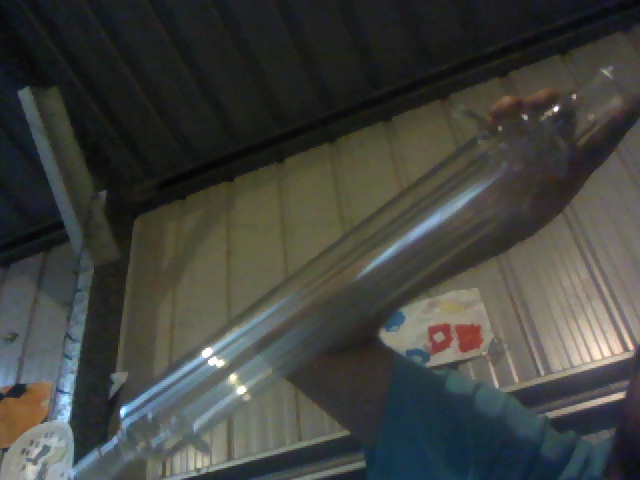

Here is a picture of my davies twin suface condenser will post my twin coil graham condenser soon using it at the moment.
overal lenght 680mm surface area 1400cm2
regards azo
