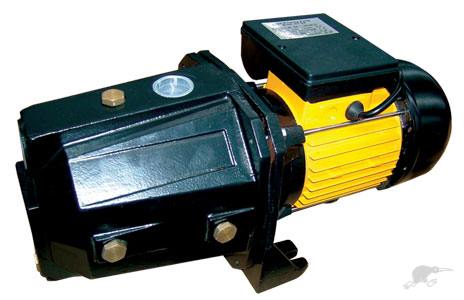

Hey guys, I plan on constructing an aspirator with a water pump I got from a $1 reserve auction for $100, normally sold for $274.
Its a jet waterpump, 460W, 30PSI and able to suck water from 7M down. It pumps 46L/min and has a max head of 35M. Also says its suitable for use in pools etc.
So I'm just wondering if this will work for an aspirator, is it just right? I'm guessing it should provide quite a crazy vacuum right?
Because there is such a lack of any real instructions on this on the internets, I'm kinda fumbling round in the dark here.
Heres the article I'm going off.
designer-drugs.com/pte/12.162.180.114/dcd/chemistry/equipment/aspirator.html
Can somebody please post any useful information on making an aspirator, I've got no idea of what the smaller pipe ratio should be to the large to make the vacuum etc.
Cheers.

I bought a similar pump at a local auction here for $50 earlier this year. It also has a pressure chamber on its top. I bought it partly for irrigation purposes, and partly to add extra delivery pressure to a fire-fighting hose.

[*] posted on 17-8-2009 at 00:58
MM so is it too powerful then? I want as much vacuum as water can offer. Planning on distilling nitric.

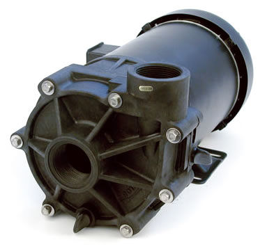

I found this pump a while ago. I was impressed with it's construction. It's made by a company called Shertech.
Shertech_CHMN_series.jpg - 21kB

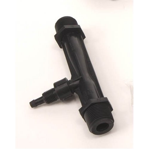

I've wanted to use it to drive this injector by Mazzei. The 1585X
"Crazy vacuum"?-no. Regular water aspirators are limited by vapor pressure. There are higher pressure ejector pumps that run on steam that get down lower than the vapor pressure of their working fluid, but they use very fast exit streams to do it. What you might get is higher gas pumping rates than an ordinary faucet-tap aspirator. If you want even higher suction rates, build two aspirators and gang them in sequence, with a common manifold feeding both nozzles.
The only two parts of an aspirator that aren't off the shelf are the penetration of the water pipe into the air flow and the nozzle. You should be able to build the bulk of the device out of PVC pipe. Drill a hole in an end cap and glue in a pipe section to get your penetration. As for a nozzle, use a brass end cap and drill a hole in the end. You'll need to use a drill press for that, if you don't want to be breaking drill bits. You'll find the whole system easier to assemble if you break the air pipe into two sections with a union. Locate the union in a place were the water nozzle sticks out.

One of these aspirators should definately be able to pump out enough air for vacuum nitric distillation right?
People have been saying the vacuum provided by one of these aspirators should be able to create a 20-30torr vacuum so that the nitric boils below decomp point.

How big is the distillation and how big is the pump?
Go look up the vapor pressure of water at two ordinary operating temperatures: 40° C for room temperature, 5° C for ice water. This is the lower limit of pressure for a regular water aspirator.

I've got a 1L boiling flask, a 500ml boiling flask as a receiver, a condenser with a 20cm long jacket... and the attachments to make it all fit.
If you have a larger aspirator it's going to suck more air than a smaller one correct? Down to the vapour pressure of water I'd presume?
I'm struggling to see what I'd need to build this aspirator, and I can always get my dad to pay for one off the internet, but if I chose to build one I would have to do it with my own money. However, My pump is a 46L/min job with 30 PSI, and I'm quite certain the bought aspirator could not take that much pressure. And the pump might fail too. Without a pressure tank, it is harder to get a higher pressure correct?
Will you have a problem of bumping between 20-30torr? So if you concentrating your nitric will you have to get a magnetic stirrer with your hotplate?
Also... I found this with a google images search for metallic aspirators...
