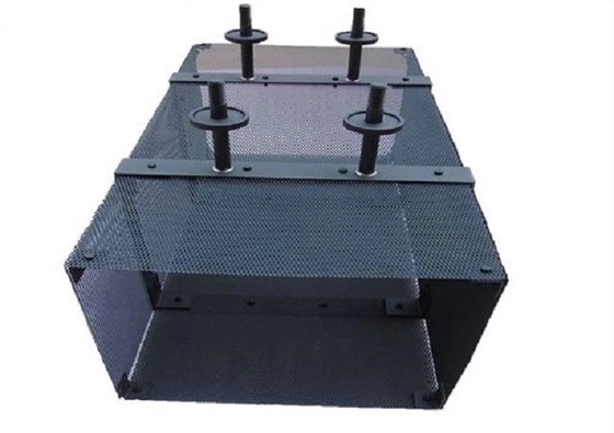

Hello folks,
I think we can buy Titanium Anodes with a Mixed Coating of Ruthenium Oxide and Iridium Oxide from China, Would it be a better way? Or can I use my Titanium plate?
And Shall I use Stainless steel for Cathodes?
pt106732969-mmo_titanium_electrode_and_anodes_ruthenium_iridium_coating_1.jpg - 44kB
pt109357758-mmo_titanium_electrode_and_anodes_ruthenium_iridium_coating_2.jpg - 47kB
[Edited on 2-11-2024 by sarinox]

You should ideally use titanium for the cathode, but since the cathode is subjected to a much lower degree of oxidative stress, stainless steel also works.
MMO anodes are indeed your best option at a reasonable price point.

Hi, and thank you for your reply, and what about power supply?
How many Amps should I pass through the electrolyte? and I know they calculate Amp/surface but that is kind of confusing for me! for example the MMO anodes look like a mesh and I think measuring their surface area would be difficult, no?
Also, there are more questions for example should I keep the Amperage constant? How is it done? the power supply will do it automatically? (please note I did not have a laboratory power supply until now)
I just know from simple physics that V = R.I which means if we give a higher voltage to a system then higher current will pass through it, right? (assuming that R would remain constant)
so, if the electrolyte will have a constant electric resistance (which I think is not true! but let's imagine that.) then I cannot pass higher amperages through it without increasing voltage! Can u explain this issue for me?
