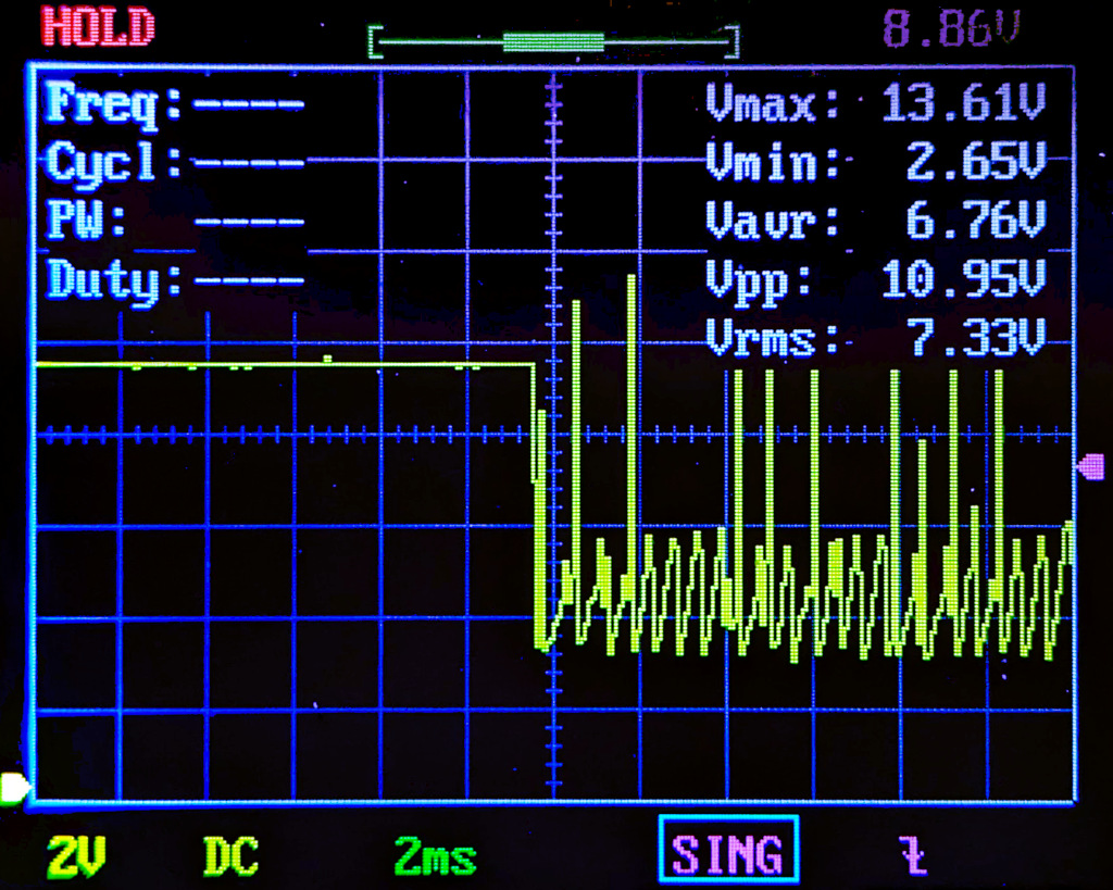

Charge pump works well to trigger relay and safety mechanisms are adequate. But the HV converter is just whalloping this 9V battery. 2-4V most of the
time and ringing to 14V, enough to brown out the microcontroller once it starts charging up the cap. I should have scoped this in the early design
phase, I just assumed the source was sufficient based on the output voltage. Even lithium batteries droop too much. I'll need to use a separate
battery (like Sir_Gawain) or redesign to feed the small circuitry with a boost-buck converter or some nonsense.

![brownout.jpg - 379kB](https://www.sciencemadness.org/whisper/files.php?pid=694328&aid=102396)
