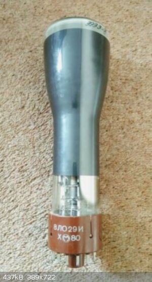

Here's the CRT (oscilloscope type) in question:
![CRT03.png - 437kB](https://www.sciencemadness.org/whisper/files.php?pid=671880&aid=92735)

There is usually an inlet port on the bottom... a sealed glass tube... You have to drill it out, then attach another glass tube before it can be
sucked and sealed. Yours may he different. They're usually a borosilicate type glass. But a jewelers torch will make quick work of it.
When drilling it out it is helpful to sand it flat first
