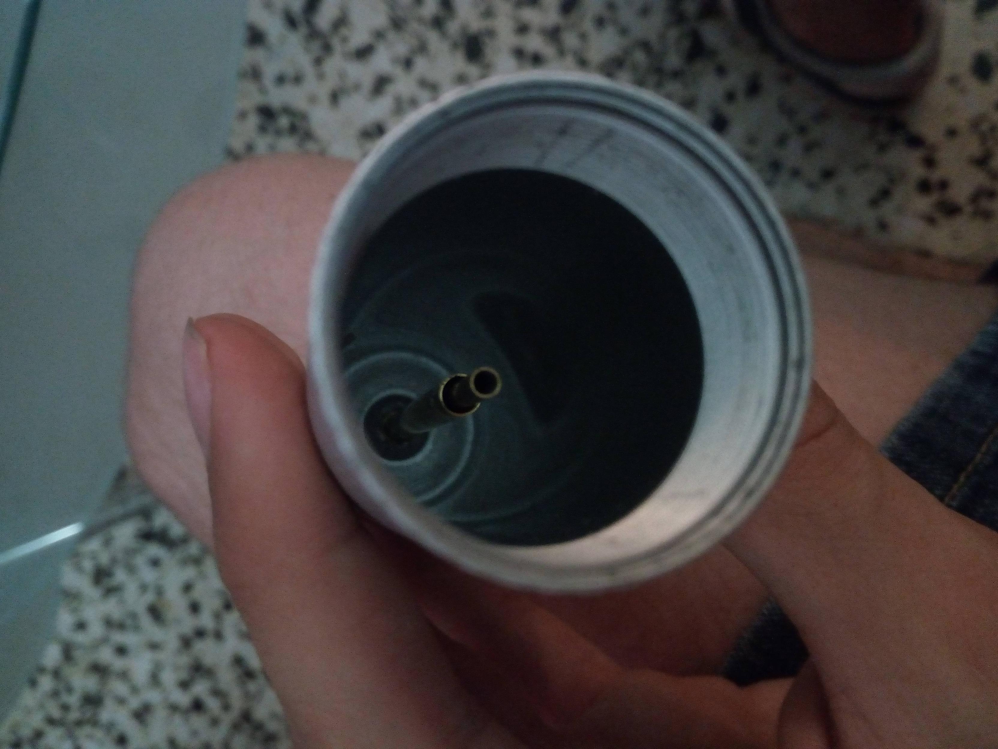

So, the tank has a screw, thats pretty nice. No need to do any washer business, just unscrew it, maybe add some teflon if it starts leaking.
however, I found something that I dont know why its there, foam, and a spring.
The spring, may be to keep foam from... expanding for some reason? I have no idea. I guess removing it will be no problem, but if any of you know why it could be there there so I can be sure? :)
Also, there is a tube inside the tank, which purpose I think its to stop it from filling more than 2-3cm, I may want to shorten that.

First try with coffee was a mess, I managed to get a couple drops of oil, however, the oil has a unpleasant burnt scent to it. I also got inpatient, and opened the whole thing, not only the valve (wtf was I thinking?) so, as expected, the liquid butane jumped and I got my hand full of coffee oil. My hand smells pretty nice now. Im tempted to taste test, is there anything wrong with that? I cleaned the container, butane and sulfur derivatives should have all been evaporated (right?), and coffee is edible.

I would have to change my vessel to work better with this, as currently the extraction productos are left behind inside the vessel (gasseous butane comes out, not liquid) I just have to cut a small pipe inside the thing tho.
