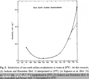

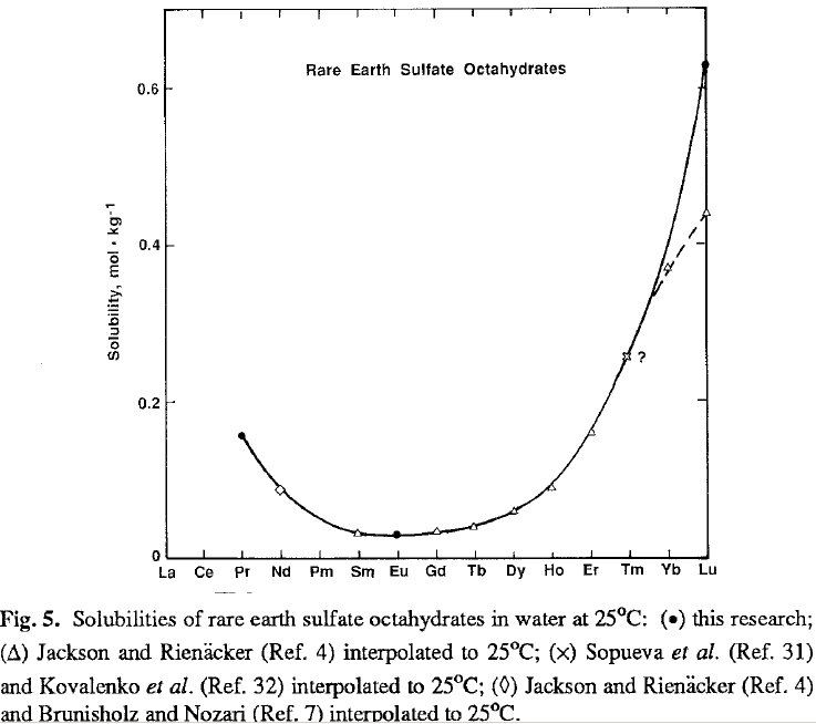

I'm actually downloading some references from the library for the first time. Frankly, this is embarrassing. I don't have europium (yet) but I will be making some EuSO4 shortly after I have some.
blogfast25, potassium sulfate may not be the ideal reagent for precipitating out the ferric ions. The sulfates of very light REEs appear to be relatively soluble, per the data I linked earlier:
1.png - 32kB
The oxalate method may be preferable, as all lanthanide oxalates are ridiculously insoluble.
blogfast25 - 14-10-2014 at 10:44
B&F:
The double sulphates method has been prescribed many times for La to Pr. The REE sulphate solubilities may not reflect the double sulphate solubilities very well.
I don't like the oxalates: the only thing you can do with them is to calcine to oxide. And if it is iron (?) iron oxalates aren't that soluble either, unless you complex to trisoxalato ferrate (III).
