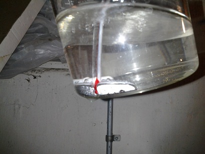

<table><tr><td> This is done by forcing air through the mercury. The
simplest apparatus is shown in Diagram I. Put a layer of 10–20% nitric acid over the dirty mercury and pull air through by an aspirator or
vacuum line. The air will oxidize the base metal such as zinc, lead, etc., while stirring the mercury. The oxides will float to the top of the
mercury and dissolve in the acid solution. The nitric acid will also oxidize any base metal at the mercury surface. The bubble rate should be fast
enough to stir the mercury without splashing it into the side arm. The glass wool plug is present to protect the aspirator or vacuum line from acid
droplets. Usually 8 hours of oxidation at the rate of two to three air bubbles per second will clean about 10 pounds of mercury.
